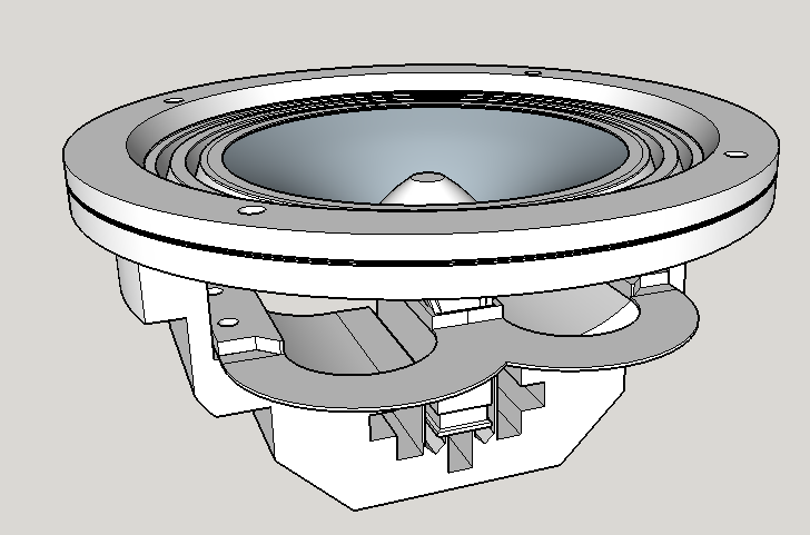

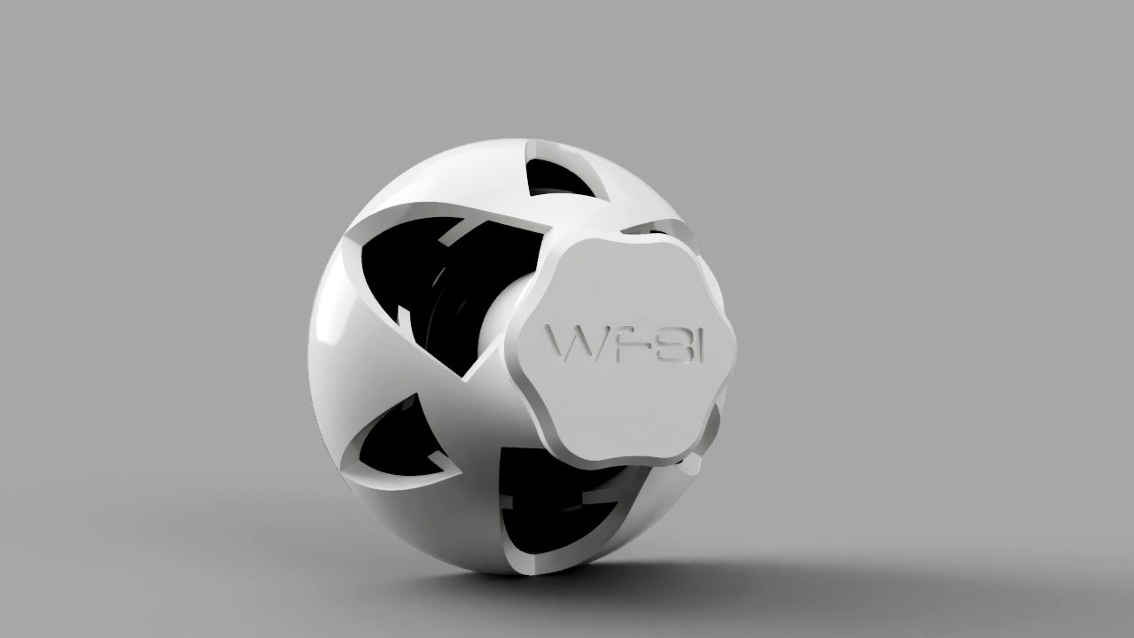

Thanks WrineX. Im on a long journey to achieving industry performance levels, and just don't feel there is much to go on when it comes to learn this stuff, and seeing the effects some parts have. Hence making videos detailing what I find and what needs work.
Next video should be diving into WF81's surround and spider, and using some CAE to aid the design of these components. I have a new born baby here though too, so not sure on the ETA. Here is a render of the revised driver though. Thanks for your interest :)
Paul

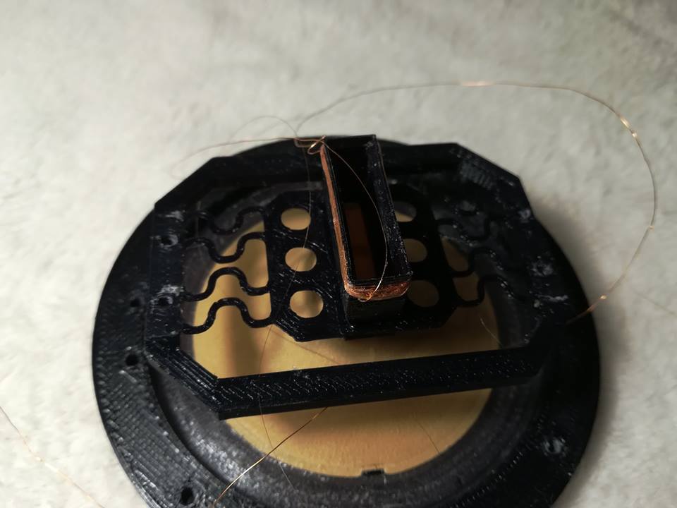

I was watching your videos, and I think you could probably increase the performance of the speaker by reducing the surface area of your spider and basket. Rear speaker reflections can cause a lot of speaker distortion. Not to mention that your current spider looks like it might be causing too much drag on the cone.
Here is the spider from the DIY field coil speaker for inspiration. Good luck and keep up the good work. I am excited for the next video.

Hey man. Thanks for the reply and I have seen the Ryu project for a long time. Even investigated the field coil as a option for a motor but the size of my drivers don't really match due to there size and the motor width I am using.
As for the spider, yes it would lower mass for sure. I have had flat spring based spiders for this reason before but again, at the size of the drivers I am making, they have not resulted in suitable performance. The issues where with TPU it is too soft, and with more rigid materials I would get fatigue fractures. I may have to dabble more at a later date!
I have added pictures of just a couple of the many flat designs I have tried in the past for you. Any other ideas, please feel free to mention them. With 3D printing, we have potential designs and ideas other methods may not have the luxury off, and thanks for watching. I am trying to share some data and experiences as things develop :)
