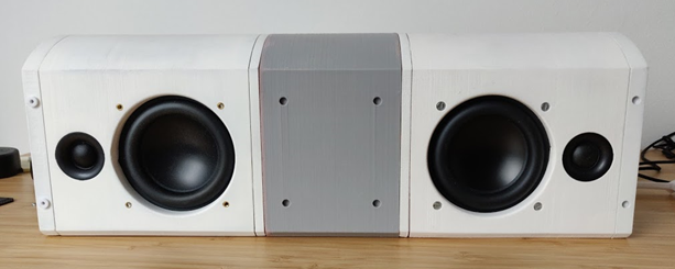

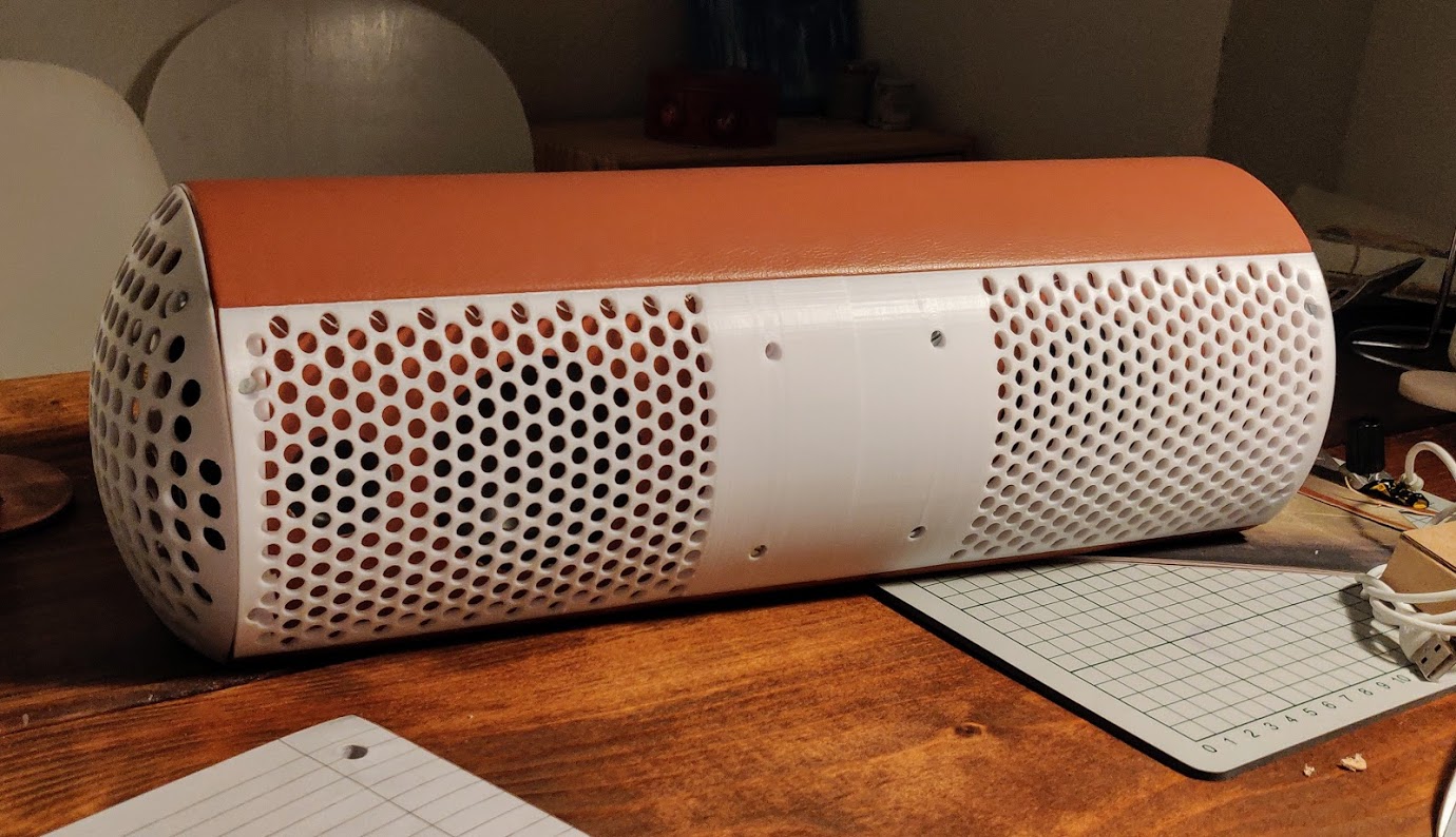

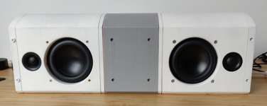

I've too printed some of my own speakers. The latest was the most ambitious.
This is how it looked raw before adding any finish.
You can see the different modules and how they are glued together. It's incredibly sturdy, I could probably stand on it without it breaking, but it's a PITA to glue all the sections together.
Which after adding some fake leather looked like this.
Everything is powered by a 3s lithium batteries in a sure balancing and charging board. The amp is a sure DSP amp which handles the crossovers and EQ. Sound quality wise it's pretty okay. The bass is really impressive for the size, but output is limited because of prioritizing extension over sensitivity.
