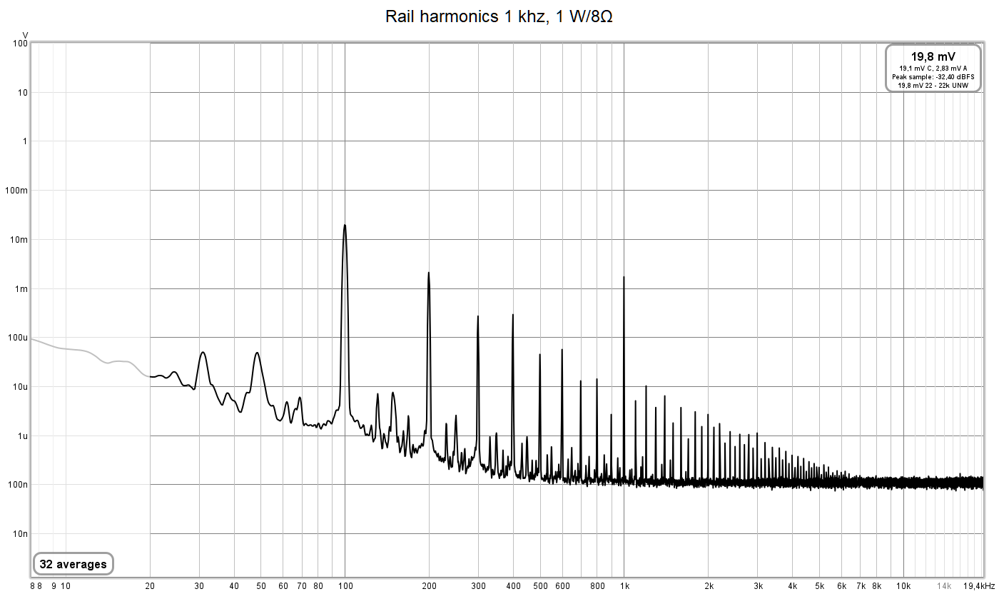

Here is thought experiment, example if amplifier channels affect each other or not and how it would perhaps affect imaging. Assume ideal speakers.
Lets feed mono signal to both channels, say pink noise, perfect phantom center image is perceived by the listener.
Now lets mix in timpani hit to left channel, or dinosaur stomp or something, gun shot.
Case 1, amplifier channels affect each other, psu sag or something:
On the transient both channels get amplitude modulation, temporary dip in output. Assuming full bandwidth amplitude dip for both channels, nothing happens to (phantom) image except perhaps some dynamics was lost in the process and depth perception suffered. Both channels sag some so phantom center stays in place, but has some amplitude modulation to it.
Case 2, amplifier channels do not affect each other, separate psu or something:
Transient on the left makes the left channel dip in amplitude but the right plays normal. Now the phantom center would shift to right as right speaker plays louder in comparison, momentarily. How about dynamics? The transient was still somewhat compressed like before but now instead of that much amplitude modulation on the phantom image we got some shift to it as well.
I don't know if this is something that relates to real systems or how much hearing system can make out of it, its just fun thought experiment how things could perhaps go with musical material. Phantom images would not be stable if either side speaker output has different linear or non-linear distortion to it, or some other things going on that makes the sides sound different all the time or momentarily depending on the source material, phantom images suffer I think.
edit. yeah if both sides of stereo amplifier have enough capacity not to change the operation on transients, and the speakers are also capable of reproducing them, then the image should be stable and dynamics should be there.
No need for thought experiments while actual values can be measured. 🙂
Effect of one channel load on the CRC PS (33mF – 0.33Ω – 33mF) output at 1W/8Ω at 1 kHz. There is about 20 mV ripple @ 100 Hz + harmonics. Load produces some 2 mV rms @ 1 kHz rails modulation. It is true that drum kicks or other LF signals would produce more rails modulation, as CRC PS impedance rises toward low frequency and I measured more there, but soundstage is not at the LF region.
Effect of that voltage modulation on the second channel is close to nothing. Even if amplifier would have zero PSRR and all rails modulation would be passed to second channel output, that would produce signal more than 60 dB below the first channel. As amplifiers usually have 30 – 100 dB PSRR, signal in the other channel will be 90 – 160 dB below the first one. Contrary to the claims of various superhumans present in abundance at this forum, nobody can hear that.
Case 2. seems to be counter the usual perception that amplifier with 2 separate power supplies ‘sounds better’ as difference between channels would be larger than in case 1.
Though, ‘sounds better’ was always general assessment with no specific mention of soundstage. I believe that ‘better sound’ with the two PS, so called dual-mono, is simply from improved capacity or better transient performance under load. There was an interesting observation about practical experiment with increasing PS capacitance up to extreme levels, mentioned here (post #21):

Yeah, thought experiments are fun but do not include how the stuff is perceived 🙂 It might be so that even if the thought experiment appears to have the Case 2 worse with the shifting phantom center perhaps hearing system perceives amplitude modulation on stable phantom image (case 1) worse than slight momentary shift in phantom image. Not sure how much localization relates to phantom sources but hearing system seems to set localization based on transients and hold it until better cues come about, for this reason the slight shift in pink noise location might get unnoticed as brain already figured out its on the center and holds the perception steady🙂 Anyway, very interesting stuff and I'm very glad you picked it up as there is now some material to chew on.Case 2. seems to be counter the usual perception that amplifier with 2 separate power supplies ‘sounds better’ as difference between channels would be larger than in case 1.

Amplifier at the clipping level as an example of one channel affecting other and ‘losing small bits of information’?
What really happens, outside the extreme cases, was measured and presented.
There is no crosstalk through power supply to speak of, except in case of circuits with zero PSRR. Any good designer would use adequate PS there, better than simple CRC.
