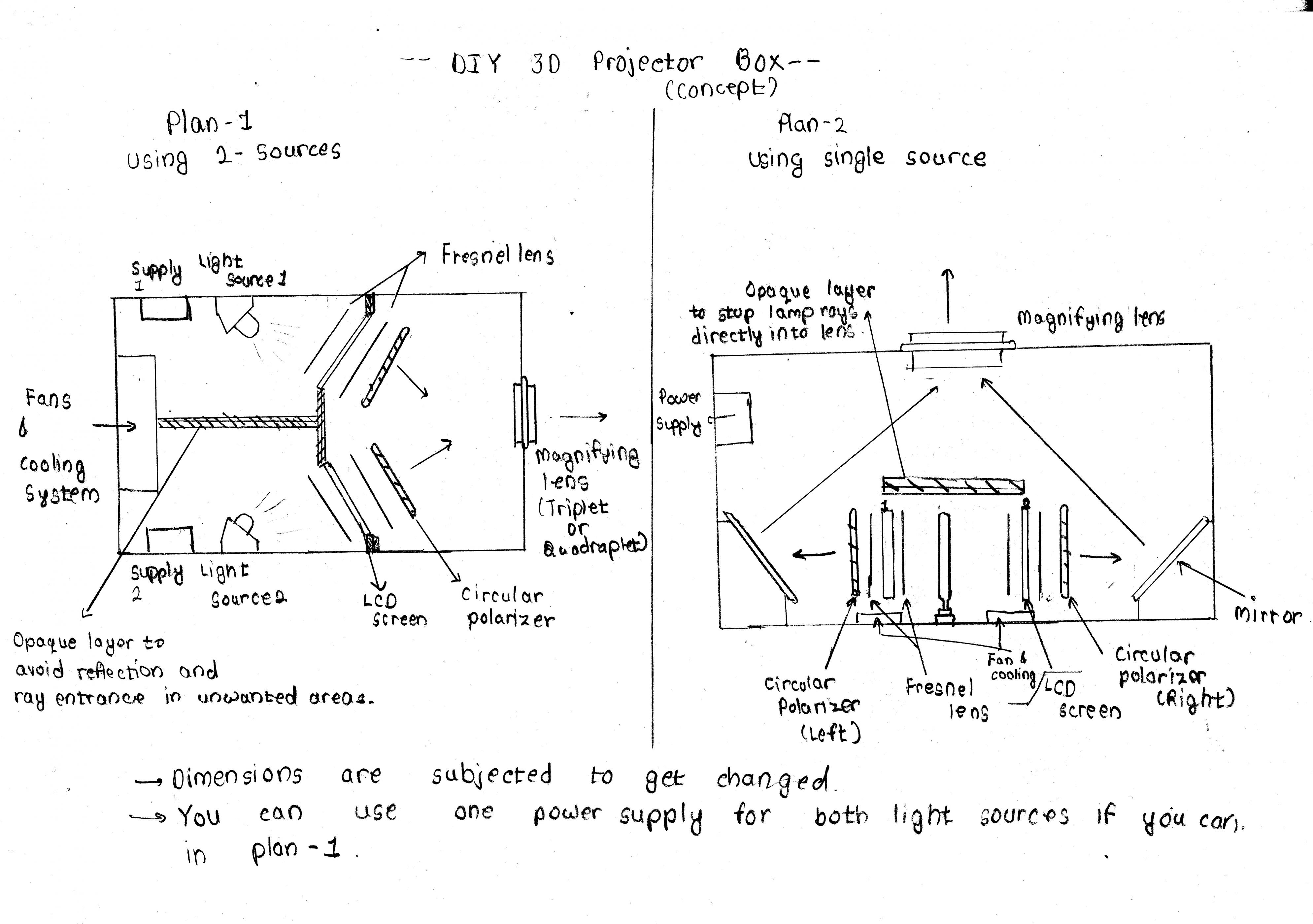

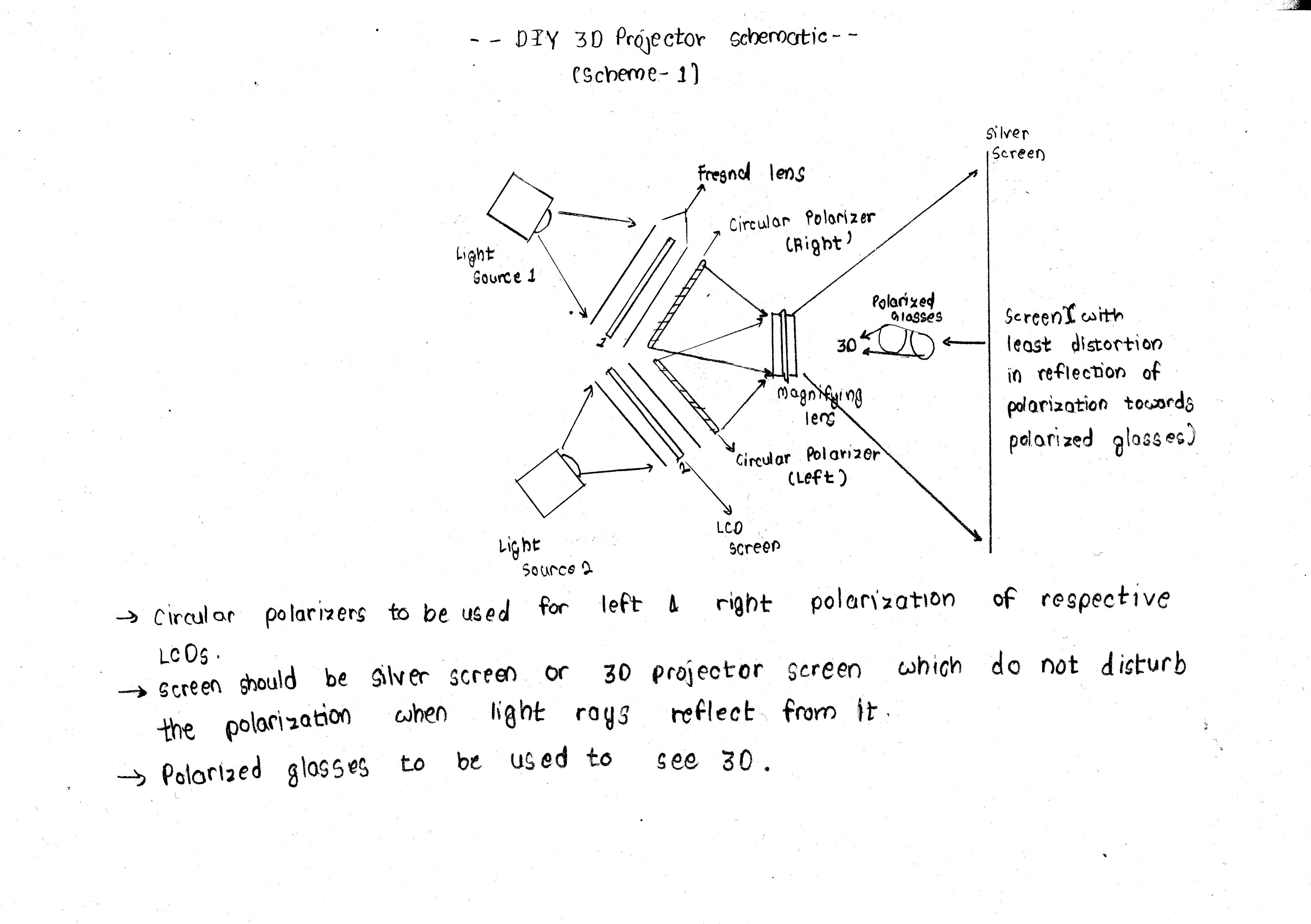

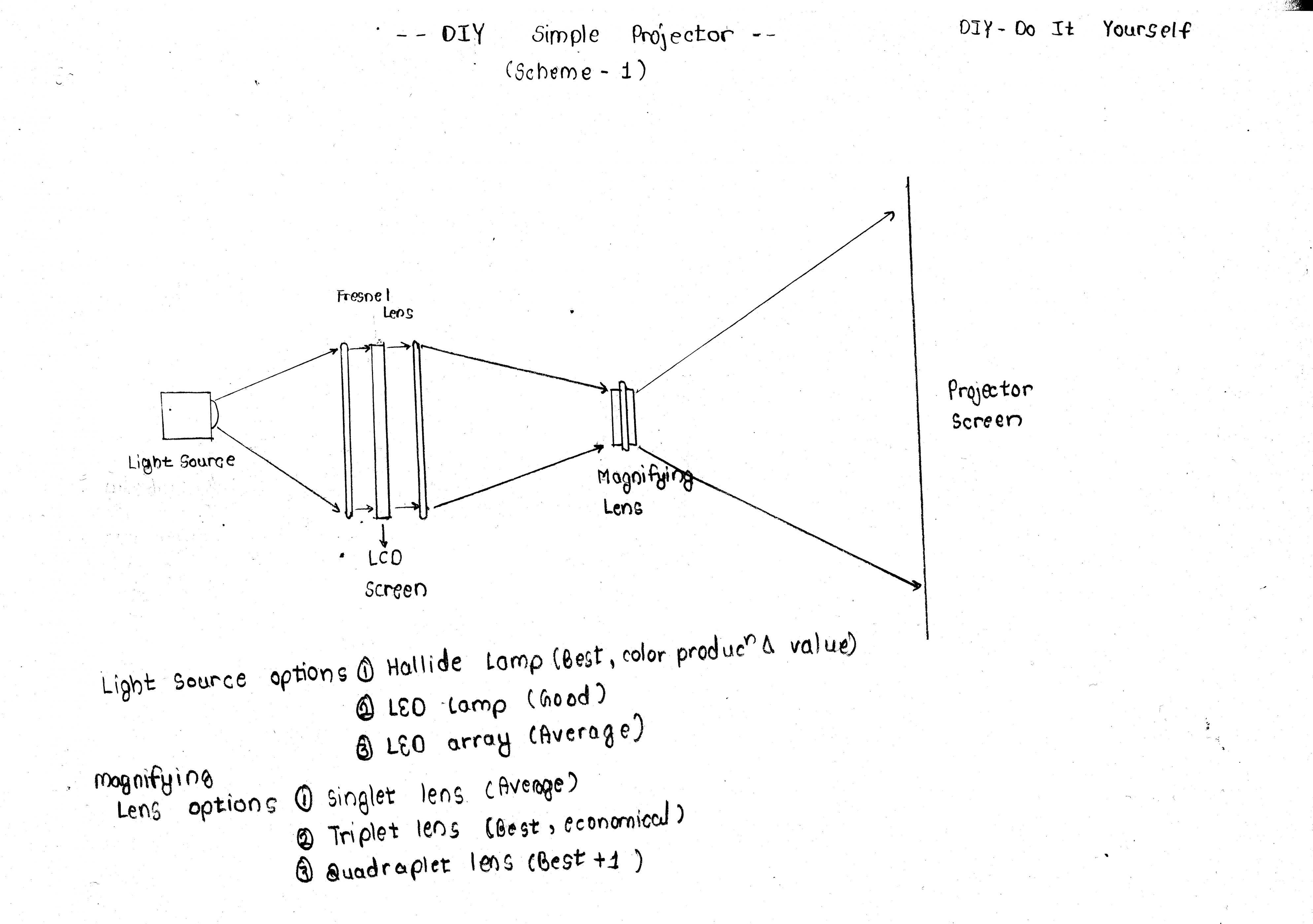

3D DIY Projector. My Concept and Scheme.
These are the schematics for building 3D projector. One with one light source and other scheme is with two light source.
Its the concept.
Please suggest to make it better.
And also condensors are to be used after light source which are not mentioned in the schematics.
