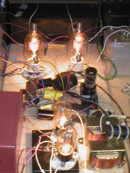

A quick prototype
I decided to modify a previous prototype board to test a 3C24 in A2 mode. I designed an input amp and dynamic driver using a 6FQ7 with a variable bias adjustment for the 3C24 idle current. I also added a DC filament supply for the 3C24.
With a 3.5K load I can manage about 4 watts output with no feedback. It suffers from dynamic compression after 3 watts but reasonably clean, has an input sensitivity of 800mv RMS for 1-watt output, THD at 1-watt is a bit under 1%. Signal-to-noise ratio is ~80dB referenced to 1-watt output.
The down side is I need to push the cathode current up to 90ma with a plate voltage of +330 volts and a grid voltage around +27 volts. This certainly is pushing the 3C24 beyond it's usual ratings, but much below that and output power suffers.
Regards, KM

Re: A quick prototype
What are you using to lose the heat ? You will need to heatsink those pins if you want to keep your 3C24 in working condition . Go up a valve , get your hands on some HK54 if you want to go a step further 😉

Re: Re: A quick prototype
Agreed.... need to get proper heat-sinks for these, just using some heavy gauge solid copper wound around each lead. I'm pushing them hard but you need to get enough positive grid voltage to keep the dynamic driver from dropping off at larger voltage swings. Based on measured voltages in the valve world link, the current has to be much higher (than 75ma) for +30 on the grid. I have 4 of the 3C24 tubes and they all sink more current at the voltages shown.
Still, I think with a bit more work I might get it a bit cleaner at less power dissipation. Could be that some form of feedback might be required to get it clean enough. It doesn't sound bad, but it could be better.

schematic for 3C24 SE amp
I've done a fair amount of testing with the 3C24 and a dynamic follower circuit (different from Valve World's). I opted for no feedback and have found a pretty narrow operating point for the 3C24 in A2 mode. The voltages listed on the VW schematic shows +30 volts on the grid and 290 volts on the plate. It's pretty ideal for getting 4-watts of power. However, two main differences between findings... first, a 3.5K load was pretty spot on for efficiency. Dropping to 2.5K load resulted is power loss and higher distortion. Second, idle current is quite a bit higher than noted as 75ma. To get +30 on the grid, plate current is closer to 85ma and consistent with four different tubes.
Decreasing the idle current reduces the grid voltage and available signal swing to the dynamic follower. You can't drive the grid to 0-volts as current flow decreases before this and the dynamic follower goes into cut-off. Driving positive has it's limit as well so this circuit topology limits your operating points. Overall performance was decent but not stellar. THD is about 1% at 1-watt and increases close to linear with power, reaching about 3.5% at 4-watts output. Bandwidth was no issue with good iron and within 1dB at 50KHz. There is noticeable dynamic compression starting in around 3-watts and increasing to clipping, which is about 4-watts. Swapping enough tubes around, average gain results in 1-watt output with 775mv input. A simple DC filament supply on the 3C24 resulted in signal-to noise better than 80dB referenced to 1-watt.
Now the burning question... should I build a pair for actual use... it is a pretty tube. Overall performance numbers are akin to a 2A3, albeit with more distortion and over twice the power to lite it up. Is anyone currently listening to an amp with 3C24 outputs?

Re: Re: Re: A quick prototype
The easiset way of implementing feedback is to put the output transformer secondary in the cathode circuit . I found with bass reflex speakers the bass was very loose and I had to use cathode feedback on the 3C24 and local feedback from the 3C24 plate to the driver

Hi 316A,
I implemented a local feedback arrangement a couple nights ago from the 3C24 plate to the cathode of the input amp... it helped clean things up a bit and THD was cut down by a reasonable amount but so was gain by ~6dB. I also thought about using the secondary for cathode feedback but opted instead to fine tune the initial non-feedback design.
The schematic posted has the latest changes and is pretty optimal. Trying to determine an optimal idle current for the 3C24 was of little value, but instead setting the grid voltage to +28.5 volts yields the best linearity and symmetry of the output stage. This results in an idle current ~82ma which is 10% over the published specifications, but this is where the tube performs its best. At 24 watts, plate dissipation is just within the 25-watt rating.

Re: schematic for 3C24 SE amp
When the 20k pot that sets the bias for the second tube fails, it will likely fail with the wiper open (common failure mode for pots). This will leave the second tube without any DC path to ground on the grid, thus, I would imagine that tube being quite unhappy under these circumstances. I think it would be worthwhile to set up the bias circuit to fail safely. This can be done by connecting the wiper of the pot to one of the ends of the pot (the end that will cause the lowest bias current in the tube should the pot fail). Use the pot as a variable resistor rather than a potentiometer/variostat.

Tom,
Good point.... pots do fail. However, I would be inclined to put a higher value resistor from the wiper pin to ground. This would provide a near zero bias in case of pot failure and idle the output section down low as a result. If it does fail, I'd prefer the output stage go low on current so hopefully someone notices ;-)
I've since changed the schematic a bit to provide some regulation to the bias voltage to minimize drift from AC line voltage fluctuations, so I added this suggestion as well. I've also swapped out the OPT for an Edcor unit... my Dad want's to build these, so working on a version using Edcor Power and OPT and a Hammond choke. Here's the updated schematic.
