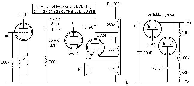

Was checking out Valve World last night and came across this amp...
Just curious as to what you guys think of this circuit.

Built a similar amp last year . Used 3A/108A input stage and 6AH4 driver . LCL DC filaments all round (only ac for the 6AH4) , feedback implemeted anode-to-anode between input and output valve , also the output transformer secondary was in the cathode circuit of the 3C24 . It sounded pretty good but never made it past breadboard stage , the 3C24 is an impressive looking valve running full cherry 🙂 One point to note is that A2 amps sound very bright and can sound unusual on bass reflex speakers . If attempting a similar amp , the grid and plate dissipaters need to be used
cheers
316a

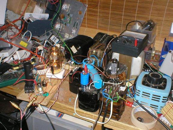

Hello 316a , how do these DHT die ? or when are they dead ? filament failure or something else ? i have some HK54 and VT127a left . They're not new , they light on but i dunno about the vacuum . Should a sherry red heating of the plate clean them new ? :xeye: cheers Pierre
The weak points of all those valves are the seals . If the seals get too hot then air gets in and it's game over for the valve . I have over a dozen VT127A and there are a few really gassy ones so these could probably do with a good baking either in the oven or by lighting the filament . Incidentally it's a nasty one to light up and will need DC , you will need some huge chokes for the filament supply , regulators , resistors etc just drop too many volts . HK54 are a handsome valve , I've some of these but never used one , the same will apply , bring them up slowly on a variac and run the fils for a few hours . Better still run your HK54 and VT127 from an external filament supply and run on a valve tester using the filament as the cathode connection . From memory the VT127 should have gm of around 1.8mA/V at 0V / 400V . See picture for a messy breadboard using VT127 , the chokes at the back are the LCL filament supply
cheers
316a

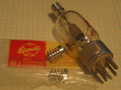

I use HR-2 heat dissipating connector on 3C24s. The HR-2 are made
for .0625" pins which is the size on the 3C24 that I have. HR-6 have a
bigger hole for 4-65A and such. Maybe some 3C24s have the bigger posts?
Anyway make sure you get the right size dissipators for your posts.
You need to run the plate red to activate the getter. This is a required
operating condition to keep the tube healthy inside. It takes about 18W
to get to the right colour on a 3C24.
The 3C24 has about 9K ohms internal resistance. There are 2 approaches
I've seen to deal with it. One is to use a 10-15K OPT and live with low
damping factor. Another is to use feedback. Some have feedback and low
DF. I personally like 316a's use of local plate feedback and cathode
feedback to lower the effective Ri.
I have not run in constant A2 (mine might be called "occasional" A2
where the first 20% of power or more is in A1) and I haven't noticed
any characteristic sound.
Michael

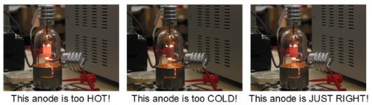

I'm not certain about the the plate acting as a getter. The 3C24 is a close relative to the HK54. It uses a cylindrical tantalum plate and a vertical braced bar tantalum grid with a thoriated-tungsten filament. The design features result in no getter due to a much higher vacuum, no insulators of any kind (except the glass) and the tantalum parts don't out-gas. With thoriated-tungsten tubes, the thorium helps promote good health of the cathode and must be run at the right temperature (voltage), unless of course you stumbled onto some information I've not.
I've got several 3C24s, but I envy you having the Eimac metal base ones. Here's a pic with 6.3V on the filament and about 14 watts of dissipation.
Regards, KM
