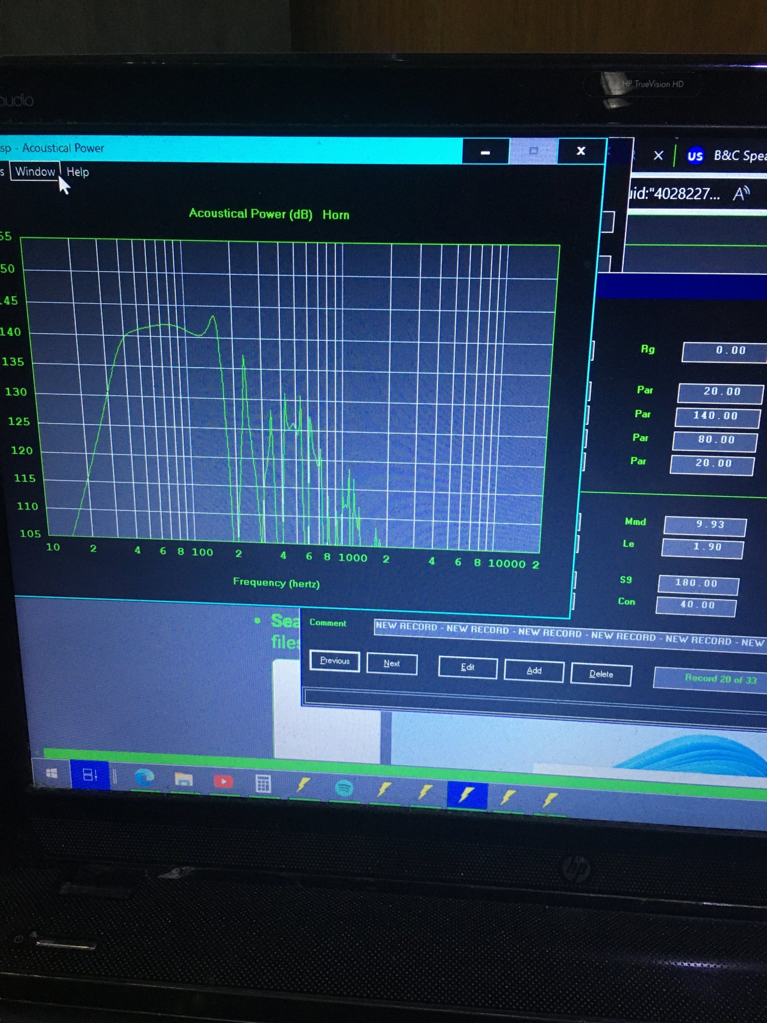

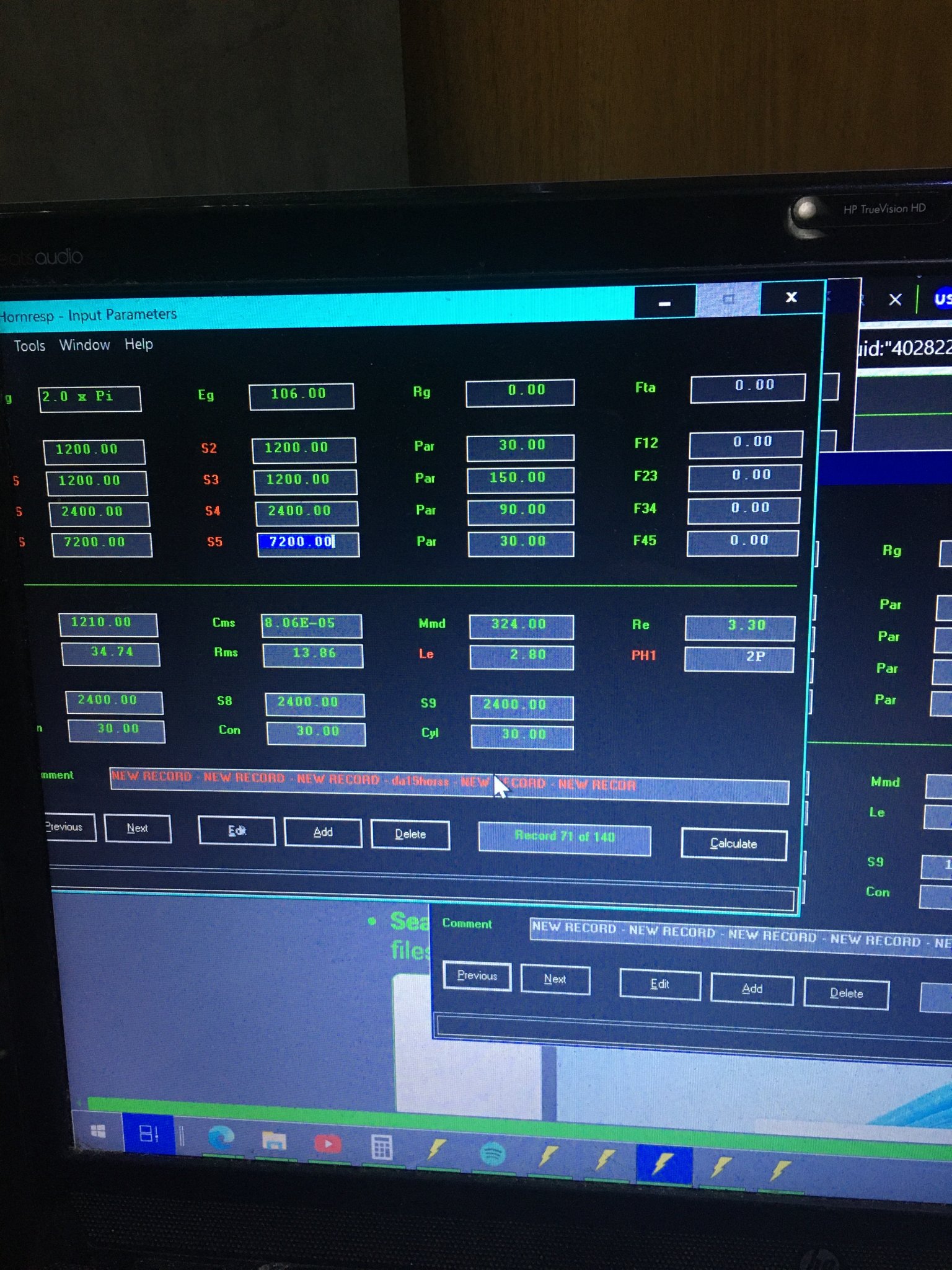

Booger weldz Member Joined 2019 2022-05-17 4:41 am #21 2022-05-17 4:41 am #21 Remove L45 or leave it as a bolt on. But look at: 1720 2580 3440 4300 5160 6…. 860x2,4,8,16,32,64,128… all -990dB.. Attachments image.jpg 516.7 KB · Views: 75 image.jpg 543.1 KB · Views: 72
