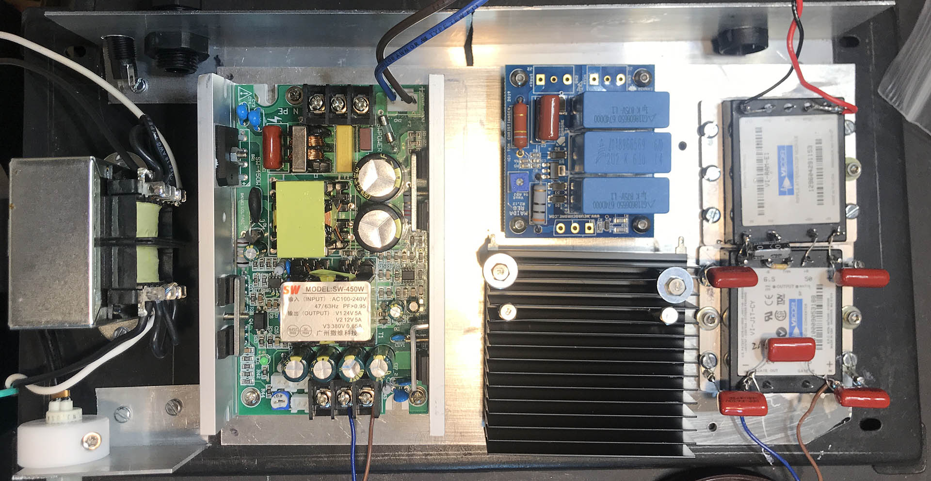

I made some more progress. See pic. It's not all hooked up yet, but I have tested some components. It's getting slightly bonkers just for a preamp supply, but that's part of the fun. 😀
I had a 24V dc/dc converter and ripple attenuator laying around that was collecting dust, so I decided to employ that for the heaters. We'll see how it works! I did a quick test of it, and it looks like about 2mV of ripple at 200KHz or so. Can pick them up real cheap on ebay.
http://www.vicorpower.com/documents/datasheets/ds_vi-ram.pdf
Also, I got a 21st Century Maida regulator from Neurochrome for the HV
SOME QUESTIONS:
It's been determined that the 380V (-) is not connected to earth, but it is connected to the negative of the diode bridge of the PSU. Hence, I'm using an isolation transformer.
I'm thinking because of the switching modules, I should separate the earth and signal ground via a resistor/cap/diode decoupler as has been suggested for years on many pages here.
Where do I connect the (-) from the 380V PSU to this signal ground? See attached pdf sketch for how I was thinking to do it. Comments?
SOME QUESTIONS:
