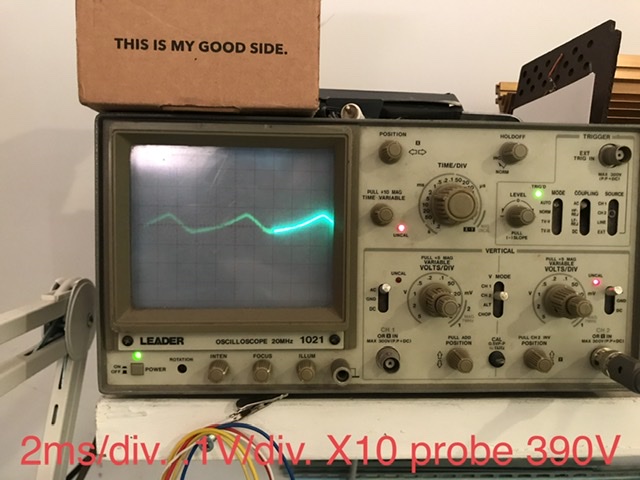

I measured the HV at 392V. See the attached pic, showing the AC component at 120 Hz. Ripple was much smaller than I expected at only around 1V or so.

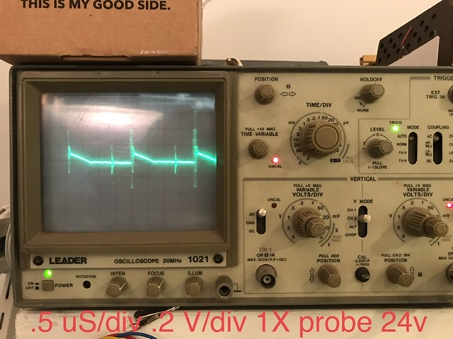

On the 24V side, the AC component was a little spikier looking, but frequency was at 50kHz. Ripple was about 1V p to p.
Are you sure? That would suggest that the high voltage part is not a SMPS but just a transformer and rectifier. And that transformer looks way small for 200W at 60Hz. I expect if this is true, the output voltage will sag greatly at the rated power.
You're testing at less than 10% of rated power so I would expect low ripple. See what happens at 200W.
At what ouput current?

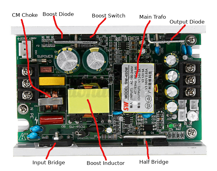

The label claims it has a power factor of 0.95 so it is extremely likely that it uses active power factor correction. That generally uses a boost convertor on the primary side to produce a 400V DC bus. You will get a bridge rectifier, a boost mosfet and a boost diode. Common mode choke and boost inductor. The rest looks like it is a half bridge with the main transformer and possibly resonant mode. Sorry... the 400/380V is not isolated.

I'm definitely sure that the HV is at 120Hz. Just to make sure I had the range correctly set, I put the scope directly on my isolation transformer first, to make sure I had a reliable 60Hz reference.

Also tested the 24V side again. This time I decreased the load (30R vs 15R before), since my resistors didn't have enough sink for a longer test
Results were similar to before: 50kHz switching, around .4 V p-p ripple, but was a little less spikey- a bit cleaner. Also ran for 40m.

Very interesting. Appears to be well regulated. No sag with the increased load. If it can deliver the advertised 0.65A at 380V continuously, it would make a dandy supply for a good size power amp.
I am not a SMPS expert, so I'm baffled by the 120Hz ripple. I would expect it to be in the many kHz range, not line frequency.
Thanks for posting the results and good luck with the testing.
Someone mentioned previously that is probably because it utilizes a pfc module at the input.
I just googled "power factor correction output ripple" and this article popped up:
Output Line Ripple on Power Factor Corrected AC-DC Power Supply Outputs (Part 1) | Vicor PowerBlog
It says:
"As a result of that power factor correction, because we want to draw current proportional to the rectifier input voltage, the output DC bus voltage has ripple at twice the line frequency. Doubling of the line frequency occurs because of the input rectifier.
I took only one Power E course back in the day, so I don't fully understand it and can't explain it. Maybe someone can chime in, or maybe someone explained it elsewhere on this site- I'll look around.
