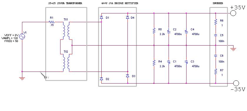

You could/should add fuse on primary side, replace that resistor with NTC and I think that you don't need 1ohm resistors on output

I couldn't find a fuse in pspice but I do have a
4 amp Slow blow fuse on the primary.
what resistor and what is a NTC?replace that resistor with NTC
http://en.wikipedia.org/wiki/Thermistorwhat is a NTC?
And I was talking about R1, this is probably fuse, but do use fast one... What is your trafo power rating?
oh I see,
R1 is needed in the design to simulate the traffo's internal resistance(schematic is from a PSPICE simulation).
I am in looking into NTC's right now.
I'm using a Avel Y236652 250VA 25V+25V Toroid.
This is an advice I would strongly follow!
GregoryD said:C1 and C3 need to be reversed in polarity.
