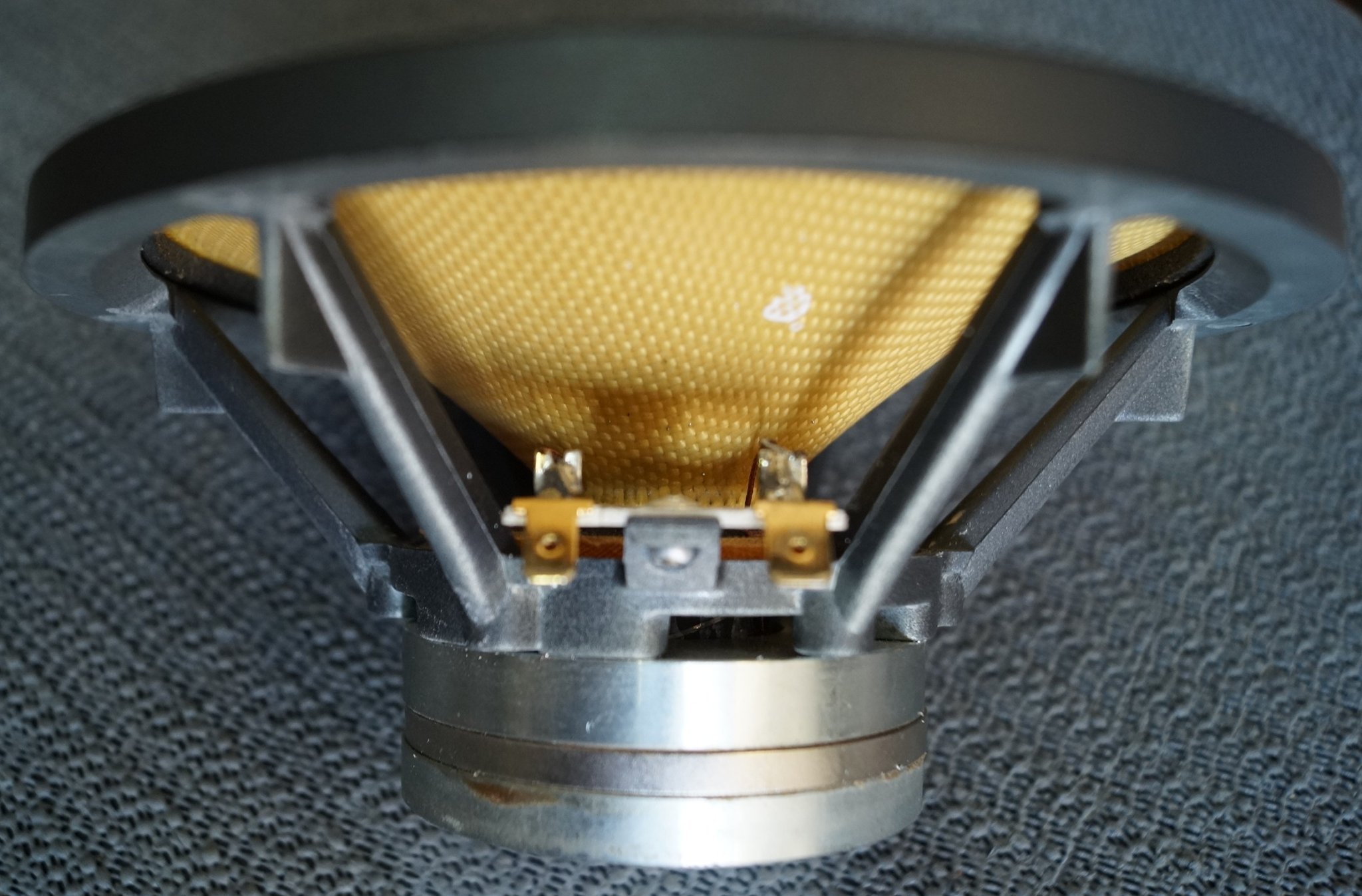

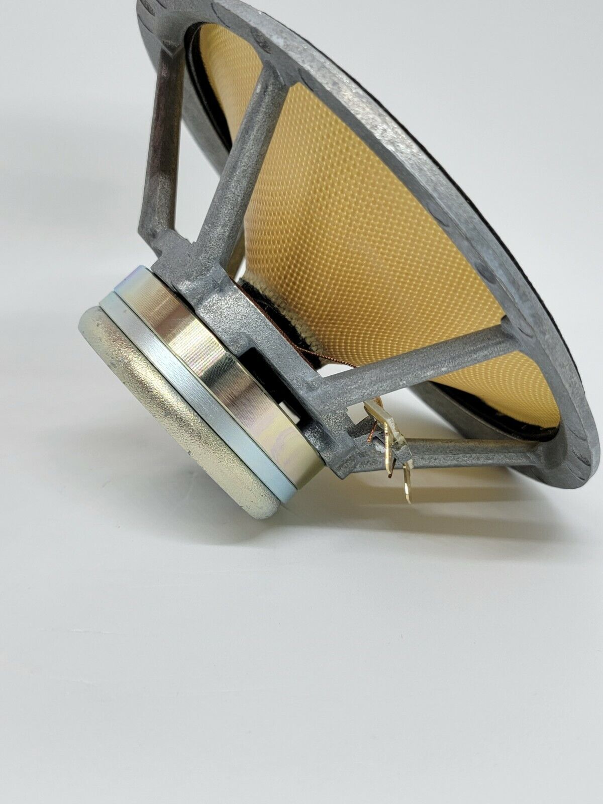

350hz to 3.5khz open baffle......what driver would you choose?
I did 360° polars of a dozen or so candidates for a nude dipole mid. The 6nd430 was not one of them, and I'd guess it's not that good because of the large magnet system. The BMS was the most consistent dipole mid I tested.
Honestly not a huge difference between the 18S and BMS in that regard.
If you want open basket, well behaved polars, midrange, and can live with the limited xmax which is usually the killer for OB.
These could be a consideration for testing.
Medium/high Q, copper sleeved, low distortion, well behaved, high sensitivity, open basket, but limited Xmax and needs a little notch 3,5-4k.
Other good candidates was already mentioned like :
8PE21.
6ND430.
Scan speak illuminator 12MU.
Eminence Beta 8a.
Faital 6RS140.
