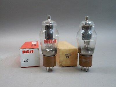

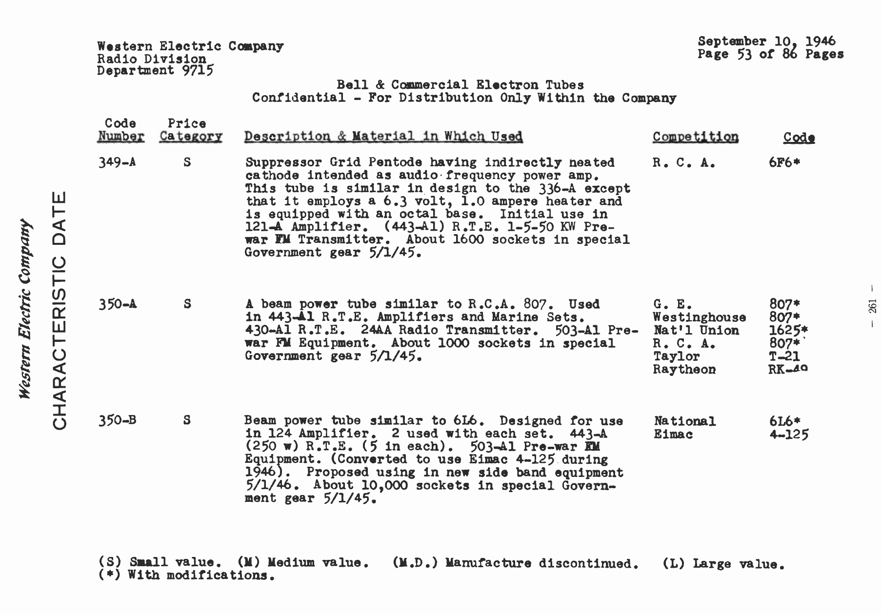

The 350a tube is new to me. From what I read on google the 350A seems to be a western electric version of the 807.
This is the only official information I have been able to find so far.
http://www.tubebooks.org/tubedata/we_tubedata.pdf

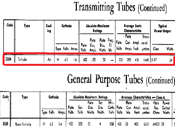

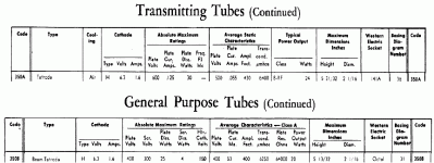

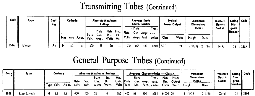

350A and 350B are apparently different.
The first is a transmission tube with slightly more power dissipation 30W
The second is a valve for general purpose with 25W power dissipation.
But i do not found the graphics with the curves.
