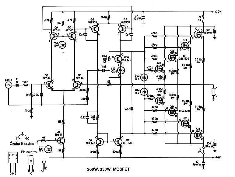

Try to use this amplifier. Its not cheap, but quality is great! Only 0,008% bad sound at 200W. Also you have to use minimum 10 000uF for suply. 10Hz-100kHz
