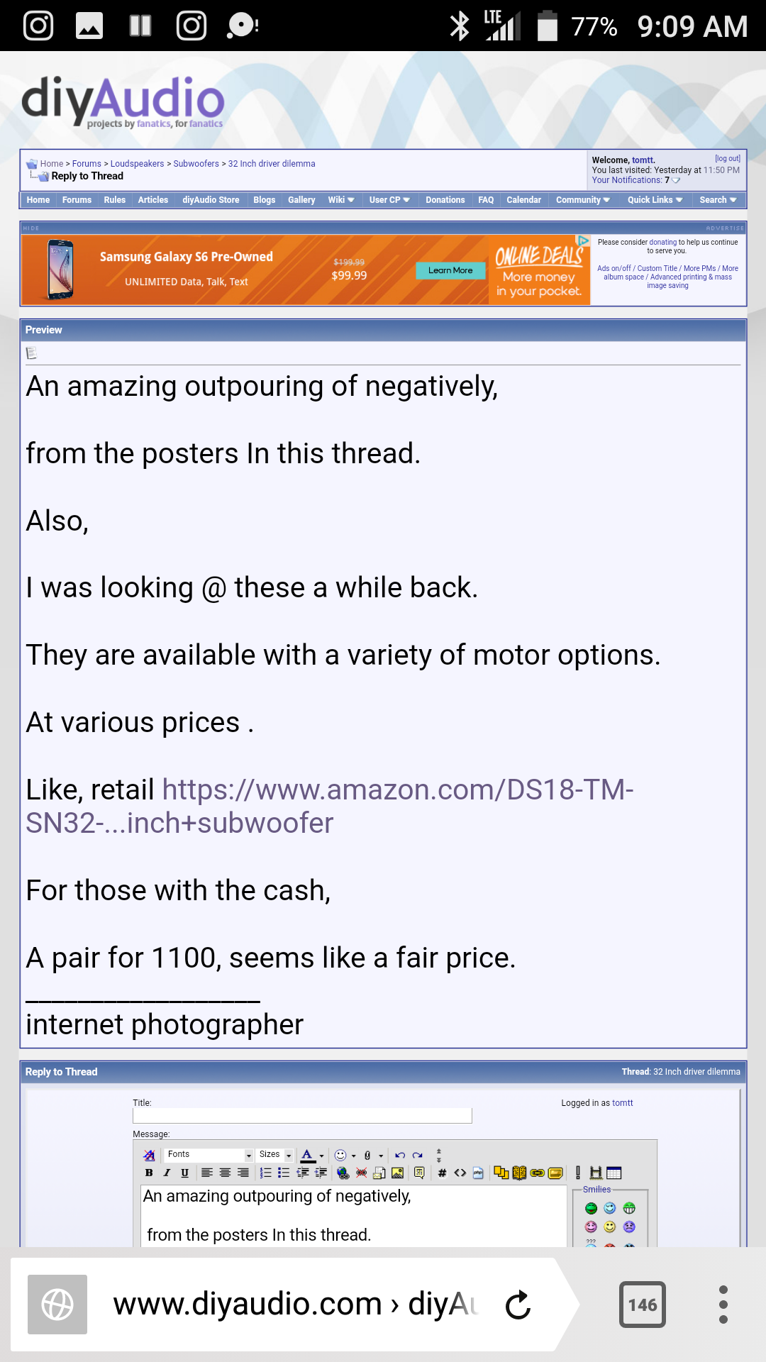

An amazing outpouring of negatively,
from the posters In this thread.
Also,
I was looking @ these a while back.
They are available with a variety of motor options.
At various prices .
Like, retail Amazon.com: DS18 TM-SN32 Troublemaker 32-Inch Neodymium 20,000 Watts 1-Ohm Subwoofer: Cell Phones & Accessories
For those with the cash,
A pair for 1100, seems like a fair price.

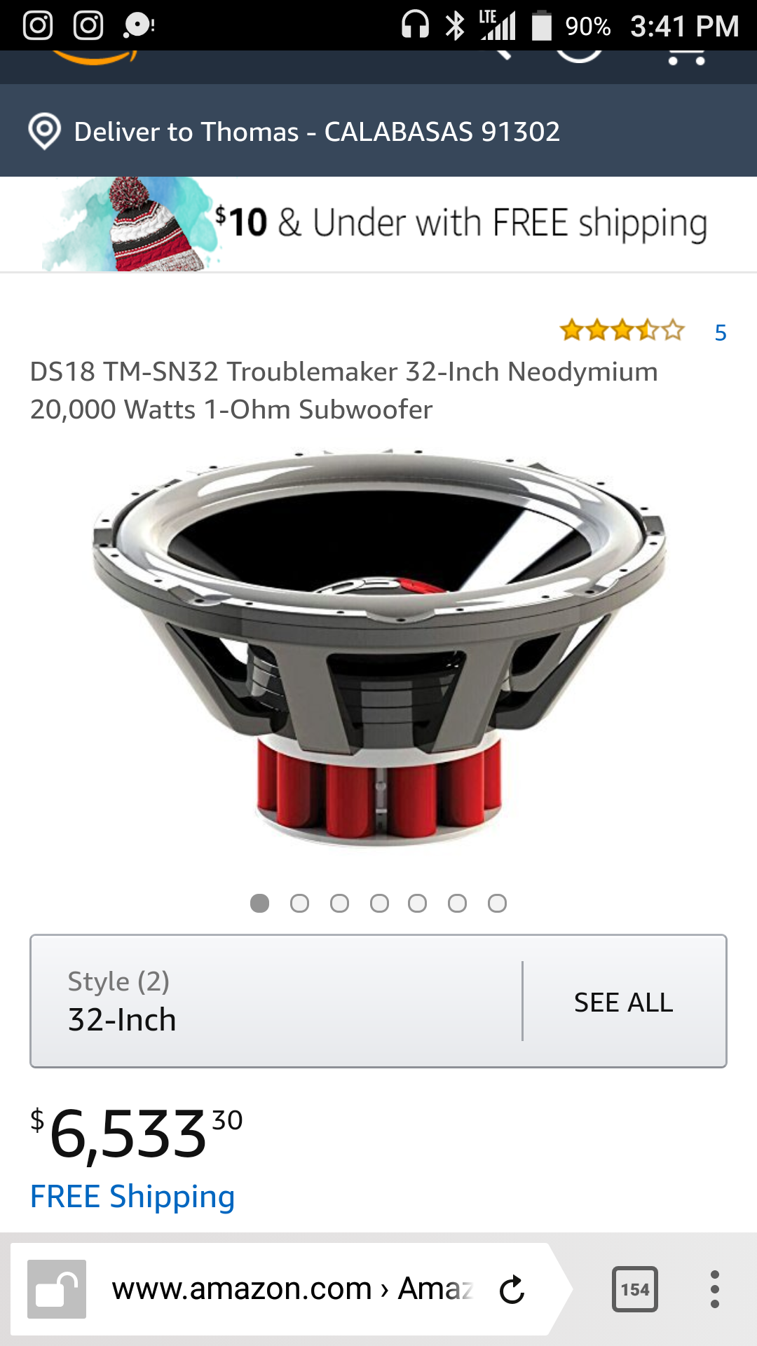

You missed the fact that a pair of the 32 inch drivers you linked to are over $13000 USD a pair, quite a difference from the $1100 you referenced which is for an 18 inch driver also listed on that page for some reason.
Really think he is going to get a decent pair of 32 inch drivers for about a grand?
I paid $1K for a pair of 16 inch Iconic 165s more than 12 years ago.
A touch of realism is needed here.
Which is why the word, retail ...
DS-18 is the brand name.
No matter, tell us about those Iconic 165's ....
DS18® - 32" TroubleMaker Series 20000W 1-Ohm QVC SubwooferDS18® TM-SN32 - 32" TroubleMaker Series 20000W... $6,649.05 more details on - DS18(R) TM-SN32 - 32" TroubleMaker Series 20000W 1-Ohm QVC Subwoofer
At least this thing has a big magnet and alot of xmax Xmax - 54mm. It needs 650oz of neodynium to get there.
Still for $6500 you could get ten 21 inch woofers and handily beat this for SPL at assorted frequencies.
