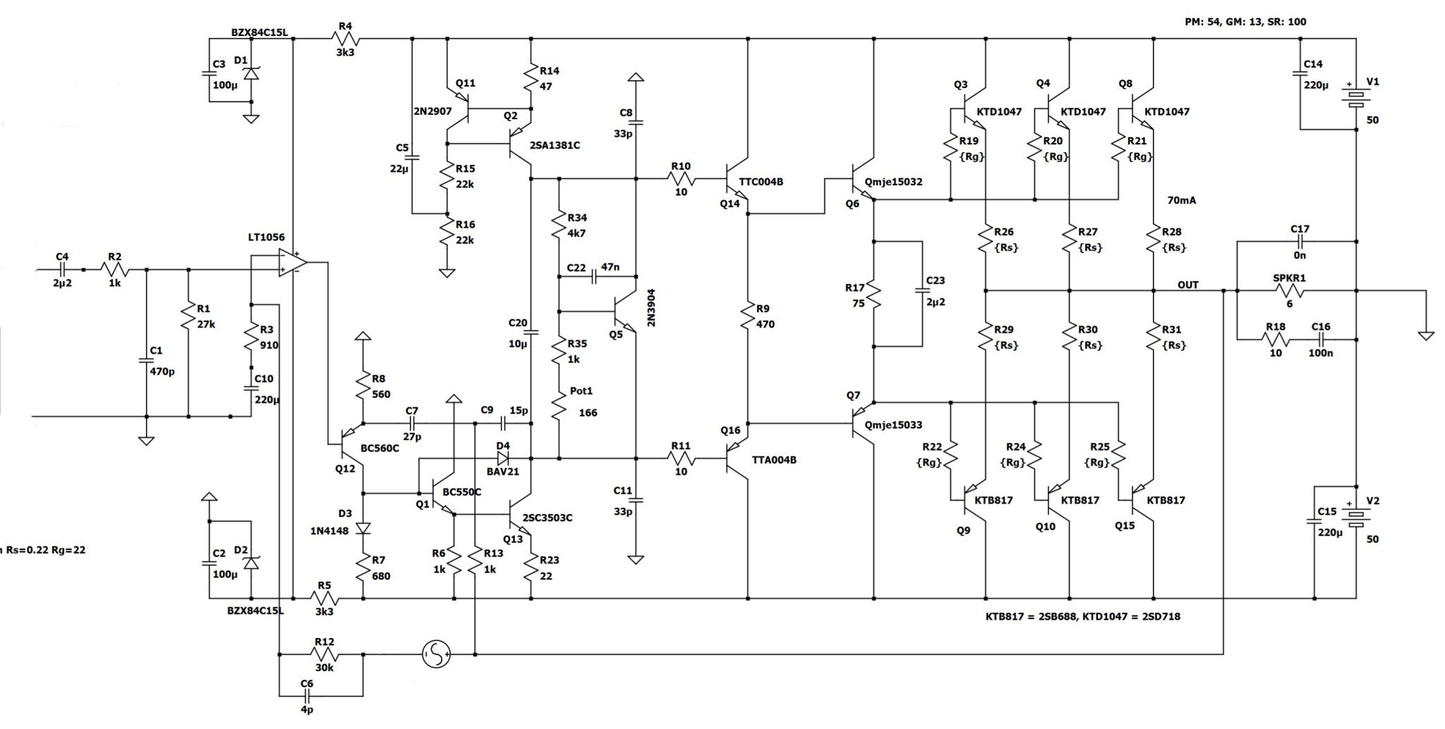

Maybe I have not been clear enough: both the Elektor amps (with Quad 303 style triples) with single 2N3055 's and Wireless World ( B.J.Cody?) 2955/3055's provided some 40 Watt RMS in 8 Ohms, so with triple output devices some 5 amps output should not be a problem with 3-4 Ohms load?

It is True that 2N3055 do have a 115W PD but the package that is used in the present amp is TO-3P / TO-247 which has a lower PD of 90W only as per the SOA chart for the transistor maximum you could do is 3Amps at +/- 30volts
You can do 2 Ohms with ,3 pairsMaybe I have not been clear enough: both the Elektor amps (with Quad 303 style triples) with single 2N3055 's and Wireless World ( B.J.Cody?) 2955/3055's provided some 40 Watt RMS in 8 Ohms, so with triple output devices some 5 amps output should not be a problem with 3-4 Ohms load?
Yes, 2 ohms with 3 pair of TIP35 OR 2N3055 - on +/-30 volts. Neither has an SOA problem at that voltage. If the S/B breakpoint is greater than or equal to one rail, you are generally safe. Any current that could exist at higher vce will be short-lived. Less than a quarter of a cycle at a time. Push your supply rails higher and the 3055’s actually fare better with the higher breakpoint. But their gain falls like a stone above 2 amps, where the TIPs will hold up decently to about 12. Trades one set of problems for another. At the higher voltages you need better transistors overall- higher S/B breakpoint AND better gain linearity. Then you just buy the more modern ON or Toshiba.

Here is a simulation of triple amp (50V rails) with KEC transistors KTB817 and KTD1047.

I was not able to find exact models for them (at least not for 2SD718), so this sim is very crude approximation.
All harmonics are under -120dB (inaudible); Thd is minimal, and it seems to be stable.
This will be next amp to build (after I'm done with new Circlophone), and I can re-use PCBs I made for the smaller triple amp..
