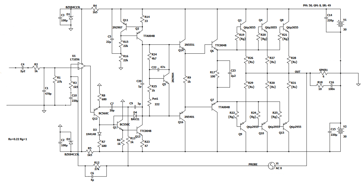

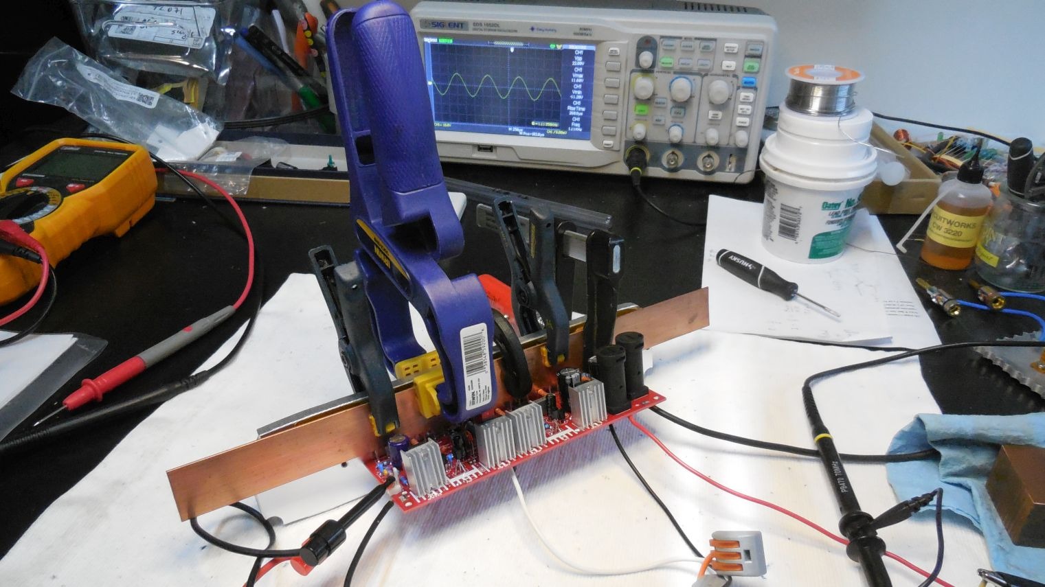

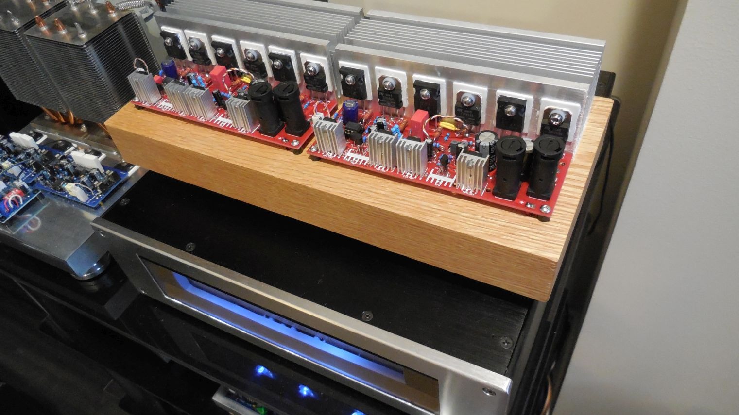

Small, 30W amp, triple (pre-drivers, drivers, outputs), with TIP3055/2955 outputs.
25V - 30V rails, op-amp input (TL-071 and LT-1056 tested).
Darlington VAS, 2-pole compensation.
50mA idle current per output pair.

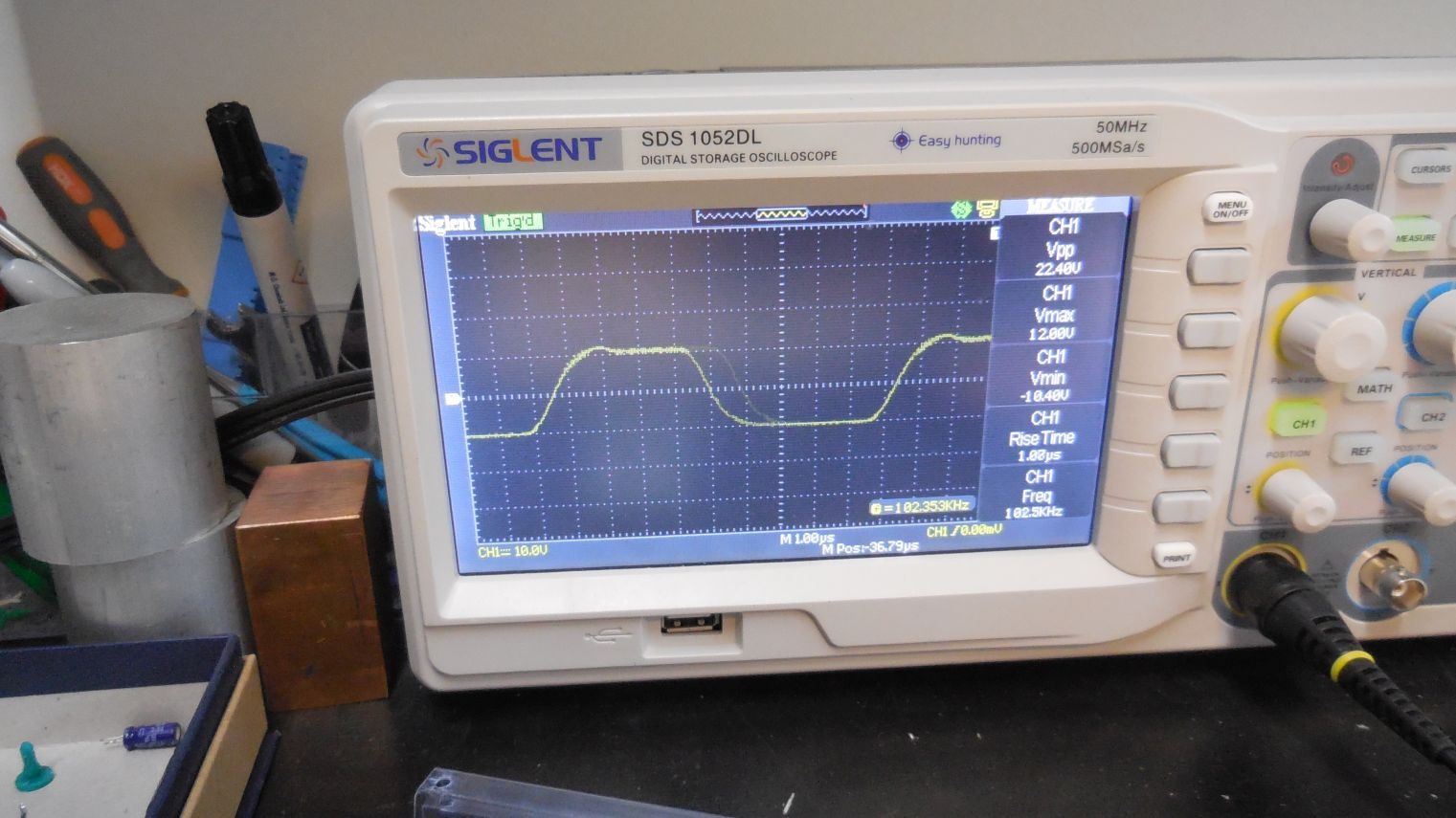

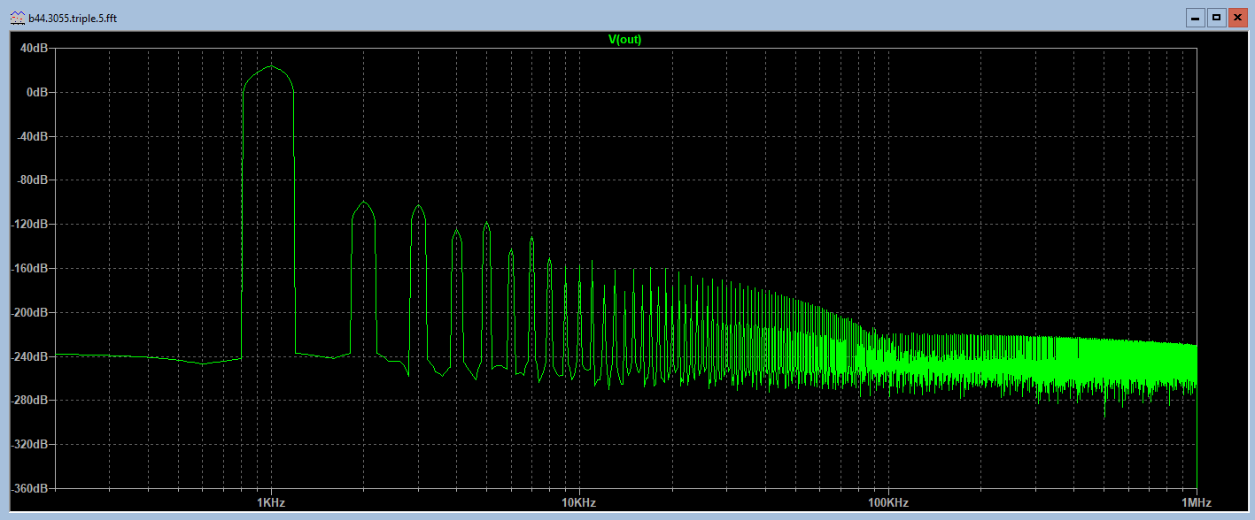

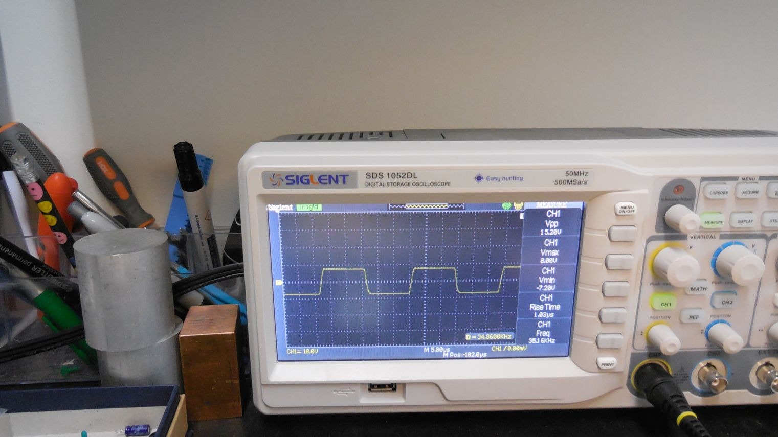

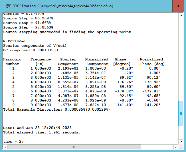

The sim (attached) matches the real world very well; no problems with building it 'as is'.
Just adjust idle current, and it works.

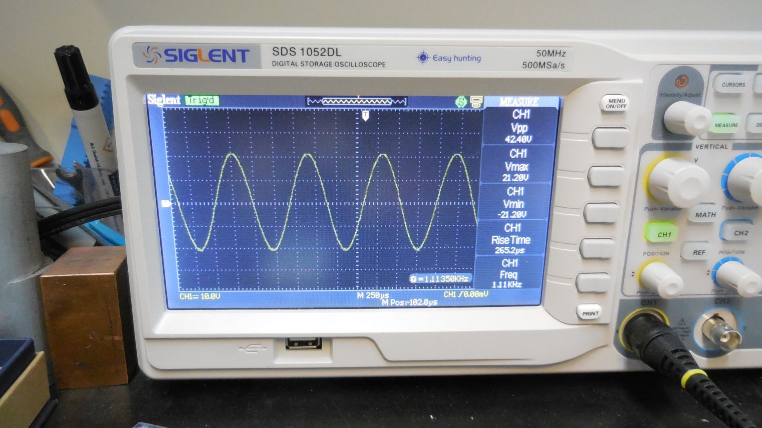

Negligible output DC offset (0.2 mV).
The output devices were matched for Vbe.
I really like the sound, slightly on the bass-heavy side for some reason, but very meaty and rich.
Sounds like a big amp.

The schematic has the unity gain capacitor shorted out.
In actual build C10 it's not shorted...
It was shorted in the sim, to sim square waves... I corrected the image..

Nice. The circuit is that of a bigger amplifier (with higher voltage transistors). Was there a reason for using TIP3055/2955?

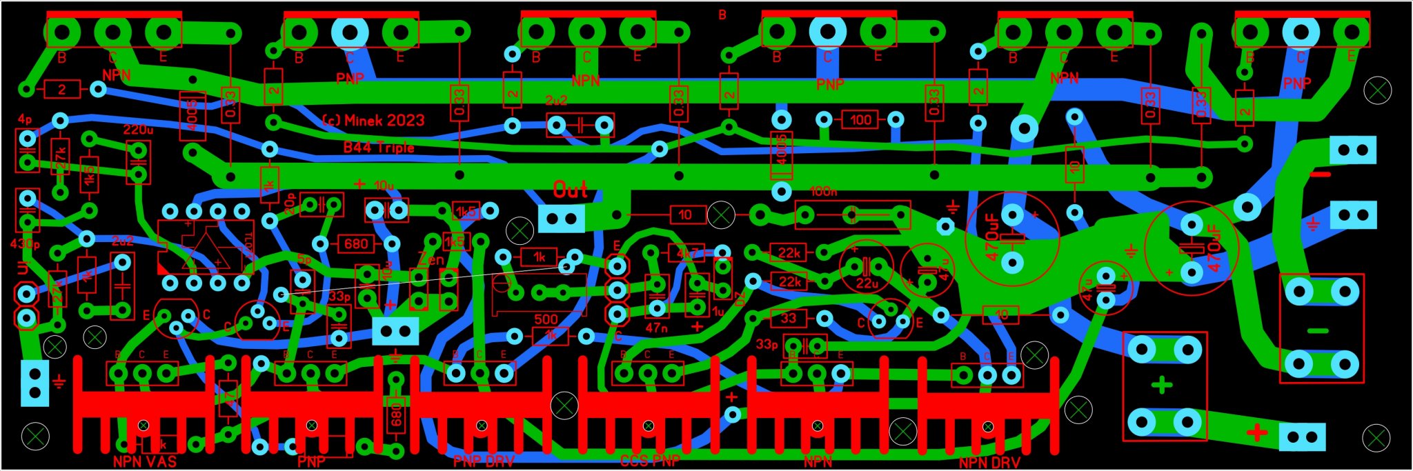

2) I designed this PCB for 'eventual' bigger amp (higher rails, different transistors), but they did not sim as well as 3055s; which is strange...

audio fun 👍 the VAS is biased by the feedback loop, although R14 is capping that offset swing, thanks for sharing

Send me a priv message with your email, will email you Sprint Layout PCB file.Do you have pdf files for the pcb?

a) Sim would have to be re-done, and I'm sure changes (e.g. in compensation) will be needed.
Triple output is likely to be sensitive to this kind of changes, and VAS stage is sensitive to op-amp changes.

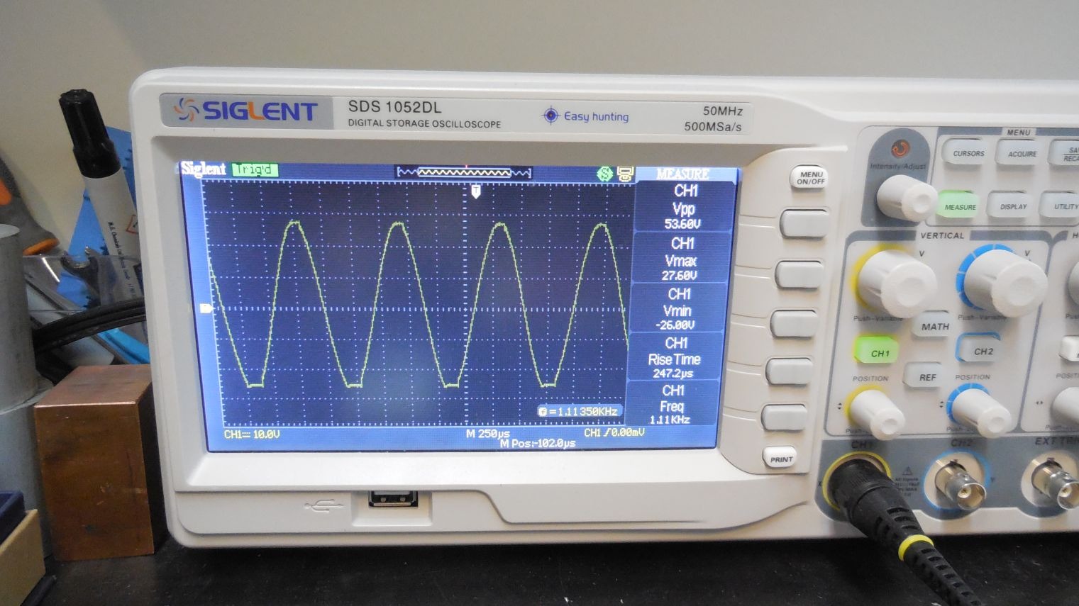

Current limiting on the VAS would probably fix that. You end up with current spikes in the VAS darlington driver during clipping if you don’t. Needed if you add output SOA protection regardless so it’s just good practice.has baker diode, but clipping looks poor.
