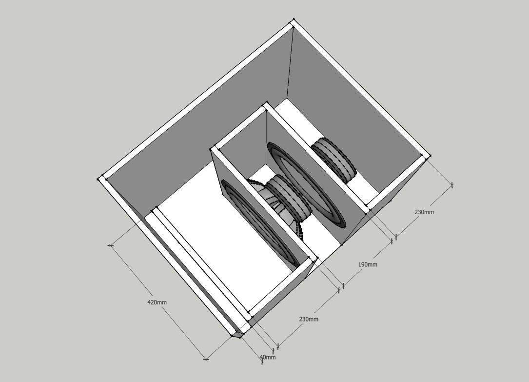

So there are no exact plans for the PPSL as far as I read. I have to choose drivers and then see what comes up. My aim is reaching down from 30's to 160hz with good efficiency. I can have 2 cabs.
What would be the right woofers for PPSL. As I am in Turkey, I can find RCF woofers easier than others. Some B&C models as well as a few Fane ones. I can find Eminence but not neodymium ones.
What are the parameters to look for, shall I go for 15's or 18's for my needs? I want to choose drivers, get them and build one to hear for myself.
I think I can put plate amps on them and let my set deal with the rest of the system. I can have hypex 2.0 or 4.0 per ppsl bin.
There are plans and a cut list for the 35hz PPSL using the Eminence Kappa Pro 15 LF2.
http://i56.photobucket.com/albums/g196/dkleitsch/x-1.gif
Two and a half sheets of 3/4" will build two cabinets.
When using other drivers, the optimum Qts is 0.312 for the best combination of efficiency, box size, and bass extension. Fs of the driver is pretty much the cut-off point, you can go a bit lower as the air mass in the mounting plenum will lower the Fs a bit.

I have converted to mm's, but I think i need to adjust differently. Do you think the port is ok, it seems narrow now. I think I have to take it to 65mm's and narrow the 230mm parts.

Ok, on your cut sheet, I figured out the slot width.
It is B-(E+E+F+2.1") so 30.5-(9.125+9.125+7.5+2.1) = 2.65" = 67.31mm
I took 18mm as the mdf width. That is why I added 2.1". 18mm roughly makes 0.70"
I dont need to go high, so I decided to narrow the plenum down and make the slot 60mm wide. Is this ok?

Hi kodomo,
The link in Post #19 has a lot of good information, and other links on djk's PPSL.
I'll attach one way to simulate a generic PPSL done in Hornresp. The back chamber and ducts are just like a standard vented (bass reflex) enclosure. The plenum in which the drivers are mounted can only be approximated; I used OD (offset driver horn) for the driver arrangement: during the construction S1 can be reduced by blocking off the rear corners of the plenum, the drivers are centered @ S2 (you'll have to calculate how much cross-sectional area you have left over), @ S3 the plenum is past the drivers to its normal rectangular cross-section which remains to S4, and S4 to S5 is the rounding off (chamfering) of the plenum edge to the front face. Import the file into Hornresp, and change it for your application; you can also export an AkAbak script file from this (you'll have to set all flare rates to Con).
According to djk the big peak @ the top of the response band does not happen in reality, it's only due to the inability to simulate the drivers/plenum correctly (one driver inverted, and drivers moved as closely together as possible).
I suggest you read through the thread linked in Post #19.
Art Welter has done some real good measurement work on a dual 15 PPSL that he built.
While Hornresp shows peaking of up to 6~7dB at the top end of the band, his measured results were around 3dB at about 175hz.
I have made the plenum width as narrow as 5", but that requires a loading hatch on the bottom for mounting the drivers. My original prototypes were made this way, but with a 2-1/2" wide port on each cabinet side, and the overall dimensions being 18H x 36W x 30D.
The plan and cut list are for simple construction for PA build.
