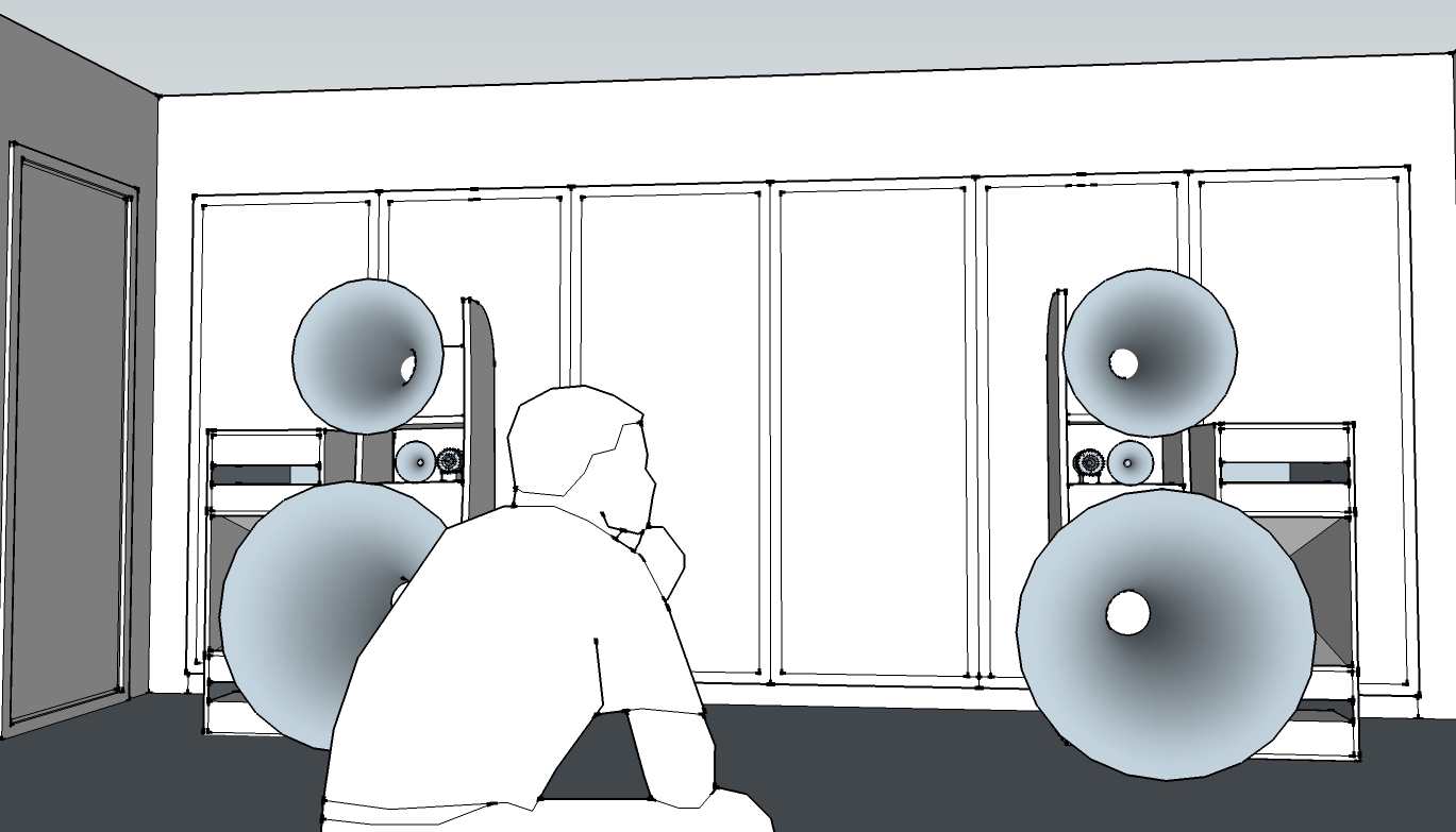

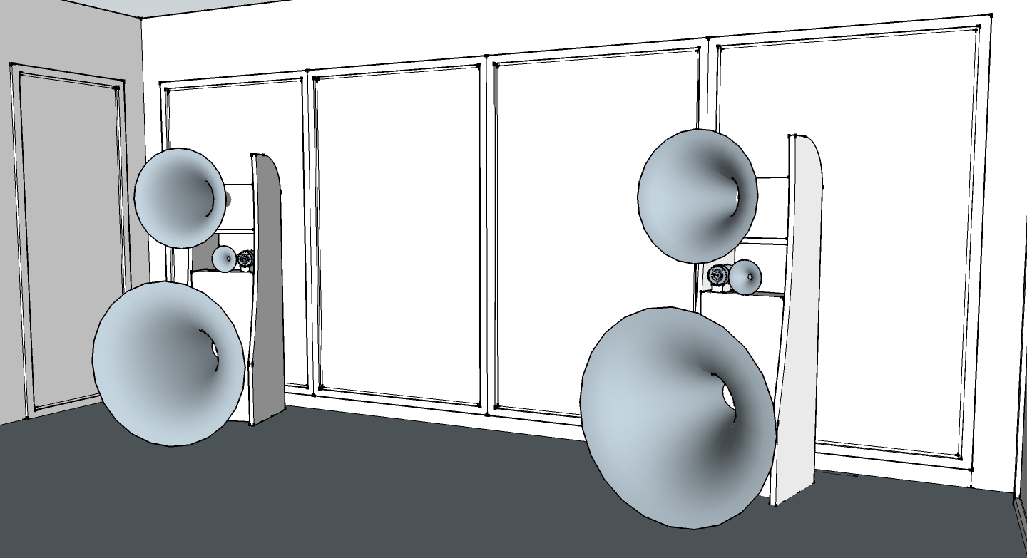

When I say this is quite a no compromise system for me, it is what I mean by that. Of course there are no ideal solutions, I am aware of that 🙂
I have a klipschorn as well and I like its bass too. Through the years, I changed its woofer, its crossovers, its midrange horns, its midrange drivers and its tweeters. So it is not a Klipschorn except the bass bins. I think its the best and most important part of that design. The time delay issue is problematic, but can be remedied with digital delay. I cross my khorns bass around 350hz, which also sounds better and less problematic than crossing it between 400-500hz. To do that, I got bigger midrange horns, than built even bigger ones. Got cd's that can go that low. Changed the crossovers etc.
However in my new horn system. I am trying not to have the problems of the klipschorn system. I will have other problems with this new design for sure but less hopefully or stuff that will not be relevant to my listening space or preferences.
This new system will not have time alignment issues, horns work in less than 3 octaves per channel, no group delay issues trying to reach cf of the horns etc. These are the problems I wont have, this is what I mean by quite a no compromise system. There is the height and lobing problem but I can listen from far enough so it is not an audible problem anymore. Better suited for me 🙂

Here you can see the 4 channels I have designed from 160hz to 45khz. I have the tapped horn for 20-60hz as well. So I am missing 60 to 160hz. As you can see I can operate the tapped to 90-100 and the upperbass 1metre tractrix down to 90-100hz. It would be a compromise I dont want to do.
