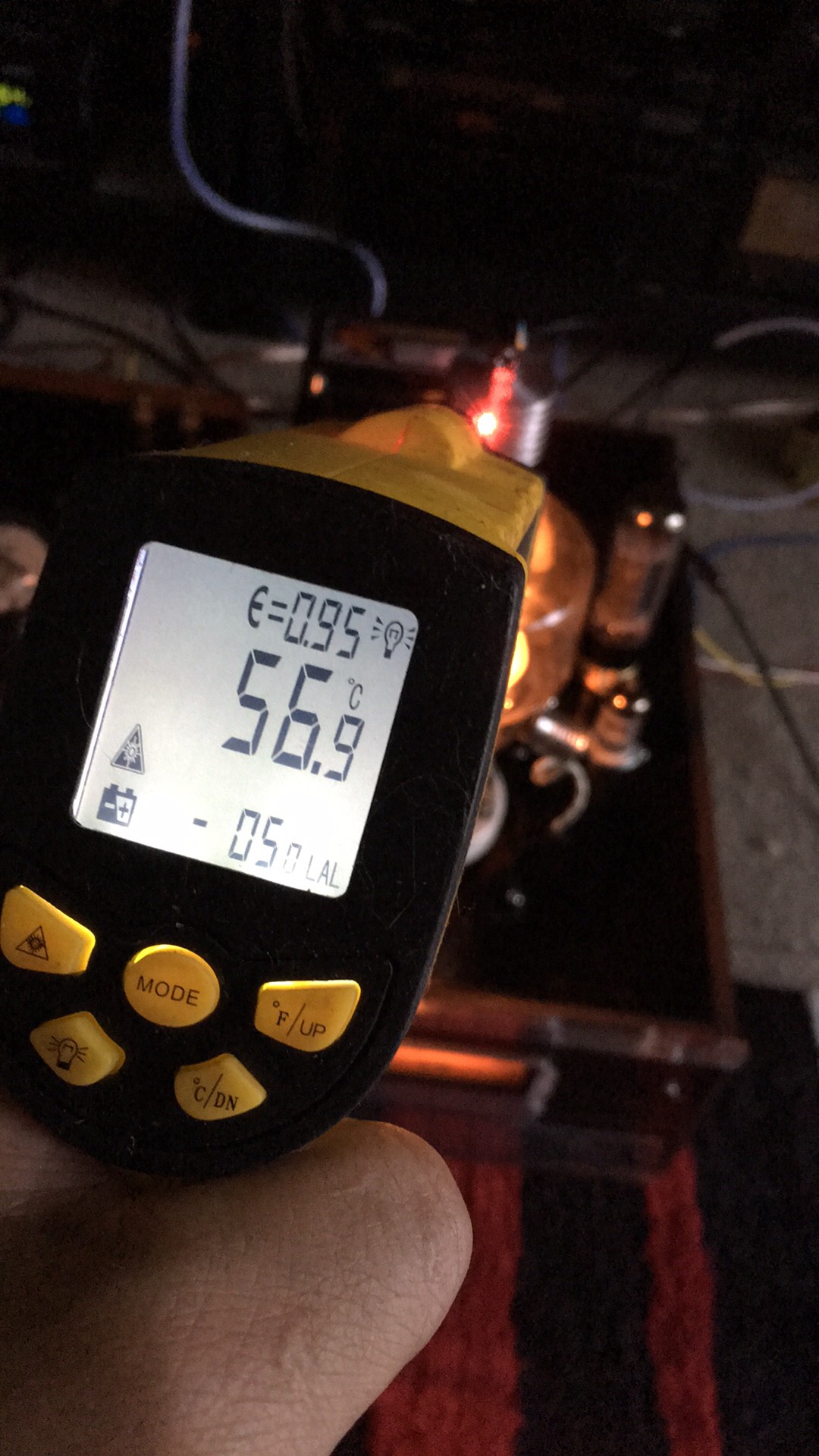

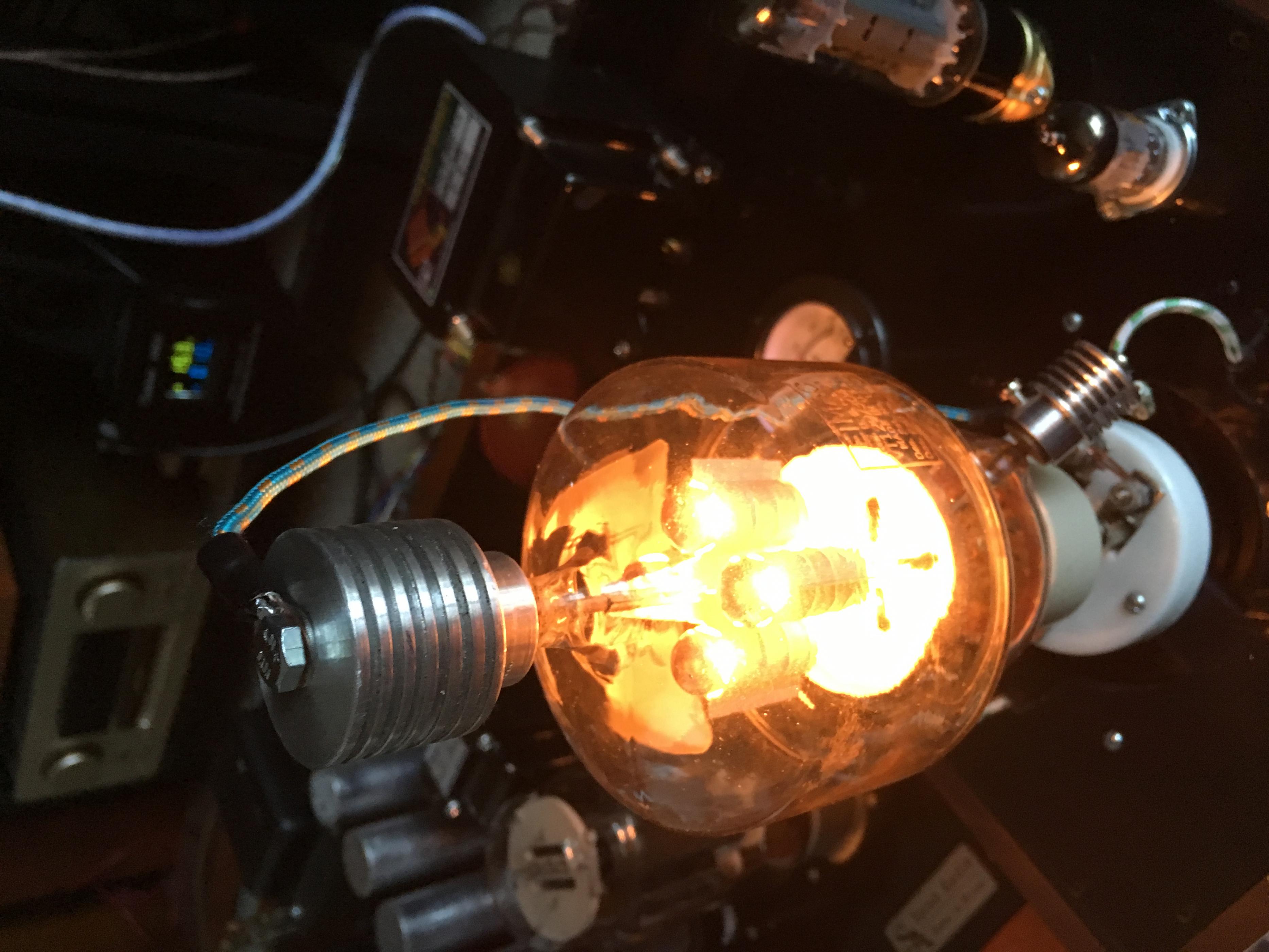

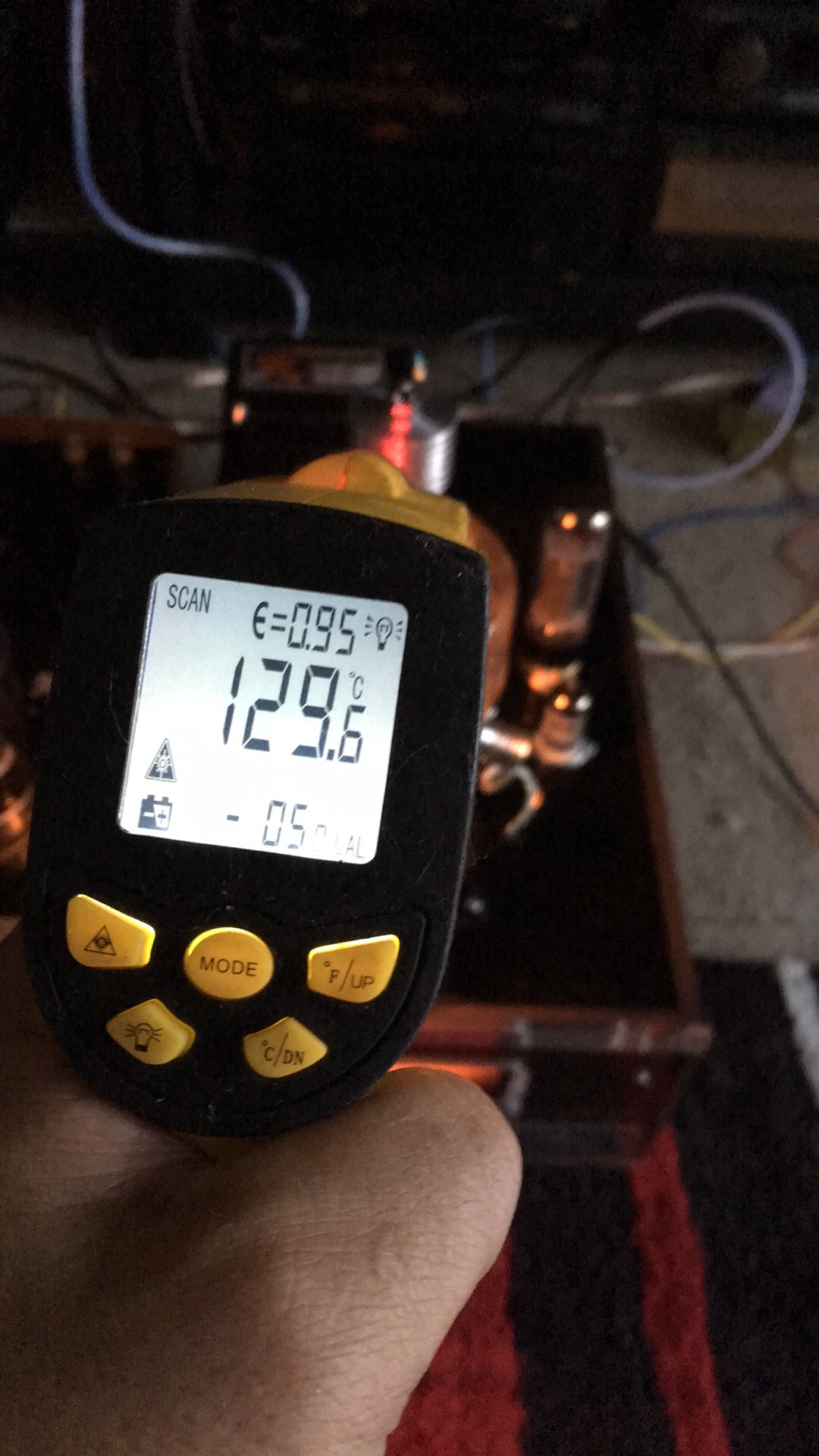

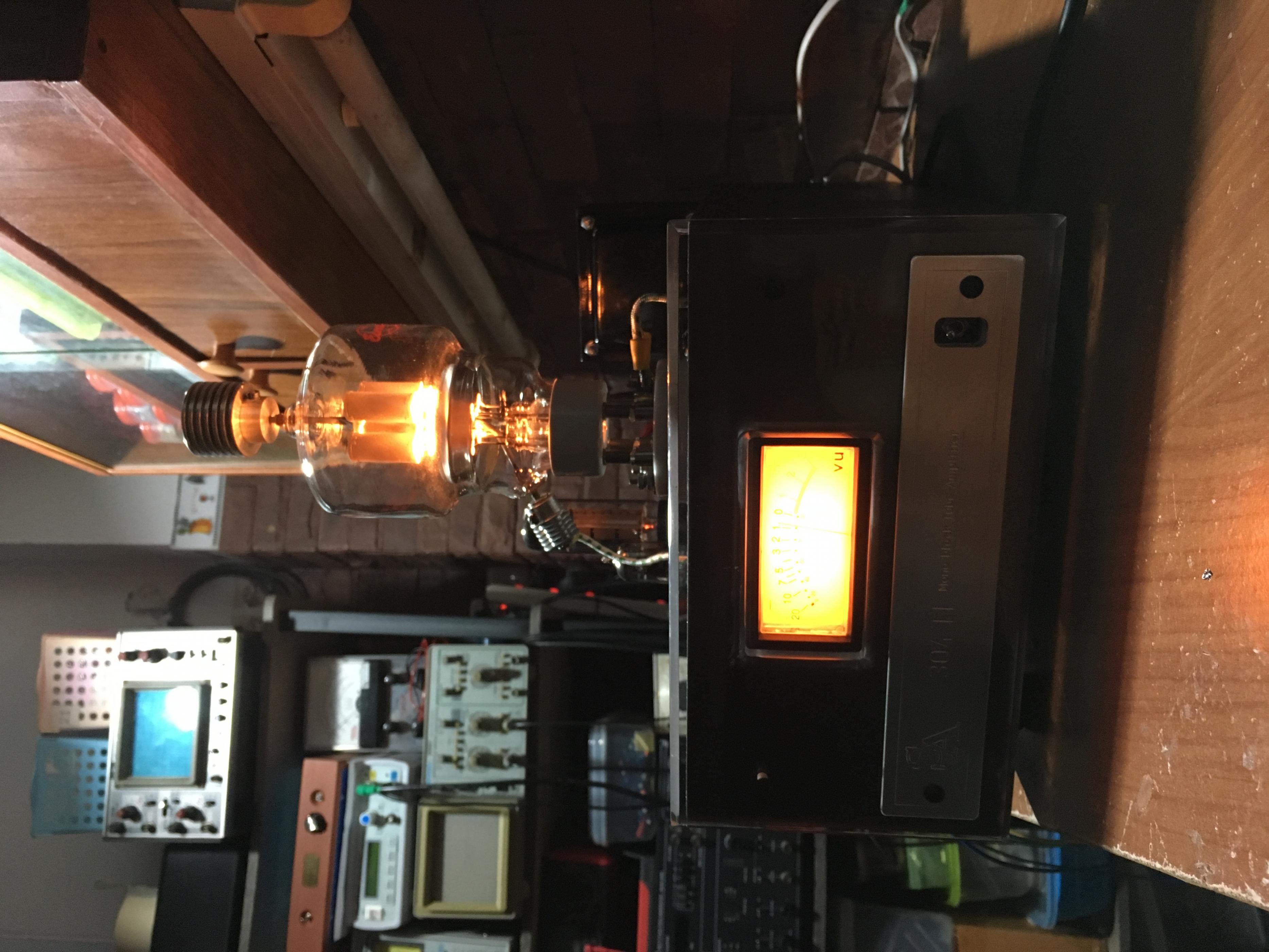

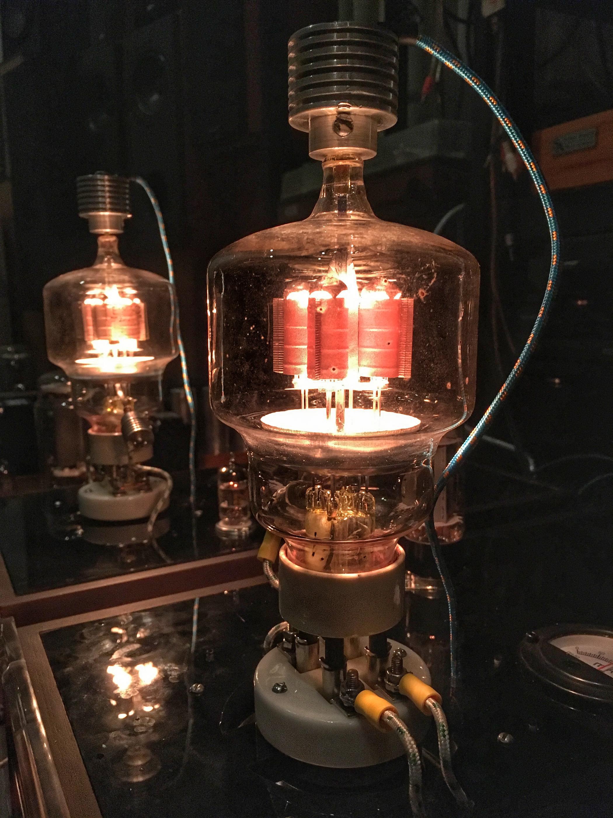

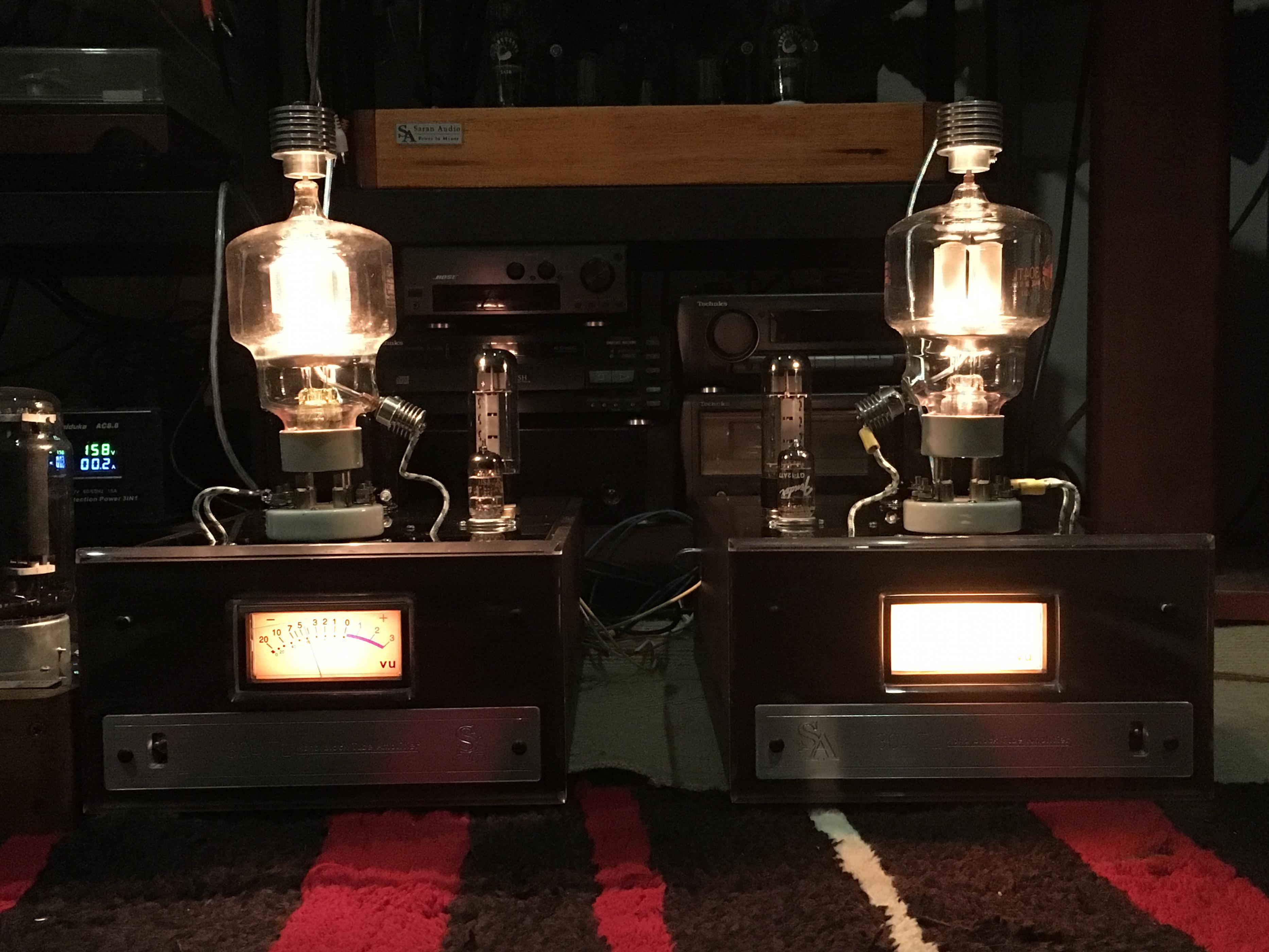

Hi I’m finally finished. Se mono block. Amp. Tube no 304tl. Run with 700v vp. Around 100ma. Idle

to avoid gas 304tl need run red plate
no getter triodes!
Thanks you it run with red
and now???much more???
my 304TL run 1200V 180mA with two papst fan @ low speed
