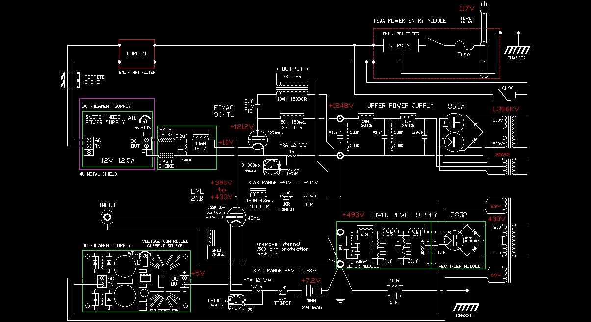

I'll need to "back calculate" to find the current the transformer will need so the heaters get 12.5A. That comes to 22.5 amps or more needed.
using: Iac=Idc/1.8.. for grins I'll see what I can find on the shelf.
ack..... only up to 20 amps from hammond ( 11.11A after the rectifier / filter) 🙁

I don't know if that formula should be taken as a constraint, but 20A is about right.
How about a 250VA 120V:12V ICT (8-10 lbs) or maybe a Hammond toroid e.g. 182T12 (5" dia, 5.5lbs)? Use a larger first cap for a 12V nominal secondary. I think the DCR will be OK on these, even may need to add a little on the primary to tweak the output down.
I'm wondering and curious about Gianluca's recomendation against the 12.5A chokes, not sure of his reasons.

I wondered about Dave's 4 diodes myself... I think it should be 2 as there are only 2 diodes conducting at any one time (hopefully)
VDC = (VAC * 0.9) - 2 * diode drop at peak current (40A in the PSUD example above), rule of thumb for a bridge + critical inductance choke input filter.
Looking back at Gianluca's post, he is adding extra headroom for AC+DC assuming use as the input choke in a choke input filter. Your ebay chokes will be fine in the cap-input filter PSUD2 I just posted as long as the DCR is ~0.1 ohm. A 12V/250VA ICT should be ebay-able for mostly shipping. Experimentation and tweaking will be needed.

My question is: If there will be 12.5A of DC current going through the load, why do you need more than 12.5A of current capability from the secondary of the power transformer? Obviously you need a higher voltage, (hence VA rating) but shouldn't the current remain fixed paying attention to kirchoff?
That is correct. 10mH/15A for choke input duties (both 10mH and 15A are minimum values); whatever mH/12.5A for cap input duties.

gotta love those tolerances...they can sneak up and bite you..... the 10mh 12.5A chokes measure at .2 DCR, not the published .11R Changes up a few things....
Michael, playing around with PSUD using a higher voltage transformer, 18V.
If I change the first cap from the 20000uf that was in the 12v model down to 2200uf in the 18v, using .2R for the chokes DCR, voltage gets right around 10v.
If I change from .1R to .2R in the original model with 12v, the voltage drops to around 8.75 volts.... that's why I modeled with the 18V tranny and a smaller first cap.... DC becomes a bit more rippley, but the larger tranny makes up for the V drop.
Now If I get a tranny in my hands, I usually find that the Voltage RMS measure from 5 to 10% above the published RMS value. What ever that measured value is, I would then plug that number into the unloaded RMS value for the tranny in PSUD, so the 12.6v might actually be 14 volts or so, the 18v tranny mught be nearer to 20 volts or so..... by sizing the first cap I can tweak the voltage a bit, at the cost of higher ripple ( If we don't want to put the big electrolytic cap in the third position instead of the "fooler" 100uf)... we don't want no stinkin cap in the cathode loop 🙂
cold? hot? how did you measure it? Jeff, you really need to breadboard it to see how things go. PSUD will not tell you all the truth.
I guess cold.... I took my trusty Fluke and measured across the leads.

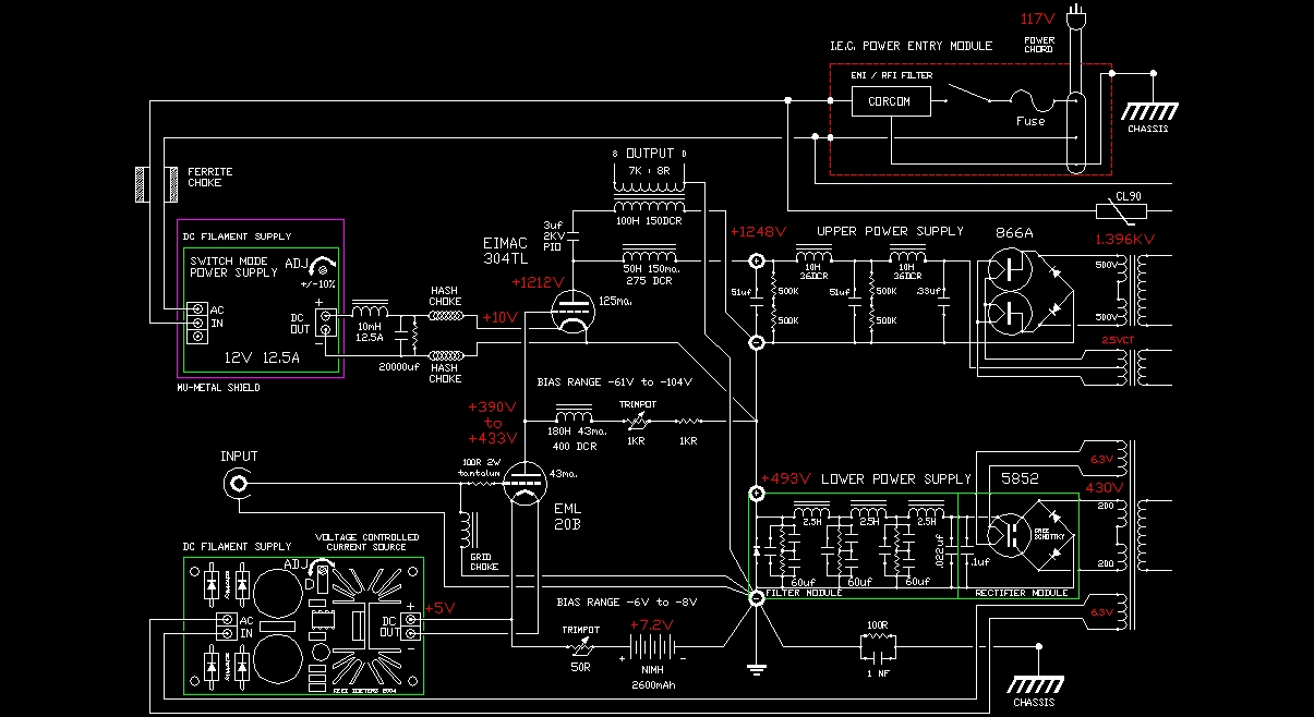

My smps it still in transit, grrr. Just trying a small one I have under a small load; not much ripple on a scope it may be possible not to use any choke in the circuit at all. ronp
Update; FINALLY sps showed up; 5v at 50!amp. Yet still has hard time starting tube, will start if filiments are staged, haven't tried resistor in series yet for starting. However do have some hash specs for you. With both filiments going and at 5v, filiments paralleled; at 27.3khz there is a 8mv spike and at 54khz, 3mv. The sps switches, they say at 20khz. I only ran the tube (first tube one filiment died, RATS) for about 5min to stablize, but the sps didn't even get warm, it does have a cooling fan which didn't turn on... YET. I don't have any experience with DHTs as far as filiment noise, 8mv audible? Cheers Ronp
update on up date, 1 ohm resistor , then bypassed will allow tube to start. Just used a 25w one cuz that is what was handy, not on long enough to get hot. And one choke, or hash filtre in this case knocked down the 3mv at 54kh, spike at 27 still there. Choke dropped voltage to tube from 5.v to 4.89. ronp
Ready to bread board...almost, just waiting for the Output transformer which is due next week. I've decided to use Yamamoto amp meters and the schematic reflects their installation per Yamamoto vis-a-vis their internal impedances.
I'll be bread boarding the power supplies first, using some bigazz 300 watt load resistors sized to what the actual load should be, just to make sure the voltages are as they were calculated (or very close), and to see the difference between PSUD and real world measurements.
