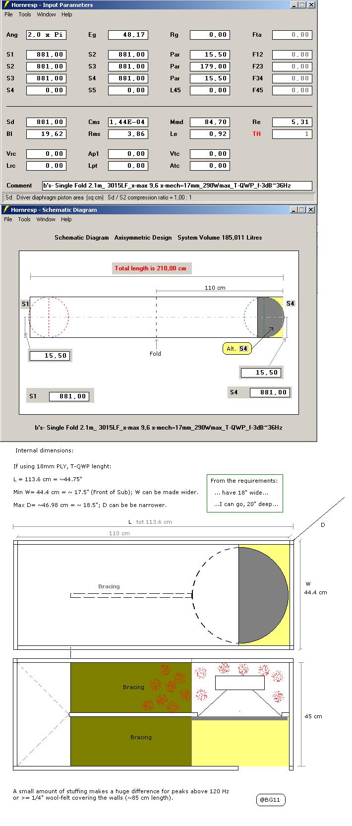

Good to see that you're still at it. I found one of bjorno's 3015Lf simulations, haven't found the thread yet; this should be an easy build. Haven't seen an updated SS15, I think that the original is still as good as it gets for that driver, and that range.

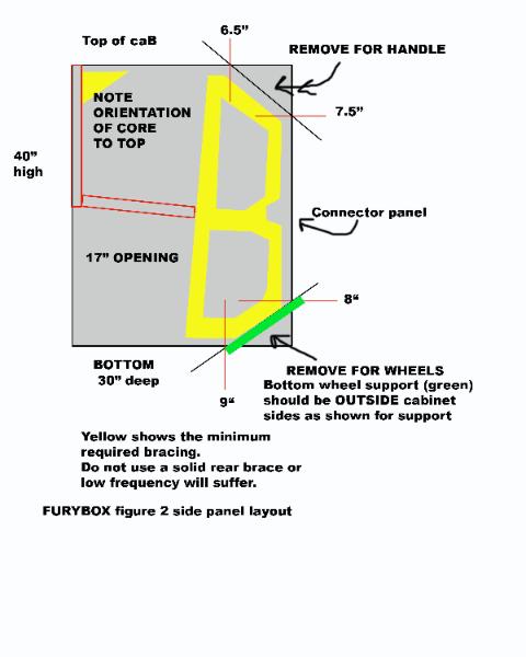

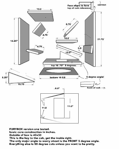

For the fury box see Post #535 here: http://www.diyaudio.com/forums/subwoofers/131852-live-sound-specific-tapped-horn-thread-54.html , also take a look at the surrounding discussion. I'll attach the drawings I have from Screamersusa's website.

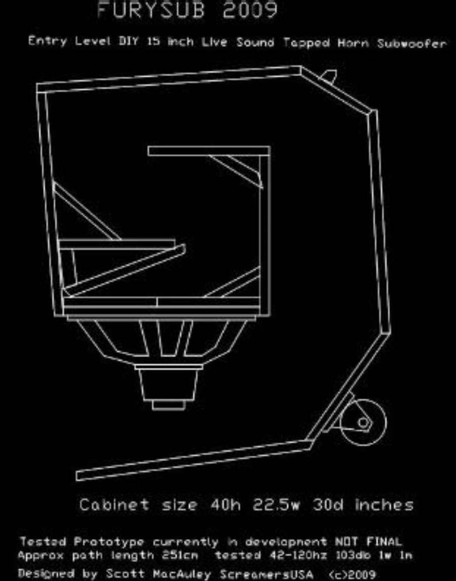

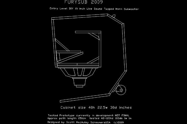

I have the dimensions for the 2009 version of the Fury Subwoofer if anyone's interested. They do take a bit of deciphering, it's not a step by step build instruction. I'm not sure if there have been any updates since then.
Hi TimLewis,
Yes, the pdf in Post #7 is what I referred to in Post #6, please, take a look around at the preceding and following pages if you want to build the FURYBOX. There never was a complete resolution as to some of the finer points, and screamersusa used up a lot of plywood to come up with this version.
Thanks for finding those.....
I built the last 4 fury subs from the same drawings so that was as far as I got due to life's unexpected battering... The 6 served absurdly well for years and I still have 2. I HATED to give the other 4 away but there is no work here.

A couple of quick notes on the furysub.
The furysub benefited from two discoveries discovered while building its impossible to recreate predecessor, the CH1524.
The first was the use of fluid dynamics modeling to tweak the angles as best as possible. I used a demo of a plumbing and air conditioning flow software to get a feel for how air under pressure might react inside the cab.
The second was the discovery that it takes trial and error to get it right because Tone is subjective. Flat on paper may not sound very good in real life. I Learned that Speaker building is an art just like making violins or guitars.
The furysub's intent was to recreate that angry authoritative tone only achieved by 8 stacks of double 18's in a concert hall but in a club size.
It was intentionally not designed to be perfectly flat response.
I wanted a sub that enhanced 40-60 enough so that I could cut said frequencies instead of boosting them as most people do.
They do that very well and fit a standard pro sound truck pack.

Right, as noted in post #12, TH can have around 6 dB more output for a given excursion, but distortion is higher at a given excursion than the same driver used in bass reflex cabinets, especially when using light cones like the Eminence 3015LF or 4015LF.
This doesn't surprise me - those distortion components are likely being amplified by that same gain in overall output that the TH is providing. The enclosure doesn't care if its a copy of the original signal or a distortion component that's originating from the driver.
The question really here is if the distortion components are being increased by more or less than amount that the overall output has been increased in the designated pass band of the alignment. If less, then the TH can be said to be a lower-distortion alignment for a given driver.
At Fb, the TH and BR using the BC18SW115-4 had similar distortion level, though port compression reduced the high level output compared to low level in the BR. Interestingly, the opposite occurs in the TH, upper level reduced at high level compared to low, another sonic difference apparent between low level and high level operation between TH and BR.
If you're referring to continuous output, the TH's drop in upper frequency output at higher SPL levels could be due to the increase in Re (and therefore Qes) as the voice coil heats up. This can actually be sim'd in HornResp by upping Re under the Driver options in the Loudspeaker Wizard. There is some impact at low frequencies as well, but it's a lot less. Maybe it's best to build THs with a passband that gently slopes upwards to compensate response changes at higher SPL levels, rather than opting for a flat passband. Hmm... I'll consider that for POC #4 .
