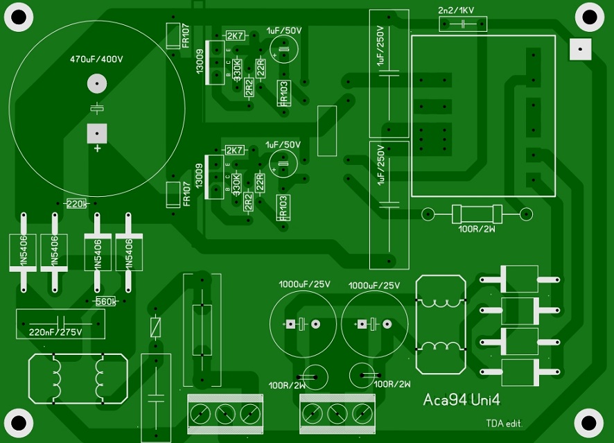

You can try ee16 from psu,it's used as BDT in PC PSU.Only you should add small gap in core,no need for rewounding.
Because it should be high permeability one.You can use original E16/E19 but you must add small gap.If you don't add it,transformer go to saturation and whole inverter works on ~10kHz which is small.
Yes I have pcb,but I don't know where is it.
I'll search now...
I find PCB:

No,no,not 12kW 🙂
First it split to +/-160V with some 200V capacitors from PC PSU 🙂
It put out about 90-100VAC RMS 🙂
2500W @ 4R and 1250W @ 8R
I use two 8R in series to get about 600W @ 16R 🙂
But IGBT can sustain 4R speaker 🙂
