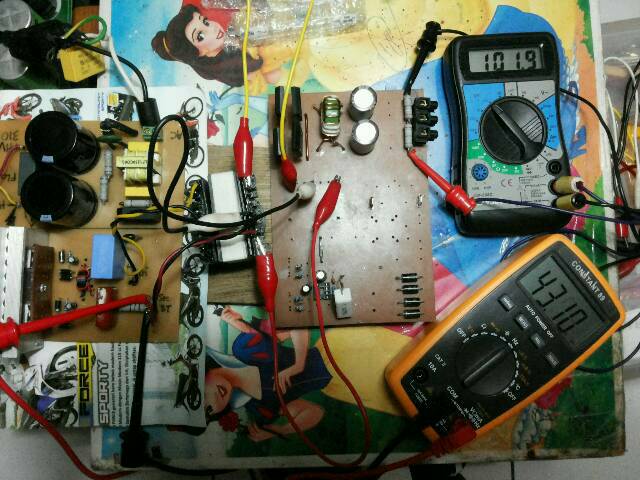

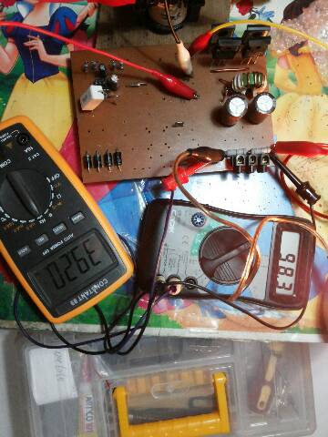

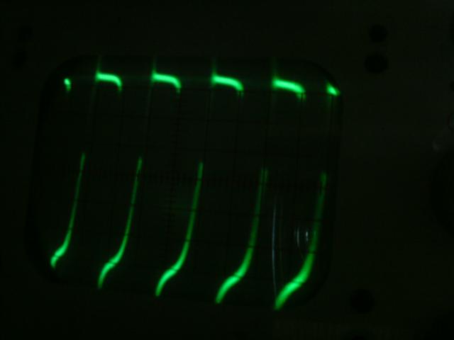

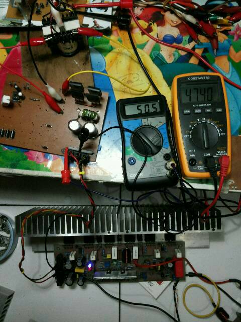

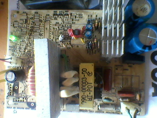

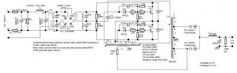

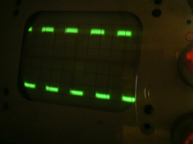

Here's 300W SMPS based on PC power supplies.
A few pictures are not my,i'ts from my friends.

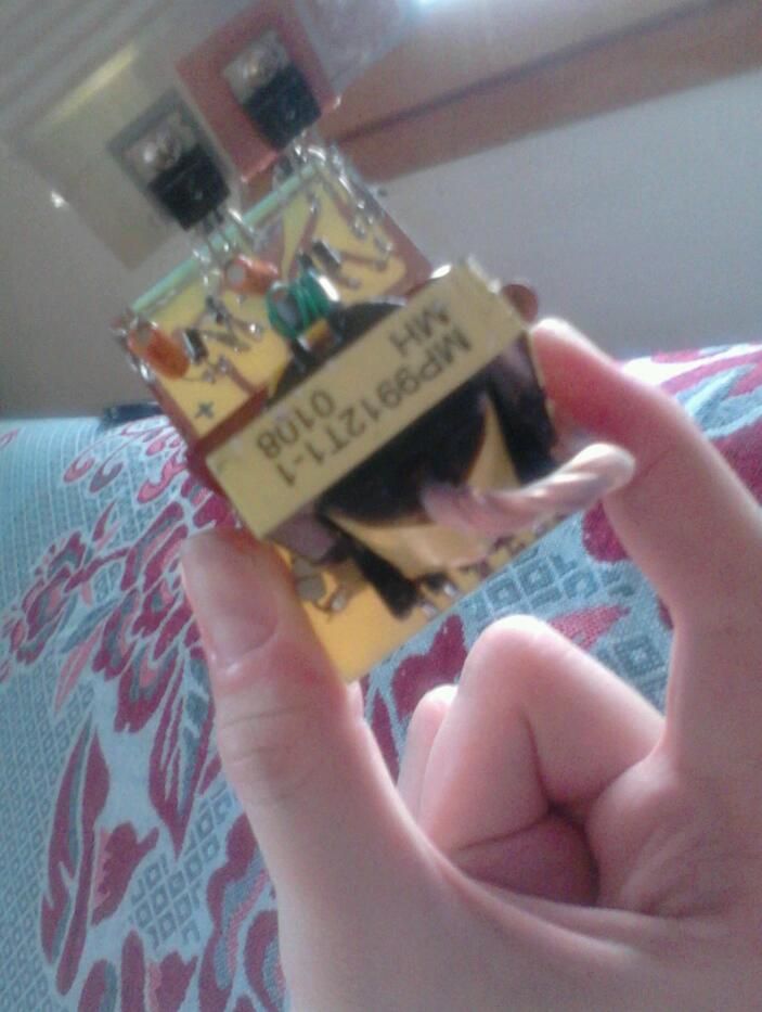

Base drive transformer is toroid from CFL lamp.
Storage core is yelow toroid core from PC PSU too.
They have 0.5V per one turn.You can use more cores glued together.With two cores value is 1V/turn.
You can calculate it this way:
Uout * 2 / number of cores.
This coil is attached after output diodes and before electrolytes.

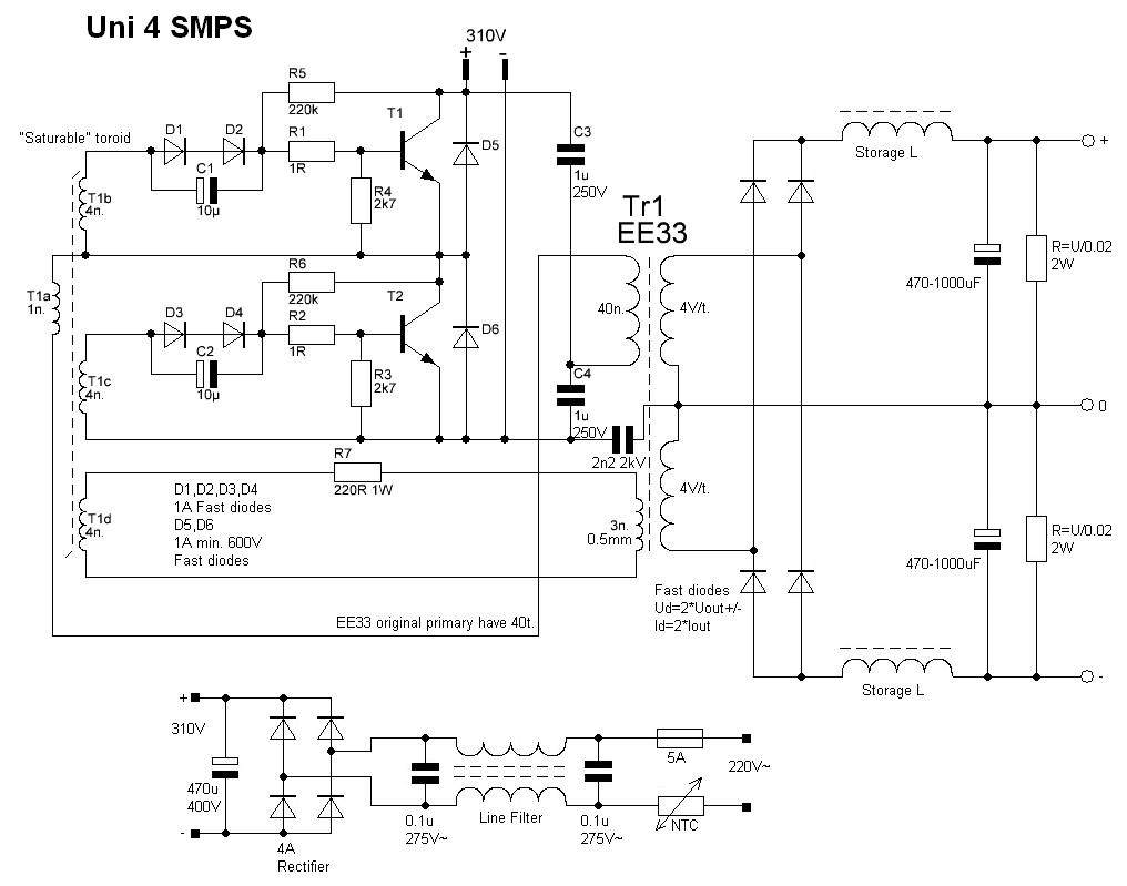

I posted pictures,all is on it 🙂
Schematic is for 12V,for other voltages ee33 have 4V per turn.Resistor on output can be calculated this way: R=Uout/0.02

If you wish,you can short circuit protection.This can be make by place storage coil in series with primary ee33.I used 24turns,but coil is hot.After this,storage coils after diodes isn't needed.

Stewin,I'll post schematic when draw it.
Multimeter in picture shows frequency ~40khz.
No,they use bipolar transistors,can used MJE13009 for ~500W

T1,T2 any transistor from AT/ATX,13007,13009,2sc2625,2sc4242,etc.Can be any 400-500V,curent 1A for 40W of output power (mje13007 is 8A.This means 8*40=320W smps)
Send me picture of your BDT (base drive transformer)
You can calculate thickness,use 3.5A/mm^2
If you use 300W smps this is ~2A at 160V (half of DC input,this is primary voltage on ee33)
One turn have 2A/3.5A/mm^2= 0.6mm^2
Four turns have 4* smaller diameter (you can use 0.2mm^2)
You can use etd39,and it's enough for ~400W
But you must calculate windings on it.Primary have 160V,and feedback must have 10-12V.

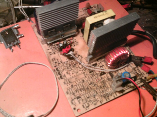

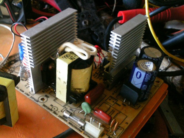

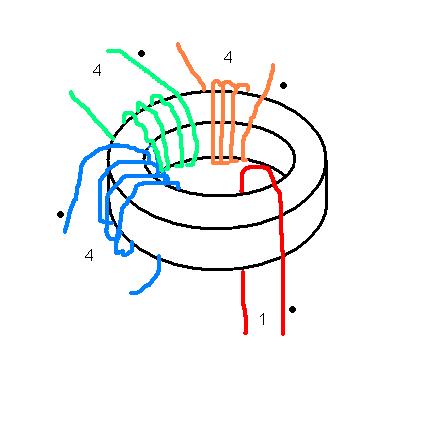

So... don't working 🙁 Transistors are getting hot only... No output voltages. 320V ok.
The driver transformer wound like on the picture. Primary on the main transformer 26 turns. feedback winding 3 turns.
Perhaps inverting the feedback winding ?So... don't working 🙁 Transistors are getting hot only... No output voltages. 320V ok.
Also I wonder ,are C1 and C2 polarised in the right direction.The diodes in parallel block the voltage in the direction the electrolytics can handle.
