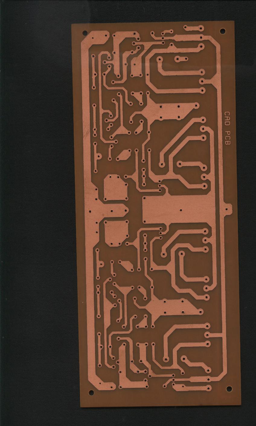

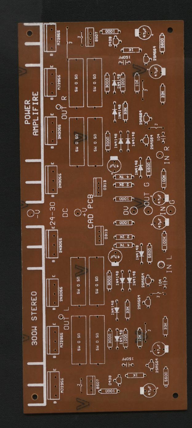

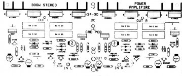

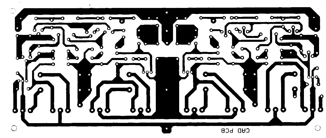

300w power stereo amplifier with pcb layout
all members explanation appreciated and which class is this?

You will need more than 2 pairs of transistors per channel (more like 8-10 pairs), and certainly better devices than 2955/3055, to get 300W into 8 ohms... and at least 85V supply rails.
It will need a huge heatsink, and will not be cheap.
