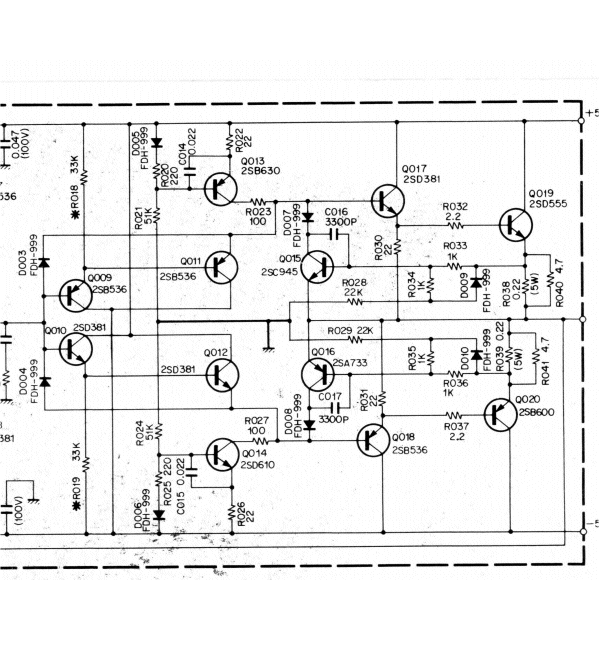

By anatech - If you look at a Nakamichi 620 power amplifier
I did, and found it is a bit different... with current sources and
a EF'ed diamond. The only confusing thing is how it is thermally
compensated. My only guess is Q011/Q012
(see attached schema)are on the main heatsink,
giving Tcomp to the diamond as you mentioned. What trips
me out is there is no bias trim which leads me to believe
they used precision resistors for r018/019

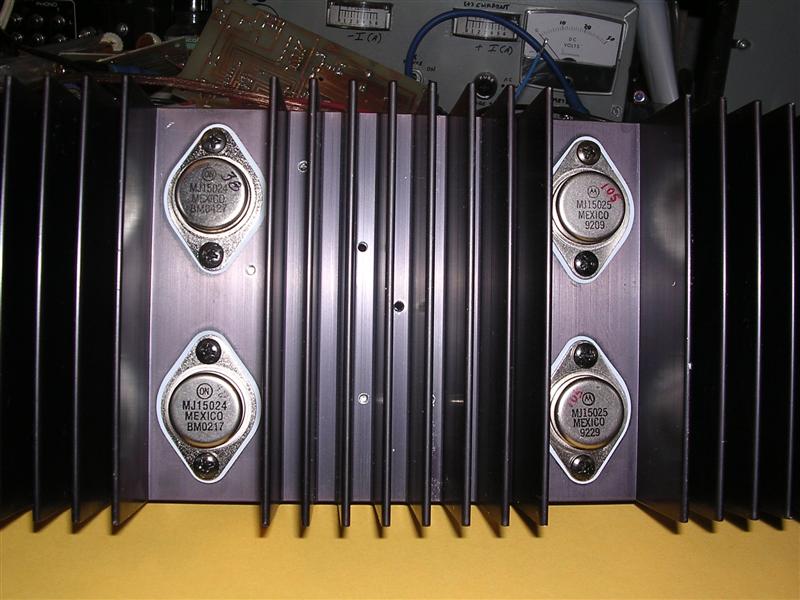

Hi Michael,
Wrong replacement by a mile! They are much older designs for one, and only good for 10A. These cause this amplifier to take a step back, rather than forward. Given that this amplifier is rated in the very conservative manner that Marantz is famous for, and that it has 3 dB headroom, no! I'll go as far to say that if you have serviced any of these amplifiers with 2SB600 and 2SD555, you should recall them and install proper output transistors. MJ15024 and MJ15025 will work better as long as you match them (actually, any outputs), or better yet, MJ2119x. These parts will be reliable and are also closer in technology.
My burning question is now very important. How did you make your substitution? Did you use a cross reference manual of some type, or did you look up the original specifications? If that's the case, what source did you use for those ratings?

Hi ostripper,
What I'm saying here is that the bias is controlled by selecting the transistor part numbers that satisfy the current, power and voltage requirements (and gain of course), but also balancing their Vbe drops.
Which brings me to another point. I have asked mechanicalman not to attempt a repair on this amplifier as he intends. I am truly hoping he considers my advice because these circuit types depend on output type numbers for more than simple specs we normally consider. I'm worried because someone who doesn't know much assumes there isn't much to repairing some designs. Once you know more, then you get an idea how much more there is to know. Everything seems so easy when you don't consider the details.

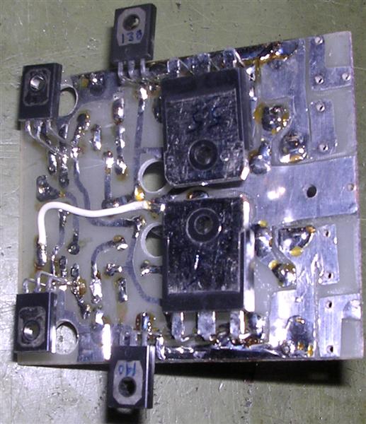

Here is a shot of a working prototype PCB using TO-3 parts.
-Chris

No, not so. It's the Vbe of the transistors that determines thermal tracking. R018 and R019 are matched for offset purposes. I have repaired some of these amps as well, they sound very good with that special property you like the sound of.What trips me out is there is no bias trim which leads me to believe they used precision resistors for r018/019
-Chris
..... and this is showing the outputs as running.
-Chris
Edit: These were to investigate the effects of different outputs. The newer On-Semi parts perform better. These have a mis-match between NPN and PNP beta, another prototype was built up using a mixed batch of 2SB554 and 2SD424 from Adcom stock I had. I selected the parts that differed the most from each other in beta. This of course to answer the question "how bad can it get?". The performance of the On-Semi set is better, and if you look, you can make out the beta values marked on the cases.
Looking at the previous post, you can see that the driver transistors are mounted bent away from the way the board was designed. This was only to use an amplifier "donor" that had TO-3 outputs in original trim. I wasn't about to design a new PCB for this.
-Chris
By anatech - The MJW0281A and MJW0302A
I use the (N)jw0280/0302, only $1.25 each and they definitely
give the most "bang for the buck" ,15A devices as well with
good models.
By anatech - but I seem to recall the entire diamond was mounted on the heat sink
Now that is interesting.. I simulated the nakamichi and It
was biased to exactly 60mA per device.. even with the
newer KSA/fairchild devices. Makes sense that all 4 devices
are the Vbe (just like 4 diodes) on the main heatsink.

Hi ostripper,
From a manufacturing standpoint, it's a wonderful circuit. You can build an amplifier that has no adjustments to be messed up in the field. Once you get things figured out, you only need to watch the trends in your supply of parts. Warranty shops can be instructed how to handle these designs. The average shop most certainly will make a mess out of these. No worries though, from what I've seen over the years, they destroy amps anyway.
I have attached one of my low power prototype PCBs to show the mounting of transistors. I have not yet applied full power to this one. I do know it works though.

Don't trust a sim in this situation. The transistors are not perfect and the thermal differences will throw things out. Any diamond buffer design needs some fiddling when there is no standard bias control circuit.I simulated the nakamichi and It was biased to exactly 60mA per device.
-Chris

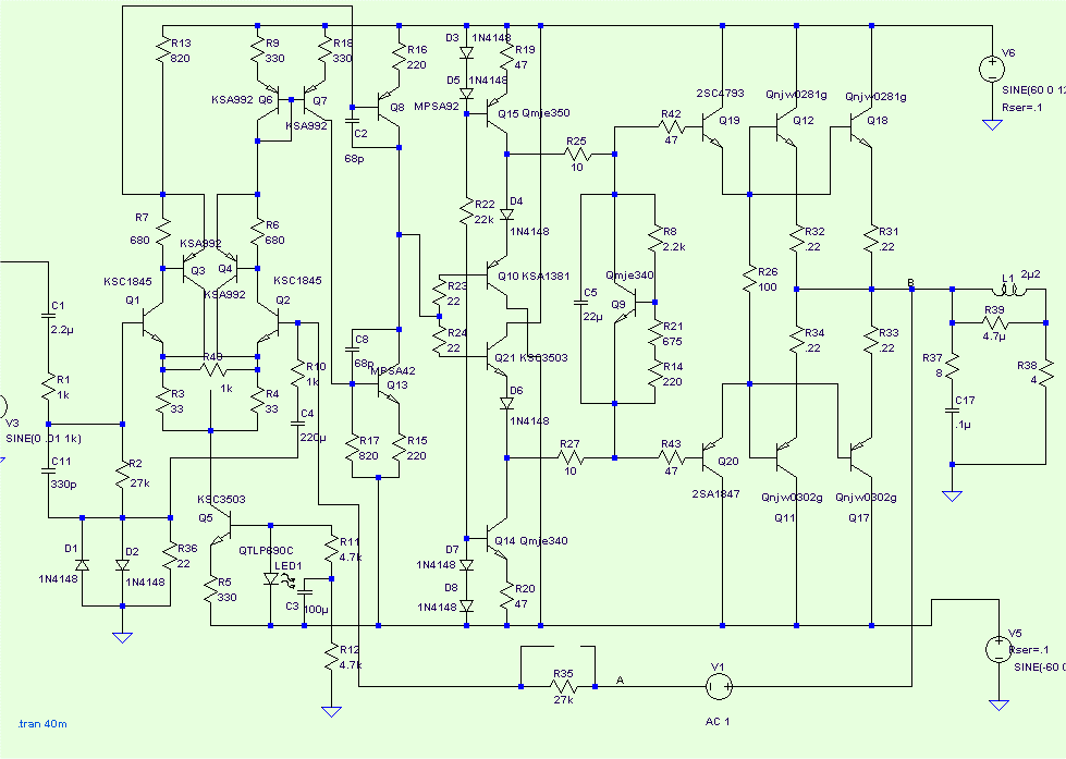

By m. chua - It is a very good design. Very similar to my Bi240.
{BI-120 "clone" with balanced widlar buffer VAS/LED CCS}
Yes , the bi120/240 was the inspiration for my frugalamp 2,
I did use a slightly different circuit as to not jump on your IP,
and njl 0280/0302's for cost/space considerations. It plays away
in the living room and sounds wonderful. Thank you for the
ampslab site (projects and classic SS amps) ,they inspired me
and brought me to this forum after I built a C200.
The marantz definitely is not a beginners project, (once I
"hack" it into frugalamp 4 it might be). Seeing how nakamitchi
and marantz use their access to consistant batches of
close tolerance components to base their designs on, I can
see where TLC in the repair of them would be essential.
Below in attachment is what I prototyped and is playing as I speak.😎
OS

I'd be interested to see where you go with a "power diamond buffer". If I can ever pick up where I left off, I'll post my results.
