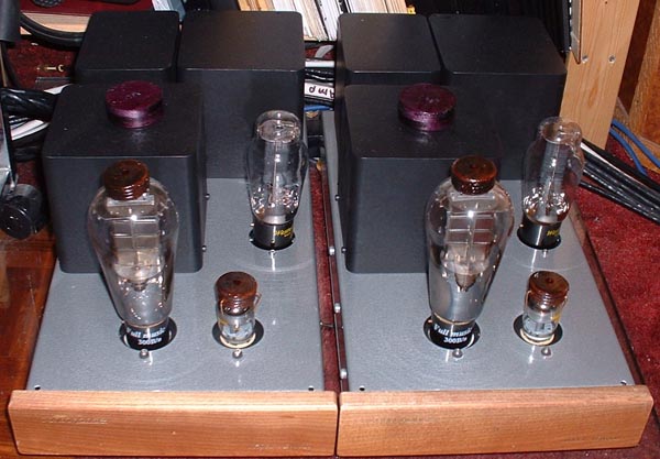

I want to DIY a 300BSE power amplifier recently, could somebody recomend or provide me a wonderful and robust schematic??? I will use Lowther PM6 speaker to match it.

There are many ways of creating such an amplifier. I have build more than a few myself, my latest (the Lady Day Plus 91) was already linked.
Oh no - YAWE91B300BA (Yet Another WE 91B 300B Amplifier)
An article that covers the fundamentals I wrote a while back is here:
Some thoughts about singleended Valve Amplifiers
I have since been able to research more a variety of small design tricks from the days when Valves where new (things like Gridchokes, the WE Cathode connection and other Hum/PSU Noise noise cancellation schemes) and this does impact somewhat on some of the recommendations, which as a result become somewhat more relative.
Here some details on some the variety of Amp's I build:
Another Lady Day Chassis (Schematic & pictures only):
http://www.arduman.com/aa/Resimler/thorsten/thorsten4/amp_schem.gif
http://www.arduman.com/aa/Resimler/thorsten/thorsten4/amps.jpg

My second Lady Day chassis build with WE437A shows the"economy" implementation of such circuits using self bias, WE PSU noise cancellation (this is as good as a regulated supply - try it) and parallel feed IT coupling (okay, we call it gridchoke coupling - same thing really).

here is a beautifully simple circuit from jc morrison:
http://tinpan.fortunecity.com/saints/668/primer/300b-se.gif
the quality of your parts choices will be quite audible.
