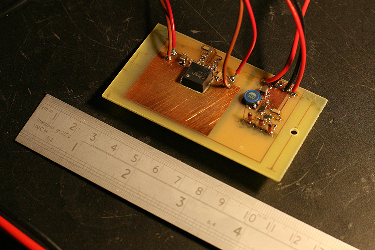

I am using switchmode supplies for the filaments in my 300B amp. They work really well. I am selling assembled modules as well as bare boards for DIY use on my website (Neurochrome.com : : Audio : Universal Filament Regulator). These modules have been extensively tested, both in the lab and in my stereo in the living room.
Unless you are using several 300B tubes in parallel, you will need one regulator per 300B tube. For parallel tubes, you can run two tubes off of one of my filament regulators.
