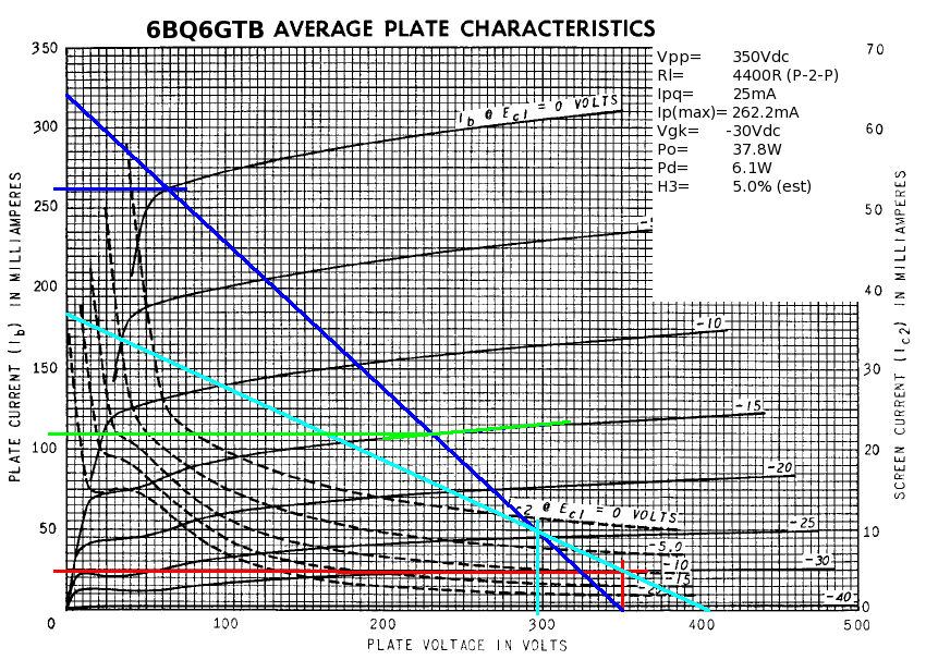

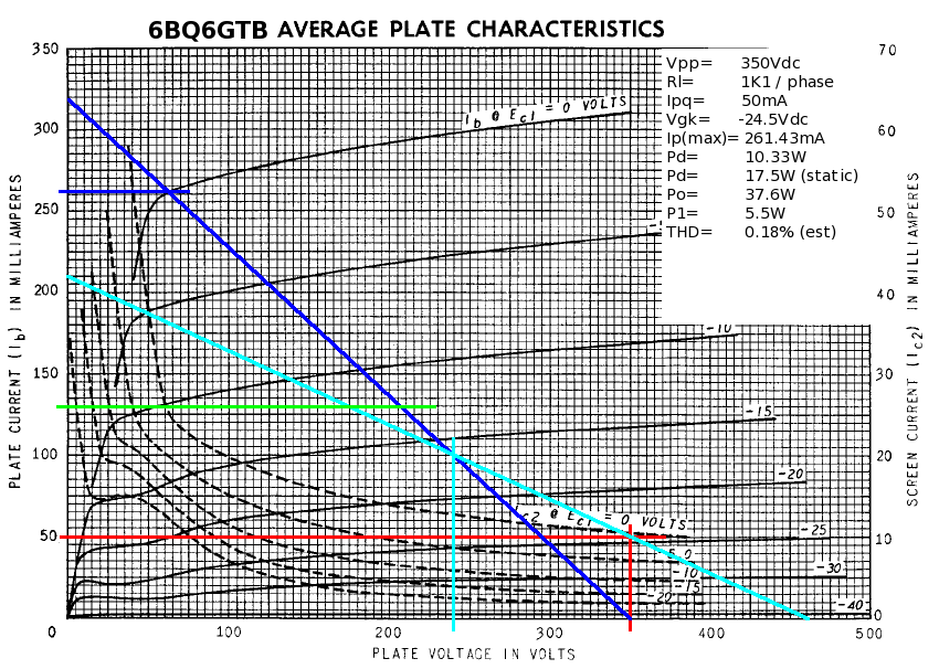

I've seen that happen before: with a project that uses 6BQ6GA/GTBs as PP finals. The original design called for: Vpp= 350Vdc with a bias of 25mA per final. That gives a Pd= 8.75W, safely under the rated Pd= 12W. That sounded OK, but busting the spec by running the bias up to 50mA/final (Pd= 17.5W) definitely helped the sonics. Loadlines tell the tale (attached). Running hotter greatly reduces the THD, and the 6BQ6GA, being a TV horizontal deflection type (no audio use specified in the spec sheets at all) has very conservative ratings, so this spec-busting does no harm. (BTW: These sound really good -- much like the famous 6V6, but with over twice the output capability.)
