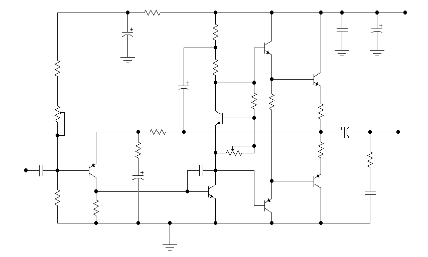

What's this amplifier? There is a schematic around?
A good example is the standard east german 25W "HiFi" amplifier, capacitor coupled output and all...
Something like that?
Konnichiwa,
There was very little unusual about it. Classic 6-Transistor circuit (many variations of this where around in the 1960's & 70's), NPN only output devices, fairly high level of Bias, single rail, input and output coupled via a capacitors (electrolytics - no less), clever feedback loop, bootstrapped load for the second stage, both voltage amp stages using some local degeneration too. I fixed so many of these, I could nearly draw out a circuit diagram from (> 15 Years old) memory.
Nothing too unusual, it just sounded very good. Combined with an passive EQ circuit and a KSP215 8" Full Range driver these drove for example east german Radio/TV Monitors and these things where darn good.
Actually, managed to find a schematic that is basically what I am talking about.
Sayonara
plovati said:If Your intention was to raise my ears, You're succesfull !
Sayonara

PMA said:Where is the schematics from?
East German HiFi 50 (25W+25W) Amplifier.
The whole Amp is an illustration of old style, politically incorrect design, which did not stop it from sounding rather good, with reasonably sensitive speakers anyway... ;-)
Sayonara

Pavel, You prevent my question.
Is this schematic replicable today, replacing the output transistor with 2N3055 and driver with BC5XX for example?

plovati said:Is this schematic replicable today, replacing the output transistor with 2N3055 and driver with BC5XX for example?
I am sure it is, however D. Self did a lot of work identfying the most linear devices for the various positions in his "blameless Amplifier" series in Wireless World, while I disagree with DS on about evererything, I agree with his choice of devices, for very different reasons though.
Sayonara
