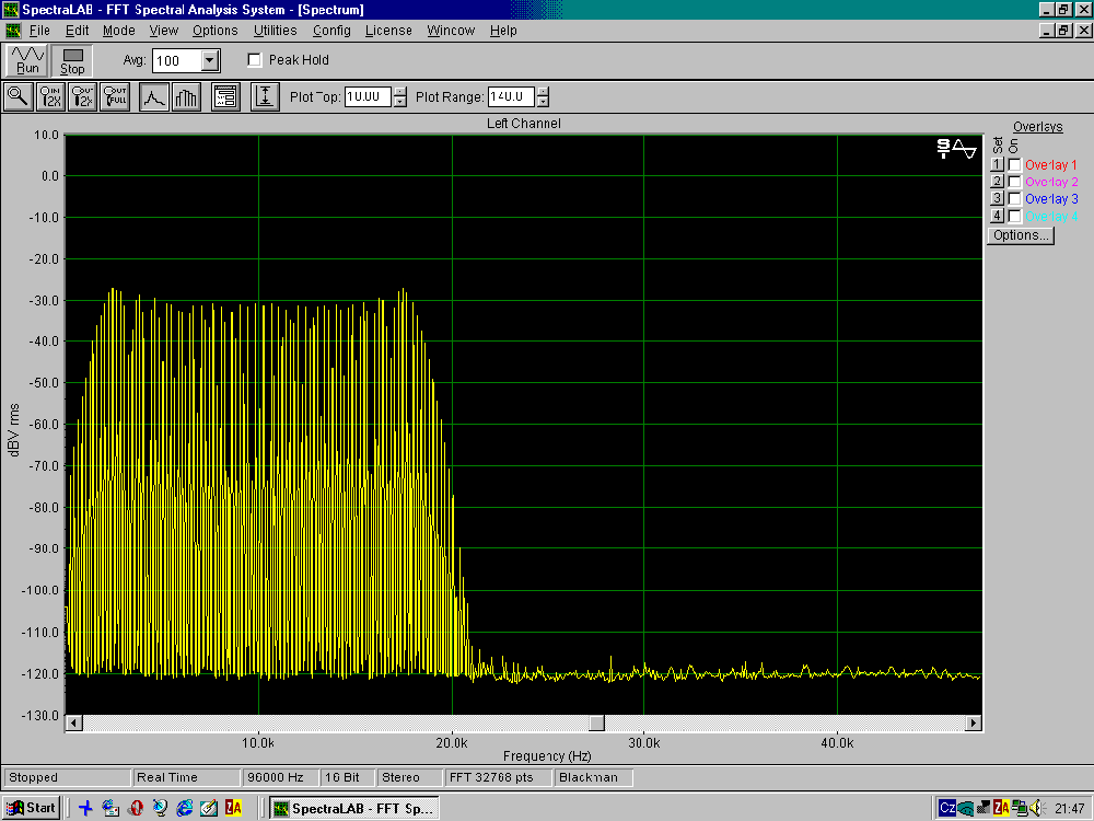

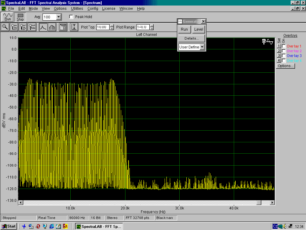

New sets of measurements were done since it had been discussed before. Here is the result of my FM method - firstly input signal.
