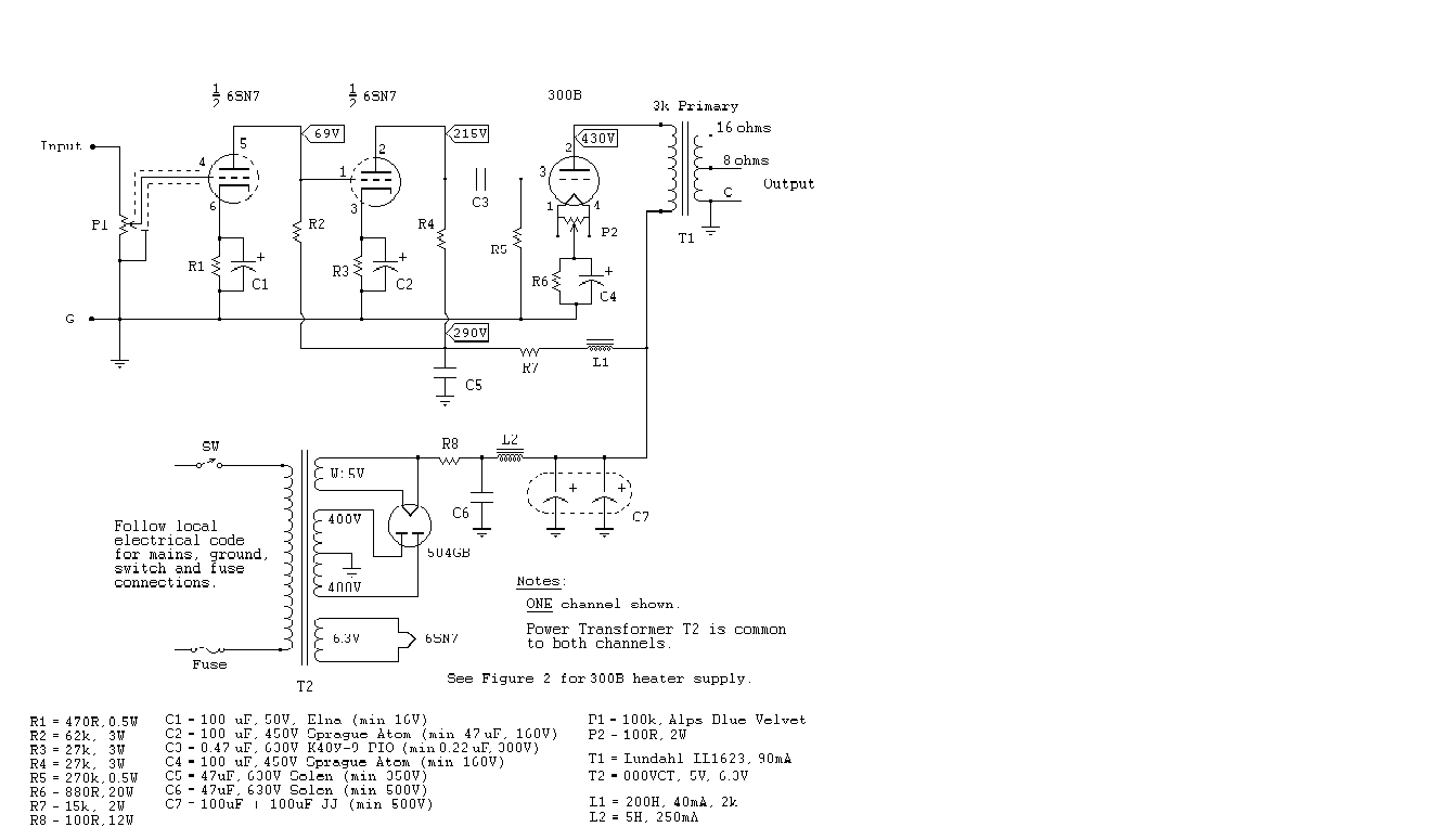

300B SET
Hello everybody, recently I started working on my 300B SET amp. I kinda need some Layout Ideas for this, if anyone could share some it would be great! Cheers from Croatia!

I'm preety new to the whole thing and I know that the transformers must be at the 90 degree angle to one another but like haven't found any tips on caps and such, heater supply also, do you have any advice on how I should I do that? Point to point construction of course.
300B SE Amp
Hum reduction:
Use an aluminum chassis.
Magnetic steel conducts magnetic fields from the power transformer and B+ choke to the output transformer.
If you must use a magnetic steel chassis, elevate the SE output transformer off of the chassis with spacers to reduce the magnetic fields to the output transformer. A 1/4 inch of space should make some improvement of hum levels.
Some kinds of stainless steel are not magnetic, or only mildly magnetic.
Put the power transformer(s) and B+ choke at one end of the chassis, and put the output transformer at the other end of the chassis.
Orient the power transformer coil and B+ choke coil in one direction. Then orient the output transformer coil at right angles to that of both the power transformer and choke coils.
Your schematic does not show a filament winding for the 300B. Do Not use the same 5V filament winding that the rectifier tube filament uses. That will burn out a lot of parts and circuits.
You could use the 6.3V winding, and two series resistors, 0.5 Ohm 3 or 5 Watt each.
Wire from one end of the 6.3V winding to one end of the 0.5 Ohm, and the other end of the 0.5 Ohm to pin 1 of 300B. Wire from pin4 of 300B to one end of the other 0.5 Ohm, then the other end of that 0.5 Ohm to the other end of the 6.3V winding.
That series circuit is: start of 6.3V, 0.5 Ohm, 300B, 0.5 Ohm, return of 6.3V.
Or, you are going to need another transformer to power the 300B 5V filament.
The hum pot on the filament will allow you to null out some of the hum. That gets you up and running.
But you probably will eventually want to use a floating 5VDC supply for the 300B filament. That will reduce the Intermodulation of 2 x the line frequency on the test sine waves, and on the music notes. 50Hz power x 2 = 100 Hz intermodulation; 60Hz power x 2 = 120Hz.
You could start with a floating 5VDC supply, but that does complicate your fairly simple and straightforward schematic (does not change anything on your schematic, but adds the circuitry of a filament transformer, solid state rectifier, filter caps, resistor, and another filter cap (CRC).
Now, lets prevent a major cause of hum: The B+ ground loop.
Connect the B+ high voltage secondary Center Tap directly to the negative lead of C6.
Connect a wire from negative lead of C6 to both negative leads of C7.
The point is that you do not directly connect the center tap nor the negative lead of C6 to the central ground point of the amplifier. But after you connect the negative of C6 to negatives of C7, only then do you connect the negatives of C7 to a central ground point.
The central ground point is where Most the grounds and returns connect.
You also connect this central ground point to the chassis. That shields the other circuitry.
Connect the following to a central ground point:
The negative leads of C7; bottom of R3 C2; R6 C4; the negative lead of C5; the Chassis; the Common of the output transformer secondary; and the bottom of R1 C1.
Use insulating shoulder washers to isolate the RCA phono input jack from the chassis. Then connect the outside of that RCA jack to the bottom of R1 C1.
The reduces the input ground loop.

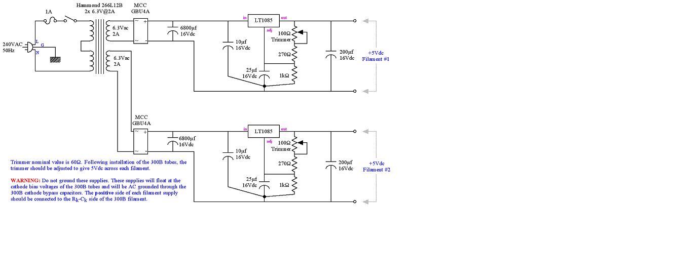

I was thinking to solve the problem of 300B floating 5VDC supply with this schematic that I attached. I'm running 230V 50/60Hz Mains. I made a wood chasis and was thinking about placing aluminum plates on top and bottom if that makes sense? Can you maybe show me more in-depth about that major cause of hum and the central grounding point? Thank you for such an resourceful comment.

I may need some more time to research and better analyze that dual 5V supply.
Just look below and see what needs to be checked:
Correct, Dual is required, so that for a stereo chassis, you have individual self bias for each 300B.
You are moving in the right direction.
The issues are:
For 1.25A filament, the secondary should be about 2 times that, or 2.5A rating to keep the transformer from getting hot. AC and DC current ratings for a secondary are not the same.
The shotkey bridge has to be a low voltage drop version.
The IC has to have enough difference between its input voltage to output voltage, or it will not regulate (low drop-out chip).
The IC has to provide much more than 1.25A during power-up, because the filament is cold, and has lower resistance, draws more current cold. If the IC will provide, say 2 Amps, it will eventually warm up the filament, and then the current will drop to the tubes 1.25A. That can work, but if the IC has an automatic 1.5A current limit that may take longer for the filament to heat, an it also depends if it will keep providing 1.5A until the filament warms up.
A 6800uF cap at 50Hz line frequency has 1/(2 x pi x f x C) capacitive reactance, that is
0.47 Ohms.
At 1.25A operational filament current, that is 1.25 x 0.47 = 0.588V peak to peak ripple.
At 2A start-up filament current, that is 0.94V peak to peak.
If the peak voltage from the bridge and the 0.94 is to low for the required voltage at the input to the integrated circuit, versus its output voltage, the IC may drop out.
A larger input capacitance may be required to keep the peak voltage minus the ripple voltage at a level that makes the IC work.
Do not forget to heat sink the ICs.
Parts with real good specs are required to make this work well.
It has to work with the power main voltage when it has at its high level.
But it is harder for it to work when the power mains voltage is at its lowest level.
My mains vary from 117V to 123V. I design the filament supply for 120V.
I use a 6.3V secondary, shotkey diode bridge, and a 22,000 uF cap, a 2 Ohm resistor, and another 22,000 cap in a 'brute force' CRC filament power supply. The ripple is 1 to 2 mV. I do not even have to use the 100 Ohm pot, just two 25 Ohm resistors from the filament ends to the top of the RC self bias network. The transformer filament winding is for up to 3.5A, and has about 6.7V instead of 6.3V, and I adjust the 2 Ohm resistor accordingly for 5V across the filament.
Because there is no IC, dropout can not happen.
This is intrinsically a soft start filament power supply, because of the low resistance of the 300B at power-up, and the 2 Ohm series resistor.
Works for me.
You can use wood sided construction and metal top and bottom plates. Be sure to connect the top and bottom plates together for safety and for hum control.
If the first capacitor does not have enough capacitance, there will be too much ripple to the IC, and the voltage to the IC will drop too low.
The output has to be 5V.
Start with what the peak voltage to the rectifier diodes is.
6.3VAC = 8.8V peak to the rectifier diodes.
A diode bridge has 2 diodes in series for every alternation.
https://www.analog.com/media/en/technical-documentation/data-sheets/108345fh.pdf
You can see the required voltage for the LT-1085 that you picked. It needs at least 6.5V input to get 5V output.
That means the ripple voltage from the first filter cap, must never drop below 6.5V.
You have 8.8V peak, minus two diode voltage drops, and minus the ripple of the first capacitor.
The application sheet below shows a 10uF first cap. I bet you will need at least the 6,800uF first cap that is in your schematic.
That depends on the DCR of your filament winding, and the drop in the diode bridge you have.
The GBU4A bridge you selected has a 1V drop at 2 Amps.
In order to get 1.25A at the IC, the first capacitor draws quite a bit more than 1.25A, it could easily be 2 Amps peak.
The 6.3V secondary provides 8.8V peak. The bridge drops 1V from that, so now 8.8V -1V = 7.8V.
6800uF is 0.47 Ohms. 1.25A through 0.47Ohms drops 0.59V, at the low point of the ripple.
7.8V - 0.59V = 7.21V.
You may have enough margin to get your circuit to work. We can not tell, because we do not know the power mains voltage range, power transformer rated primary voltage, primary DCR, the secondary DCR, etc.
But it appears you have enough margin.
