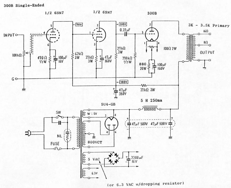

I've been building 300B circuits for the last few years. My favorite are the Western Electric 91A (Sound Practices version) and Fi Primer 300B.
Currently on the breadboard is a WE91A that's closer to the original, using only the second 310A (or 6C6) stage and not incorporating the feedback, except for the 1uF bootstrap filter on the output stage. I like it best so far, I think.
One nice thing about the Fi Primer circuit is that it has enough gain (about 0.25V input sensitivity) that you don't need a line preamp. Just put a volume pot after the input jacks and plug in a source.

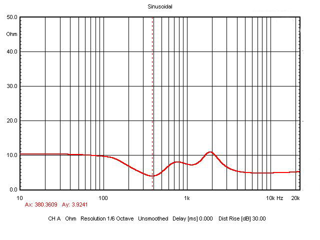

Attached is the impedance curve for the speakers I plan to use this with.

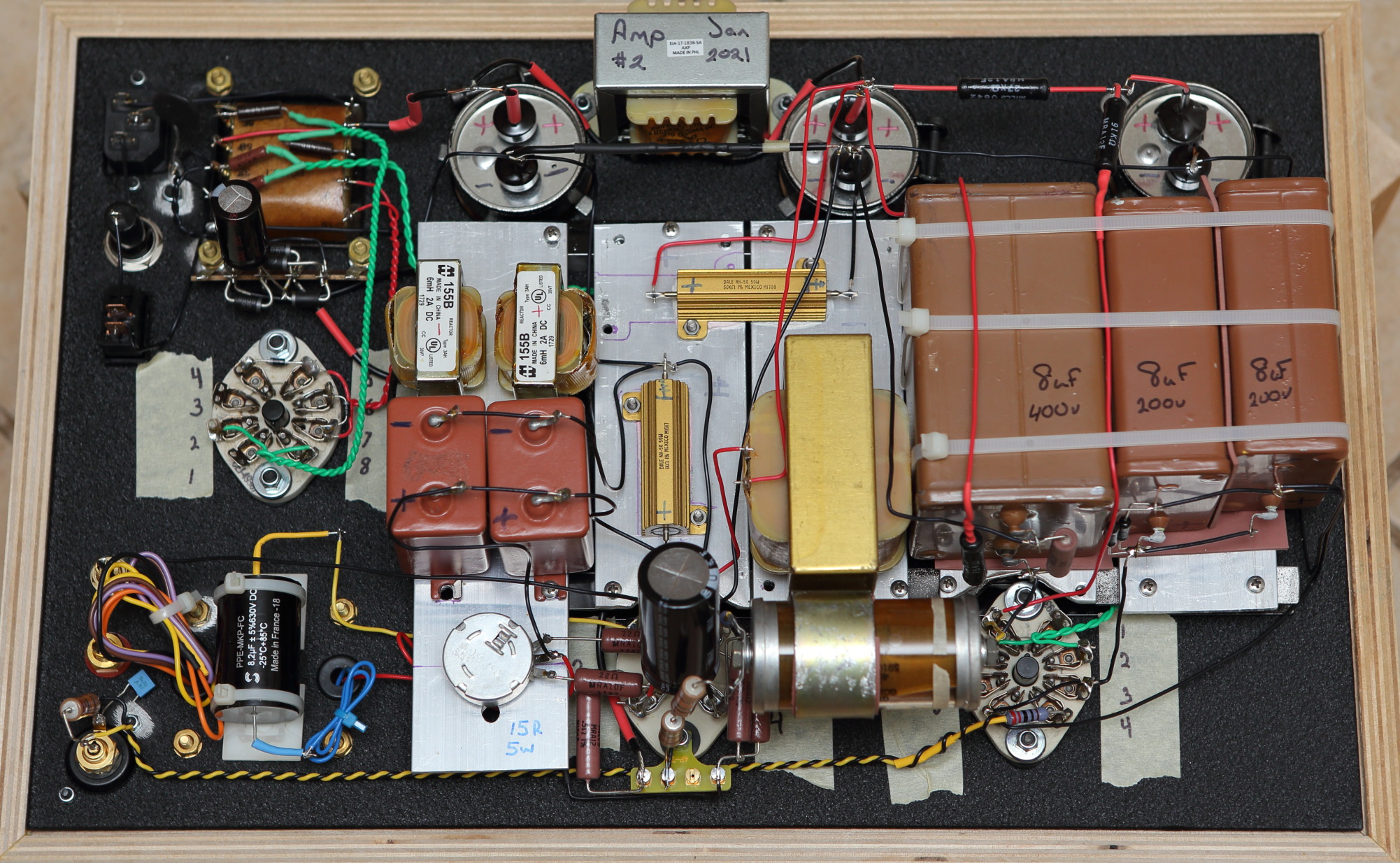

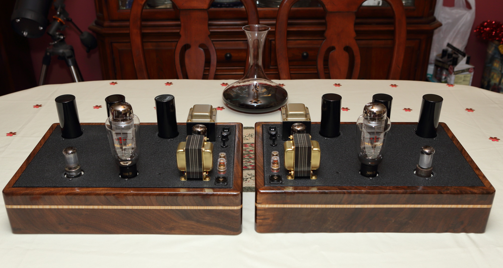

I built a parafeed version of the WE 91 300B amp that Joe Roberts published in Sound Practices back in 1992. This version was created by Paul Joppa, who works at Bottlehead. The total cost fits what you asked for in your first post. You'll need a bit of leg work to track down the transformers (original iron was all MagneQuest stuff from Mike), but that's half of the fun!
Schematics for the design are about half way down this thread.

The low frequency impedance curve looks too good to be true; is this a complete measurement??
My new speakers are a two-way line source design that uses planar drivers. The midrange driver rolls off at around 180Hz, so a single pole filter is used in front of the amp at approximately the same frequency. The lower few octaves are handled by a separate powered servo subwoofer (one per channel).
Eric,
Excellent work! How are you liking them?
