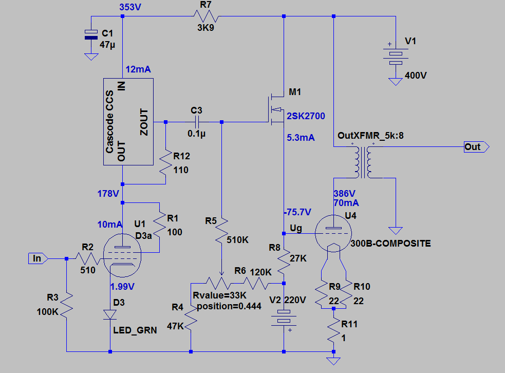

So far I didn't know ... and my tubes too ... and my 10W A2 capable 300B amp living now since more than a decade. 🙂The 300B hates positive grid voltage as you know...
And yes, I outwear two pairs ... each time one in pair has heater break... over about 5 years (at least 5*365*4-5 hour) working. I think it's close to the "normal" worn out.
And yes, most of 300B tubes (especially mesh anode ones) unsuitable working with grid current, but robust metal anode ones (I like using such way gold grid EH300B) perform well.
Well, do you have some curvea or grid current figues to share in positive grid condition?
It's -my- practice for decades.
Sooner with cathode follower, later with FET source follower (better, more defined lower region).

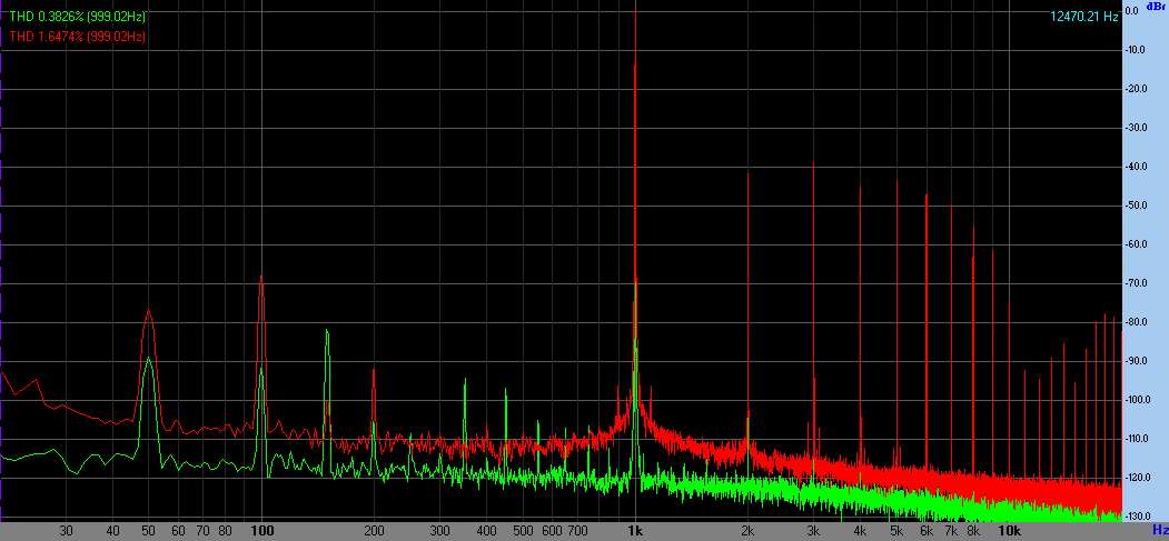

Up to +20...30V the appropriate (for example EH) 300B tubes capable 10W output power at not so hot operating point (385-400V, 70mA) with 5k OPT.
Attached the 105V RMS gate swing FFT (0.38% THD) and 10W output FFT (THD 1.65%).

Bela what OPTs and schematic are you using for gold grid EH300B?
It's the original schematic (at least a decade old):
It's a custom wound 5k:8 transformer, but any appropriate 4-5k, 70..80mA 10W transformer usable.What output transformers are you using?
I made this type amplifier to my friends with Lundahl, Transcendar or Tribute transformer so.

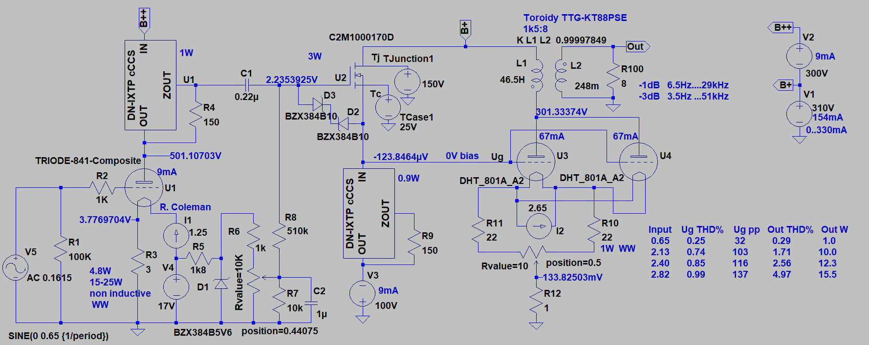

Do I read your schematic right ...1k5 primary for two 801A in PSE ? What rp do they have ? 4k, so two have 2k...no ?
I liked the triode load line simulator as it actually gave you the option to play with different imoedances, bias point and simulated as well the distirtion spectrum and level for the selected input sinus level. There are some bugs that you have to change the input level always a bit to get accurate distortion figures, but once you figure that out its a pretty powerful tool.
