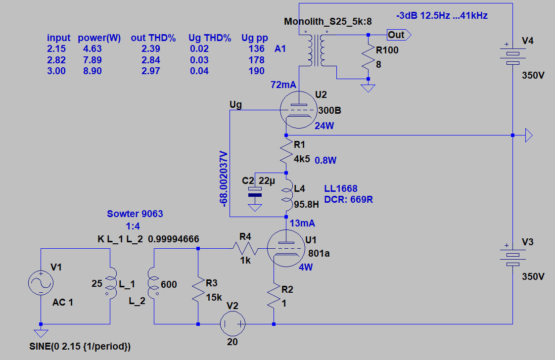

Not 300B in output, but my driver for GM-70 is:
3A5(parallel) - 4P1L (triode connected) - IT - GM-70.
All tubes with fixed bias. Working on CCS for 3A5.
I'm very satisfied with the sound. Measured on R&S UPL, driver stage is very linear.
I'm sure you can use this for info for your build.
Regards
Regards

Some years ago I played with same schematic.If successful, I could see this being a really neat 300b amp that may solve your sonic issues.
The most important thing (I you use appropriate parts) is the driver tube anode choke.
If you use average, mediocre anode choke the result will be so mediocre.
Interesting. Thanks for the heads up.
When I have money again, I was planning on trying these out for a 10Y preamp. Maybe they would make good plate chokes for the circuit in question? Shrug.

BTW 80H is "enough" for 10/801 (about 10k load at 20Hz), but interwinding capacitance is the most important thing.
P.s. C2 is reversed if it is polarised cap (I used polypropylene).

I am driving my 300B/842 currently with a 801A. IT is 1:1.
The DAC is a soekris and got as well a 801A, so input is 18Vpp...a bit more than what you got...which DAC do you use btw ?
I tried a LL7903...this is really a bad sounding device. Save your money.
I would instead ask our friend 50AE to wind an IT with 1:2 ( see here DHTRob - An AD1 preamplifier with Alexander Naydenov transformers ...I compare his 1:1 nano with monolith nano 1:1 and prefer 50AE.... and run them the 801 with 30-40mA for transient response.
Or use a 841 with the gyrator board...or maybe with a mu-stage ? The new version with reduced complexity or choke ontop of the 841 anode ? Or have a deep look into DHT which are typically overseen...there are some...

Good question - which DAC. I have a ES9023 right now. The application question could be solved in different ways in the DAC if it could provide more than 2v output. Possibly even some kind of solid state step-up device like a J-FET or whatever. My knowledge base is tubes, so solid state is a bit out of my comfort zone, but feel free to suggest.
"The ES9023 is a 24-bit stereo audio DAC with an integrated 2Vrms op-amp driver."...from their web page...op-amp...
So, I would try to get rid of the op-amp stage and use a DAC with a tube stage instead ;-)
So, we have 2Vrms, which is 5,8 Vpp, no ? We need 180Vpp for the 300B when it is biased at -90V. so a gain of 31.
To be honest, I would do it the same way i did it, which is universal tube output stage for the DAC and one stage infront of the end tube. Both 801. With this configuration you can play around with otherDACs and tubes as well, be it driver tubes or end triodes...use of IT vs. C-coupled stages etc. I will test next 814, 813,845, 211, 828, gm-70...all with the same topology, but with different voltages and appropriate OPt. I found that even within the 300B family there are big differences in resolution and tone.
Initially I have built the 801a dac output stage as a differential stage, so with four 801 and a cascaded current source, so that you connect the grids straight as well to current output dac like es9028, es9038. The grid to ground resistor does the i/v conversion. No C or IT in the signal path there...and than a LL1692AM as output transformer. doing PP to SE.
I converted to SE later as I find the distortion spectrum more natural and the Soekris is Voltage out anyhow.
A 841 stage with gyrator board or mu stage might work, but i would not forecast its microphony. Some 801A are mor microphonic than others and the 841 might be worse.
In my 841 collection the ST ones (all Hytron, except one pair -maybe rebranded Hytron- RCA) are not tend to microphony (the worst ones are dead now with filament crushing), but globe pairs (Deforest, Taylor) are most sensitive to vibration.
These tubes age are 80-90 years, so socket damping and suspended sub chassis for sockets is mandatory.
BTW the 801 in the DAC stage and 801-300B is the three stage solution. 🙂
