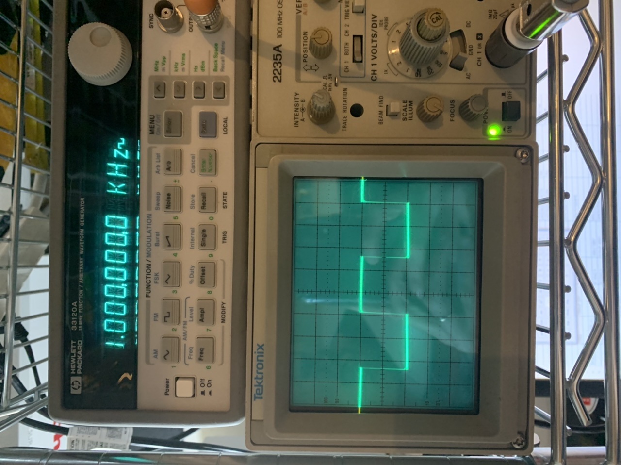

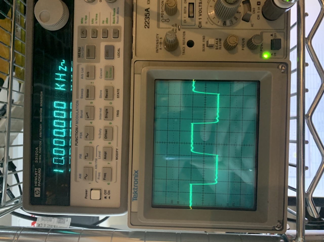

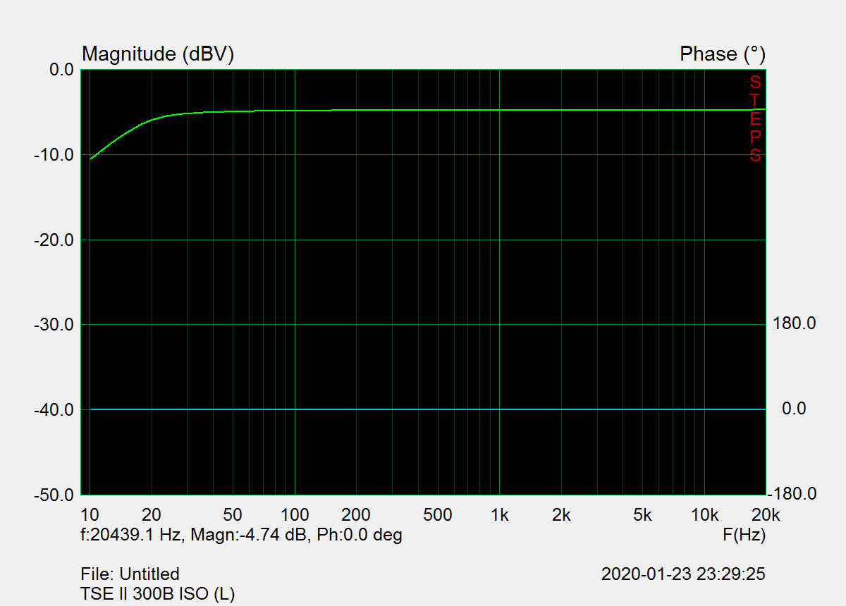

Thanks justmikey, missed your post but that’s what I ended up doing.
The ISO are installed and working nicely.
I ran a square wave and FR measurement in ARTA.
Different circuits but comparing to this shootout,
http://www.tubesoundelectronics.de/tabellen/messtabelle_ot_etf2009.pdf
Looks like the ISO are very good to excellent performers?
Can someone explain how to evaluate the HF resonance and overshoot as was done in the shootout?
