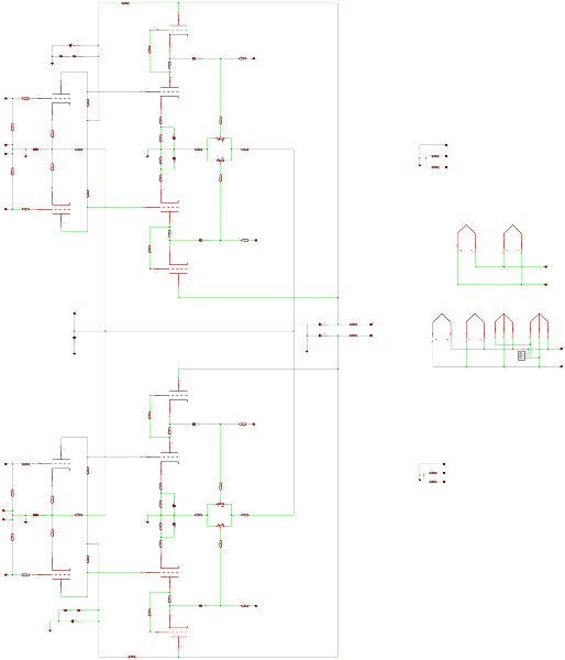

Hi Tony,
I just sold my James 6113 and am considering a Tamura F-783 which is 5K and 100mA. I'm looking at 400V for the 300B for the B+
Another option I'm looking at 5842 for the 2nd differential stage.

Arnold,
Look at the 300B operating conditions chart. Assuming the Tamura F-783 is 5 KOhms, end to end, indicates operating a 330B with 400 V. on the plate, -84 V. on the grid, and IB = 80 mA., for a 12.5 W. O/P. Unfortunately, the F-783 can't take 160 mA. (2 tubes) of idle current and the operating conditions rate to shorten tube service life.
IMO, you should use the chart to guide the selection of both O/P trafo characteristics and operating conditions.
hey-Hey!!!,
I don't feel like worrying about SE circuitry, but PP 300B can be done quite simply. Stay Class A, and run 7-10k a-a of load. There's lots of Iron that will stand a 300B idling in each half. 5 to 6k6 would also do OK, but you'd absolutely want to stay class A in order to stay away from running a 1k2-1k5 load when one side cuts off.
At this level, I'd trade a 20% power cut for better damping any day to run a higher numeric load.
cheers,
Douglas
Here's what I have so far-
The driver stage is 417A/5842 (I have a couple of them, and I like their tone), and as much as I would like to direct cuple to the next stage, I don't want a high negative supply for the succeeding 6BX7 differential pair.
The 6BX7 are running at 10mA @ due to the limit of the LL1660S/10mA.
If I can't get a 6BX7, I'd put in a 5687 in that position.
Comments? Positive or negative are more welcome 😀
Isn't that 10 mA spec. for SE use of that IT? I think one of the local chaps is using a minimum gap 1660 as a plate load on a differential stage at substantial current to drive 813's.

Hi Douglas,
I checked the LL1660S/10mA specs again, and it said Primary DC current for 0.9 Tesla for PP-PP is - 😕 and for SE-PP is 18mA.
How much current did your friend passed through on the 1660S?
Hi Tony,
Yes, my bad... the 6BX7 bias alone is alreadt -18V :smash: I did not mean to interchange from 6BX7 to 5687, so the operating point will change. Nobody has replied to me on the LF: 6BX7 on our local forum 🙄
I am disappointed that the Tamura F-783 being sold to me is over-priced. The brand new one from EIFL is US$265 only.
Anyway, my quote for the James 6233HS (100mA/side) arrived and I'm highly considering it for this project.
With respect to the output stage, I can recommend running them as a differential pair. In my experiments it was clearly better than either fixed or cathode bias in Class A, simply stick a CCS under the output pair.
The amplifier also used an interstage transformer with split secondary windings for the output stage bias, just as you propose. What you could do is sit the CCS on top of two paralleled pots, wipers to individual grid return windings.
The CCS keeps the voltage across the pots constant, and with some suitable value you can easily get the necessary bias volt adjustment to balance the idle DC currents. The pots are (to my visual) out of the AC signal current loop. I ran it this way for quite a long time and it was stable and sounded excellent.
The only other comment is if you want to go with AC filament supply, consider the 2.5vAc filament JJ 2A3-40. Super quiet with just a simple CT on the filament transformer, they bias up like a 300B. Something that you might not get with a 5vAC heated pair of tubes, but you might get lucky - for a while or otherwise.
In any event, enjoy it. Whatever you build will sound great!
