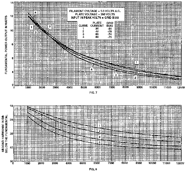

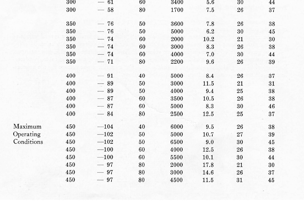

You have asked a question about what plate voltage, what plate current, and what output transformer primary impedance.
Once you have picked an output transformer, we have a starting point.
But then best answer to the plate voltage and plate current requires more to be known about your Horn Loudspeakers.
You already do not have to worry about the 300B output power with 100dB speakers.
1. What is the range of impedance of your speakers versus frequency?
And,
2. How high of a damping factor does your woofer need to keep from "flopping in the breeze"? (An un-dampened woofer sounds awfully un-naturally booming).
If you have ever done load lines on a 300B curves from the data sheet, you can see the results of the 2nd harmonic distortion (look at the uneven spacing between the grid lines that the load line crosses).
And,
If you put the load line low on the curves, where the plate current lines are very curvy,
the plate resistance, rp, will not be 700 Ohms, it may be 1350 Ohms.
The difference in damping factor of those two on a 2700 Ohm primary would be:
2700/700 = 3.86 pretty good
2700/1350 = 2.0 pretty poor
Now, looking at the STC charts in the earlier posts (from the 1950s WE charts):
250V plate to filament
-48V grid to filament
60 mA plate current (0.060A)
2700 Ohms output transformer primary
4.1 Watts output
-30dBc 2nd Harmonic distortion
And,
250V x 0.60A = 15W plate dissipation (long long life), and not heating the whole area around it.
300B max quiescent current, 100mA; max plate to filament voltage 400V or 450V.
Purchase an inexpensive 300B for initial amplifier power-up and check out.
Purchase a mid priced 300B for listening.
And, it is not hard to get a single stage driver that can drive the 300B grid + 48V and - 48V (96V peak to peak).
Especially if you are using a CD player that puts out 2.1Vrms (3V peak, 6V peak to peak).
If the music CD puts out full scale, that is one thing.
If the music CD peaks only put out -6dB, less than full scale peaks, then the driver gain needs to be 32.
But if you only need 2.05 watts out for your speakers, and the CD max is at - 6dB, the driver gain needs to be 22.6.
If I had that transformer and was going to build a 300B amplifier, for 100dB speakers, I would build that one.
Now you will get many more who will want you to do it another way, that is OK too.
Pick one design.
I can hardly wait to hear how it sounds and works for you.

You might be able to get 8 Watts at -26dBc 2nd harmonic distortion (5%)
at 330Vp-f, 60mA, and 2700 Ohm primary. But probably more like 4 or 4.5 Watts at low distortion.
That is about 26% plate dissipation to output power efficiency, reasonable for SE triode.
