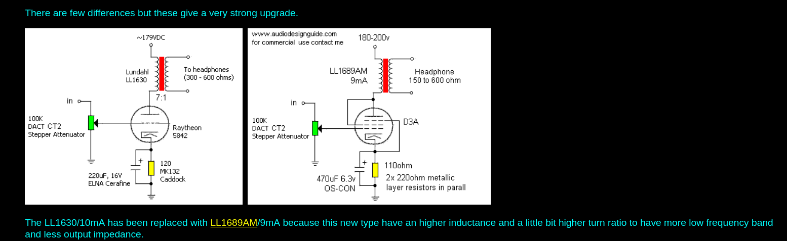

nicoch58 Member Joined 2004 2020-08-07 11:05 pm #21 2020-08-07 11:05 pm #21 or something small and fast audiodesignguide.com Attachments Screenshot_2020-08-08 Hi-end headphone amplifier.png 74.8 KB · Views: 132 A audiowize Member Joined 2005 2020-08-08 1:50 am #22 2020-08-08 1:50 am #22 You would definitely want grid stoppers with the 5842 or D3A. Prev 1 2 First Prev 2 of 2 Go to page Go You must log in or register to reply here.
