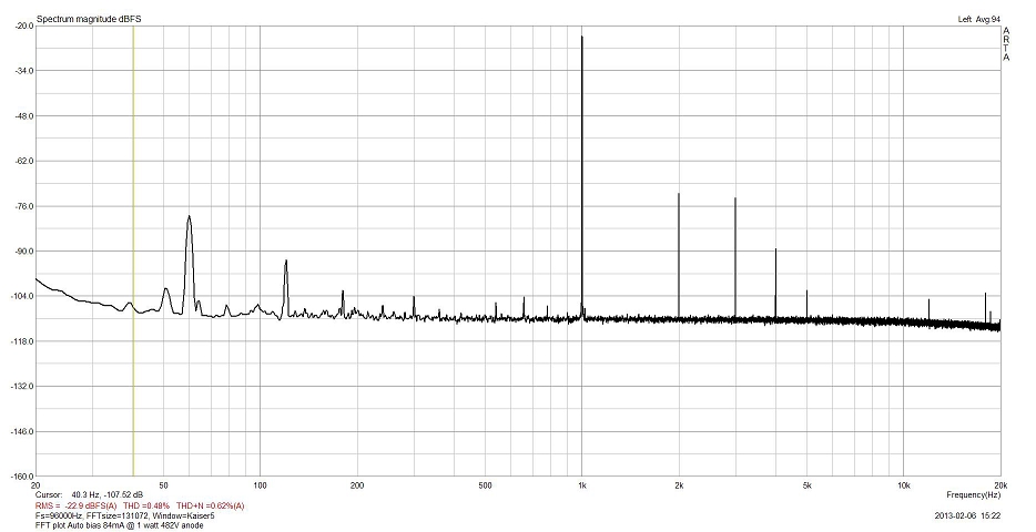

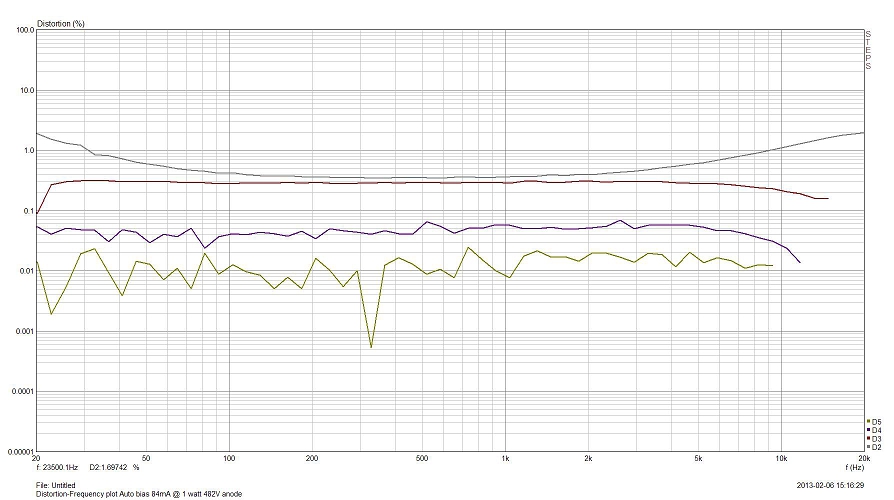

I am busy with my first built, a Herb Reichert "Flesh and Blood" derived 300b so 6SN7 GTB cascade. The power supply is of my own design, a low DCR design with four 5V3 tubes and a CLCLC with 150mH and 2.6H chokes optimized for low impedance and fast impulse recovery.
It is currently on auto bias but I will change that to fixed bias once I have the EML 300b-XLS (500VDC B+).
What do you think of the distortion plot taken at 1 W and 84mA plate current? Is it normal that the second harmonic is curved like it is?
Peter
I haven't looked at the individual harmonics in detail in my amp. But from your plot, the distortion is clearly dominated by 2nd and 3rd harmonics. That's the case in my amp as well. I would expect the THD to go up at lower frequencies as the OPT gets closer to saturation and any magnetic nonlinearities would tend to show here. I seem to recall my design with 6J5 having higher THD at higher frequencies as well, but I'd have to check my notes to make sure. Bottom line: Your 2nd and 3rd harmonics look normal to me.
In my current design, the THD is highest at low frequency, flat (at 0.15~0.2 %) from 200-ish Hz through 10-ish kHz. then it drops slightly at higher frequencies. The bandwidth of the amp is 32 kHz.
In your plot, the fourth and certainly fifth harmonics seem to be below the noise floor of your equipment. I'm guessing, but that's what the graph looks like.
~Tom
Yes, my 192kHz soundcard broke down so measurements were done with a 96kHz soundcard sampling rate. I just bought a second hand EMU 1616 as replacement but I am currently sailing in the Indian Ocean. I will be back home in three weeks time then I can do some better measurements and install the 300b-XLS and connect the fixed bias.

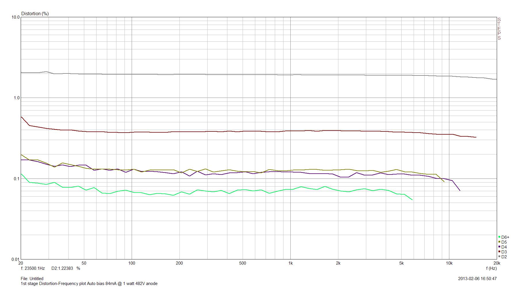

I have a Tentlabs bias module but did all my simulations with autobias not realizing that the Tentlabs is of course a fixed bias. Stupid mistake, now I have a anode voltage of 500VDC in fixed bias, to much for a standard 300B. The EML 300B-XLS should work well on that voltage.
The low 2nd harmonic at the mid freq. band could be the result of cancellation, the 2nd stage 6SN7 actually has quite high 2nd harmonics distortion.
I can start a new thread if anybody is interested, as said the circuit is reasonable standard except for the low DCR power supply.
