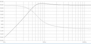

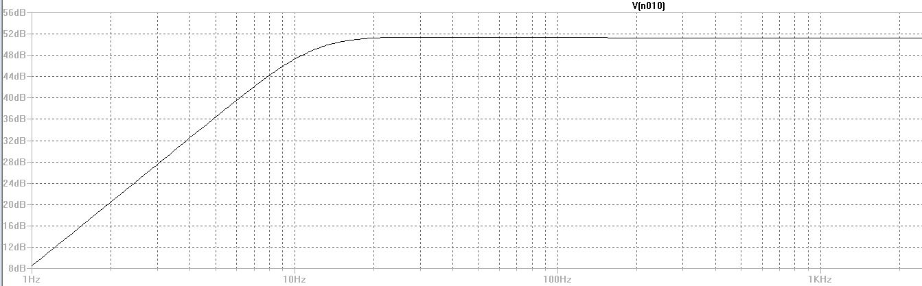

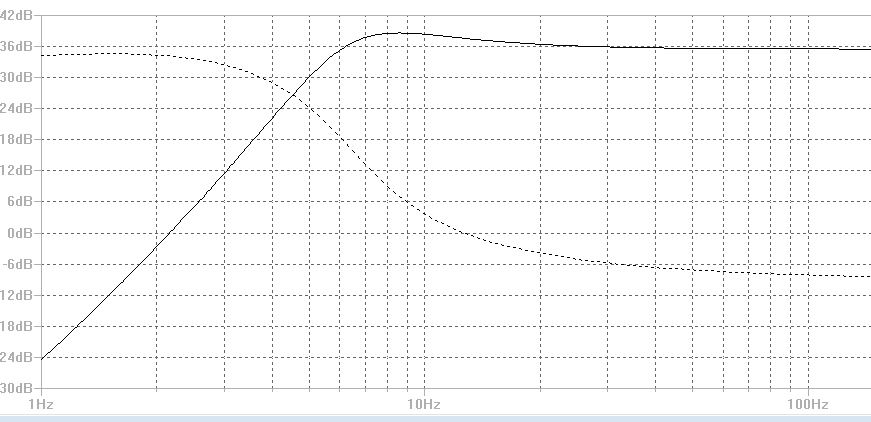

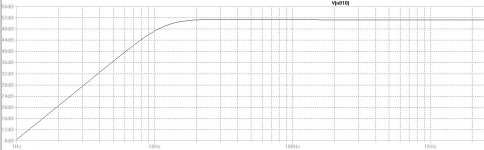

The LL1671 can be configured for 1:1 and is rated for 30ma, its 35H which is fine.
See the plot at 35H on the 300b
