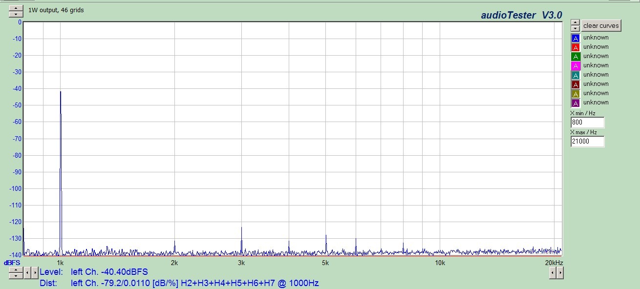

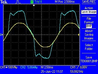

How did you measure phase imbalance on the *SN7 plates? Direct measure with 100X scope probes, one probe for each scope channel, looking at 20 kHz?
It has been a few years, but I recall having differential probes for each channel. No reason a 100X probe would not work similarly if you watch the probe and scope maximum ratings. AC couple the channels, put them in X-Y mode and look at the lissajous pattern. For identical phase shift between each, one expects a 45 degree straight line (ellipse of eccentricity = 1). If the phase shift differs, the pattern begins to open up into a more familiar ellipse, eventually reaching a circle (eccentricity = 0) at phase shift of 90 degrees. This is a convenient way to sweep frequency with your function generator at the RCA input, and see at each stage along the way how severe the shift becomes.
At the input transformer secondary (I had used both Tribute and eventually changed to Cinemag), phase shift was perfect. I could sweep from 10 Hz up to 40 kHz and always a perfect straight line on the scope. Magnitude was also very consistent, which is observed by noting the length of the straight line. It just never changed, it was like watching a static image. Although I knew little about the construction of the windings, no input transformer would be bifilar; they are built for high CMRR and often shielded. Therefore, a significant reason for the wonderful performance is actually the low capacitance of the triode grids and 3 inch interconnects. And I would add, similar capacitance on each leg. The load establishes the balance.
For the first interstage, I originally had O-Netics, and later tried Lundahl LL1692A. Wish I had a video of the scope pattern as I swept frequency - it was not only opening up into an ellipse, but it was not a good looking one! One edge of the ellipse looked reasonable, while the other edge was erratic (not a smooth arc). This indicated the presence of not only phase shift, but distortion was well. Based on which IT winding had the problematic stray capacitance, that SN7/7119/ECC99 plate was distorting, and distorting unequally between each polarity. Granted, looking at the IT secondary was poor as well, but for me, I could see the root problem was showing up at the plates. The load consisting of the transformer stray capacitance was simply too much for the triodes. Place the scope in Y-T mode and look at the sine waves on each plate; yep, clear visual distortion. How unfortunate, right? Whereas the input transformer did not burden the preceding driver, the IT was a large nonlinear and unbalanced load for its driver. Even with no load connected to the IT secondary.
I did further experimentation with the Lundahls, which allow a great deal of different winding configurations and turns ratios. Forwards/backwards, step-up/step-down, etc. No matter what configuration chosen, I could never get a lissajous pattern that was tolerable on any rational basis. They were just all over the place. Looking at the 46 grids, one grid was getting supplied with 5VAC, the other with 3VAC due to the phase imbalance. This is not how the stage was designed to operate!
Now, there was some corrective action when considering the end-to-end (differential) performance of the IT stage. Distortion improved, frequency response was better, though you could still see some degree of magnitude variation over frequency sweep. So by the time I get beyond the OPT and to the speaker, some of that problematic behavior gets canceled out. But why knowingly be generating distortion at each stage, hoping your output transformer cancels it out?
My conclusion was to dump the first stage IT and go cap-coupled to the 46. Put in the CCS as the SN7 plate load, and you get one of the lowest distortion circuits obtainable by tubes. Design the gain structure appropriately such that you never run the risk of blocking distortion or grid current, and the first stage is perfected. The amp was listenable at this point. The 46 does a much better job driving the IT than does the SN7, so I hobbled along knowing the amp was compromised. I ran it for a year or so until I discovered the Monolith offering of their bifilar IT. Gave it a try after some grueling rebuild efforts and was thrilled at the behavior. Pretty much behaves identical to the input transformer!
I never bothered to re-try using the Monolith as the SN7 IT, as I was pleased with the cap coupling. Might be an interesting experiment though.

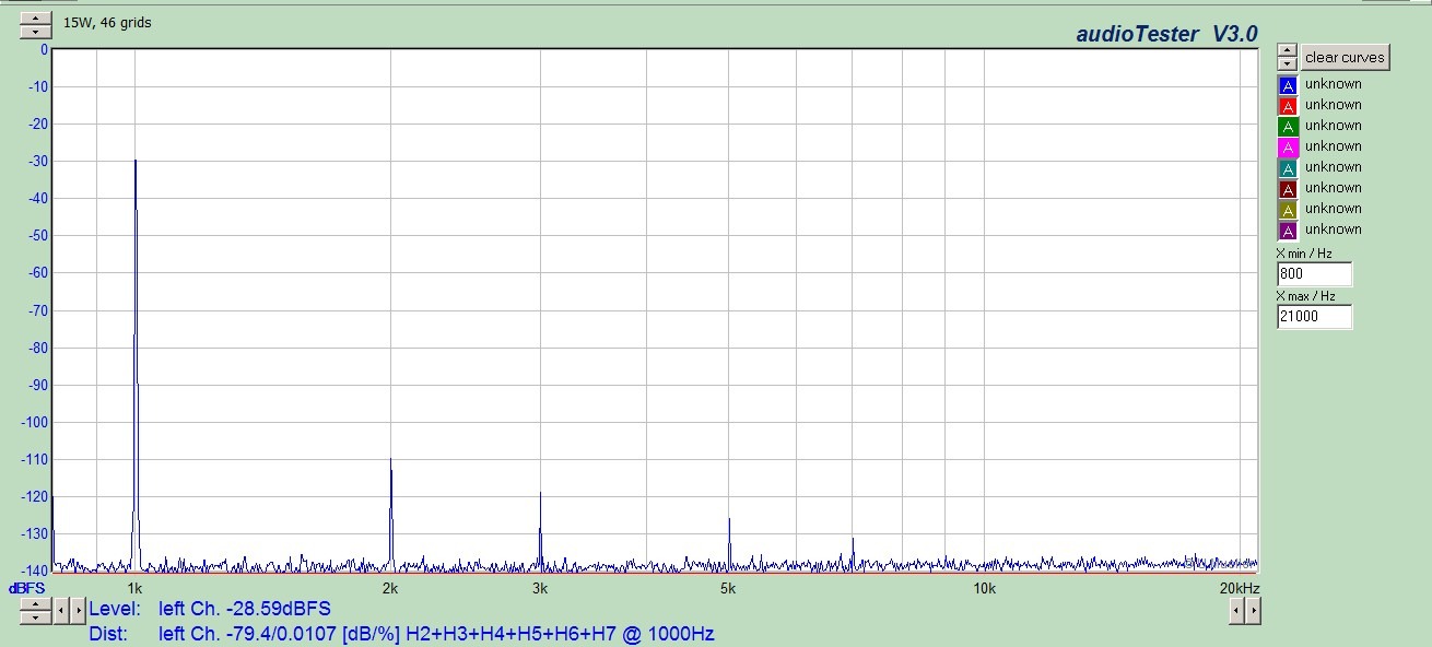

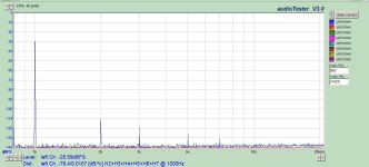

The Lundahls seem to have some sort of internal imbalance when used as ITs. One side starts saturating, which makes me wonder about internal symmetry, despite the external appearance.
Zigzagflux, which current sources (dynamic plate loads) did you find satisfactory? I found the usual ring-of-two transistors had a noticeable grainy coloration, as well as questionable sensitivity to high-voltage transients. But surely there are current sources better suited to HV vacuum tube applications. I sometimes wonder if a dual triode could not be pressed into service as the control element.
I'm asking in the context of the input tube, of course, so it is a high-Z environment with only +/- 15V of swing to deal with.
Lynn,
The amp is chock full of the same boring CCS present all over the DIY web site, attached. DN2540 on the bottom and IXCP10M90S on top. I made up a batch of compact circuit boards with isolated heatsink, and just copy/paste with a few resistor changes as needed. For really high currents, it also has provision for a parallel set of mosfets on top.
I have not experienced any harshness with these, although without the zeners they are prone to failure on startup/shutdown. Keep leads short, avoid parasitics. The 900V rating of the top fet is pretty robust for most designs. So far so good. If it does fail, they are easy to swap out, fortunately.
Practically, it would not be possible for me to build this without sand; each channel requires 4 CCS. Trying to squeeze in tubes for that function just would not work. The amp consists of a single chassis for dual dedicated power supply, a left chassis, and a right chassis. The power supply can barely be lifted by me, and is rectified with 6DE4 diodes. With Coleman regulators for the DHT's, the amount of heat generated by the amp heats up the room significantly. More tubes/heaters? Just can't do it - compromises are inevitable, and I feel comfortable with where I cut back margins. Attached is a capture of the system voltage/current. I can barely run this on a 15A circuit!
The 400V B+ is unregulated, with a volt or two of ripple. The 300V for the driver stage is regulated with 2 x OD3 gas regulators, also fed by the same general CCS between 400V and the gas tubes. The CCS plate loads for the SN7 stage do an excellent job keeping 120Hz out of the first stage. The regulated 300V stage was needed to keep 120Hz ripple out of the driver stage, since it uses no rejection mechanism other than the differential topology. I could see and hear that ripple getting through the driver stage without regulation, especially when the driver stage was required to drive a little 300B grid current.
FFTs attached showing the differential signal at the driver stage grids when the amp is driving 1W and 15W. This is the best way I could find to prove out the SN7 stage and CCS behavior. No IMD, no sidebands, nice waterfall, and nearly unmeasureable odd harmonics above the 5th. And the amp sounds like this; really pleasant. It is very easy to continue turning it up every few minutes, until you start to wonder if you are pounding the speakers too hard. At zero signal, you can touch your ear to the speaker and get a barely-there pleasant ocean sound. Thanks to you for the inspiration, and the freedom to tweak as the individual prefers!
