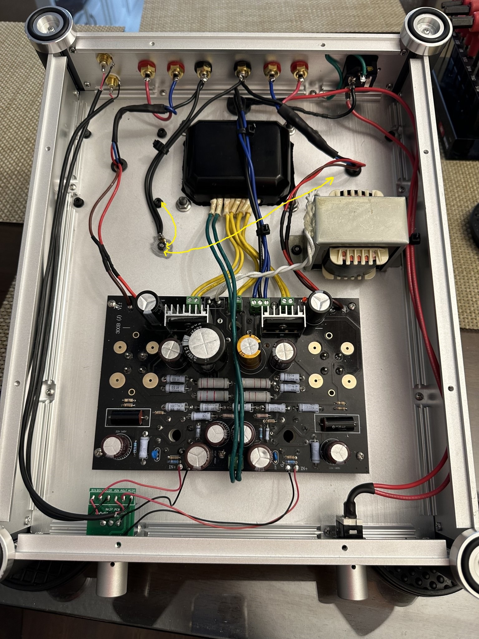

Can the covers of the OPT's be shielded by electrically grounding to chassis? Maybe they already are- Might check for continuity.
They are very close to PT and could be picking up noise from PT. Overall construction looks very nice for hobbyist builder, tho.

Hi Jim, yeah the chassis came with the holes vertically. I wanted to space the transformers initialy. I dont know what you mean by electrically grounding the chassis. I did ground the ctr tap of the transformer but it seem to give me more noise. the schematic for this board is kinda crappy and my knowledge for electronics isnt great either. I am just wondering were it gets its ground from?.......Frank
OPT shells look like crinkle coat over aluminum in detail pic. Assembly pic looks like they are secured by black anodized allen head set screws.
Might run wires soldered onto one allen set screw of each cover to gnd lug (pic). Have to file off anodize coating to solder. That should ensure shielding for opts, as long as allen screws engage metal cover(s)

Why not twisting all AC wires as you did with the choke? Does the green wires 6.3Vac? If there is hum, you may want to add 2 x 100r resistor to each leg if green wire then connect both resistors to the GND.
