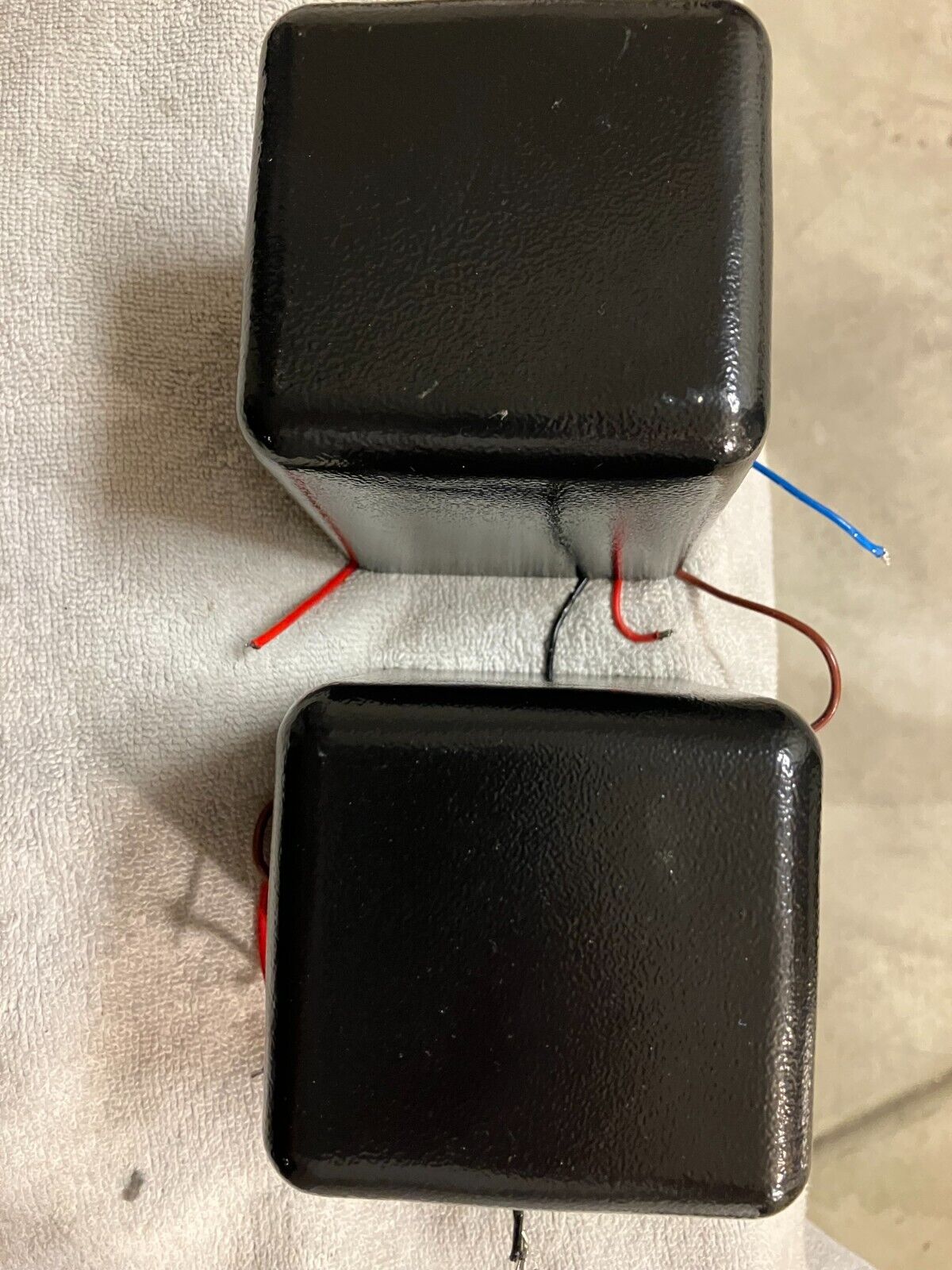

ok, really appreciate all the info. I just purchased a pair of transformers from a boyuurange 50 for 120.00.....I guess i can also try the 125cse. I am just starting to get in to the tube stuff. Is there anything wrong with the circuit posted? Would i be better off with a point to point? is the B+ to low in this design.

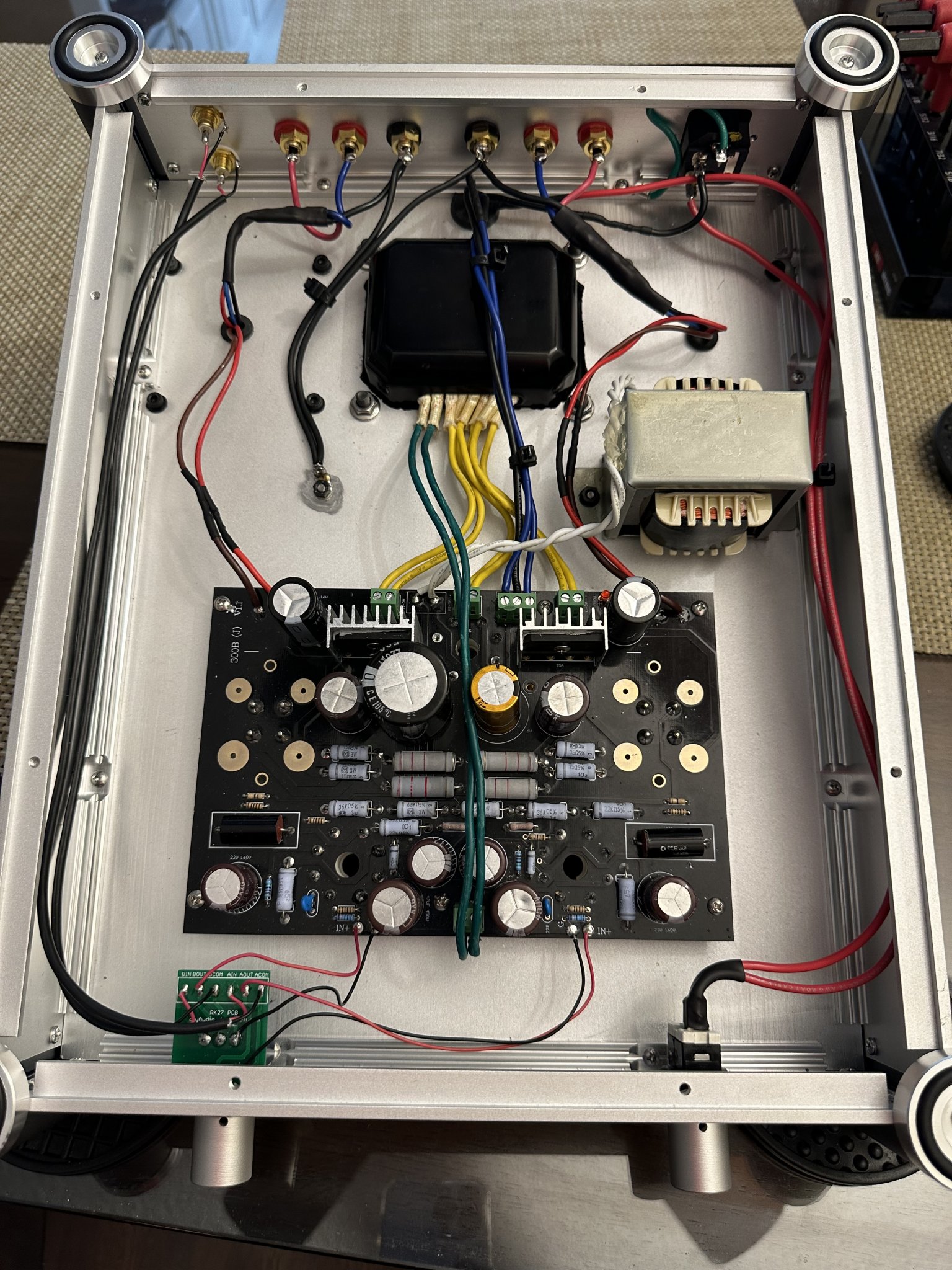

That schematic does not match the photo of the assembled board. The schematic shows a pentode in the second tube position, strapped as a triode. The photo of the board looks like two 6SN7, two 300B, one rectifier. I suspect the topology it is 6SN7, 6SN7, 300B.
This board looks very similar to this board: 300B Board where the schematic showed two capacitively coupled stages but is in reality direct coupled and high distortion beyond low levels.

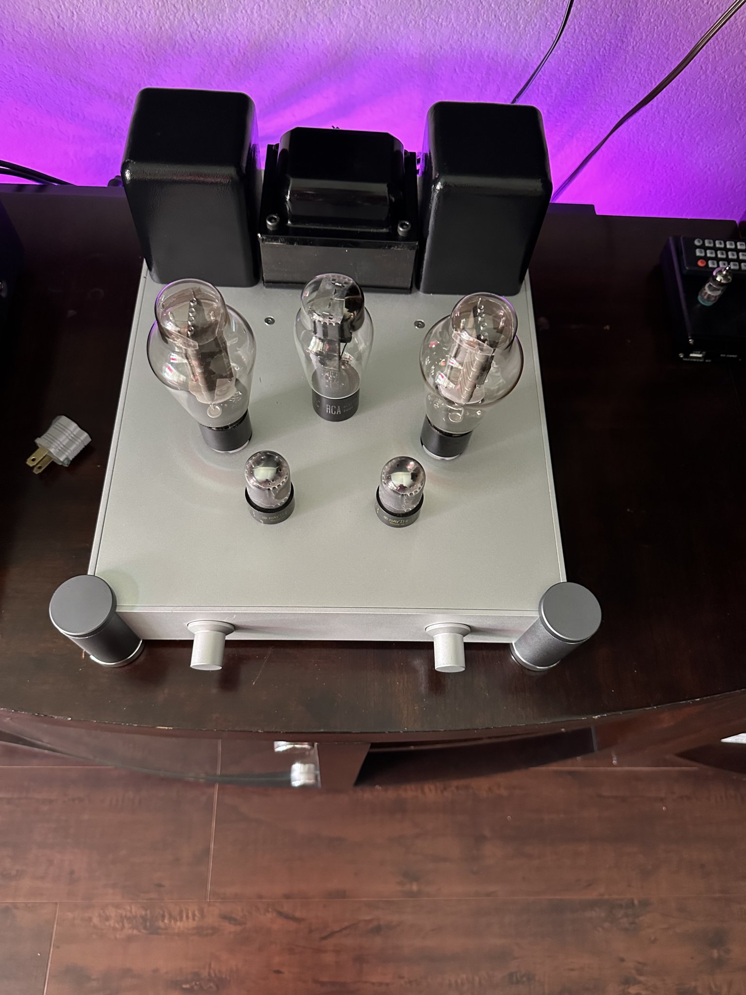

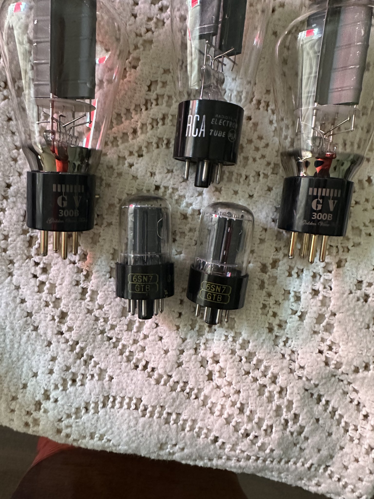

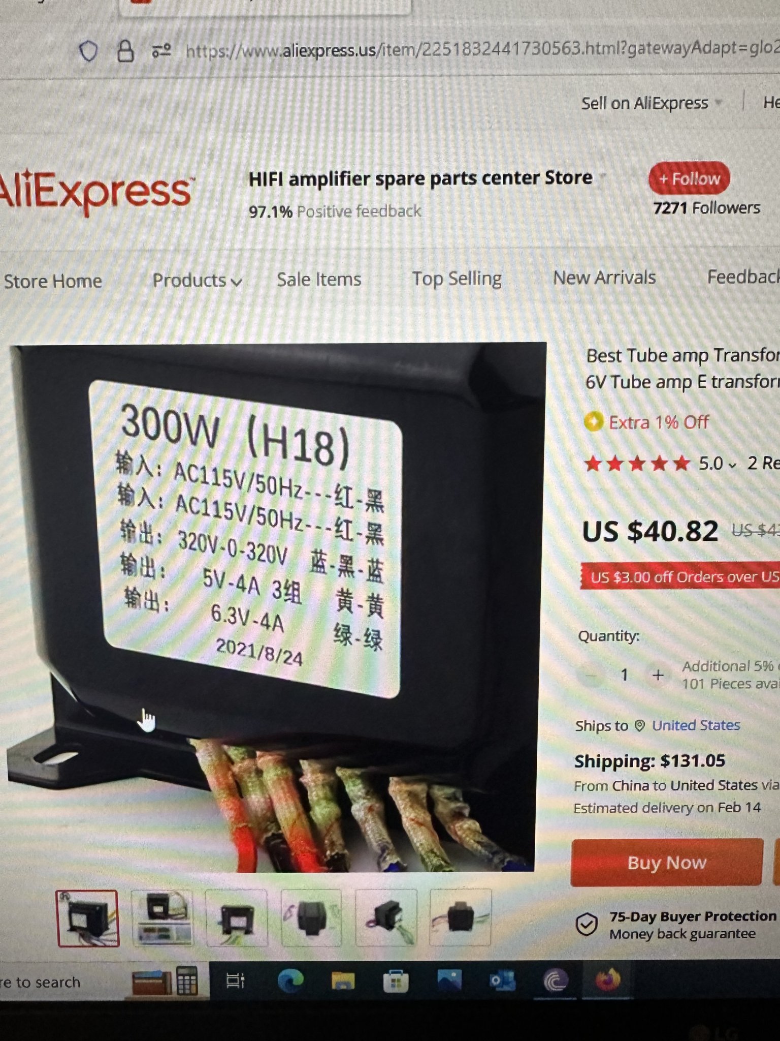

Hi to all, wanted to post my build on this eBay diy board. I am not an engineer or electric tech, just someone who decides to do random stuff sometimes . I basically build by the pictures. The power transformer has 320 0 320 and 3 sets of 5volts ..those are the yellow wires feeding the x2 300b and the rectifier tubes..the green wires are the 6.3v for the 6sn7 heaters..I believe those are parallel and i think the 2 300b heaters are dc ,,not sure?.....I did not try to modify anything because i do not know how so i just stuck to what ever came in the kit. When i turned the amplifier on for the first time i heard noise in on of the channels ..so i decided to swap my 6sn7 tube from left to right and the sound traveled with the tube...so i think one pre tube is bad.....my concern at this point is the hum from the transformer.I can put my ear to it and it seems to sing all by itself.....................please, I would appreciate any help with this also not sure if my connections in the amplifier are right

That transformer looks like same one many vendors are selling on ebay:
https://www.ebay.com/itm/194930983639?
Not sure if you are in US? I'd suggest replacing the transformer first with this item. The vendor says will accept returns, if the problem is not solved.
If looking for different alternative-
I've had some good & some not so good results with Chinese sources. You can search my threads for problems I've had in the past.
Had good results with this vendor:
https://hifi-exquis.aliexpress.com/store/1100800846?
You can message them specs of your transformer, and see if they can provide better quality design.
