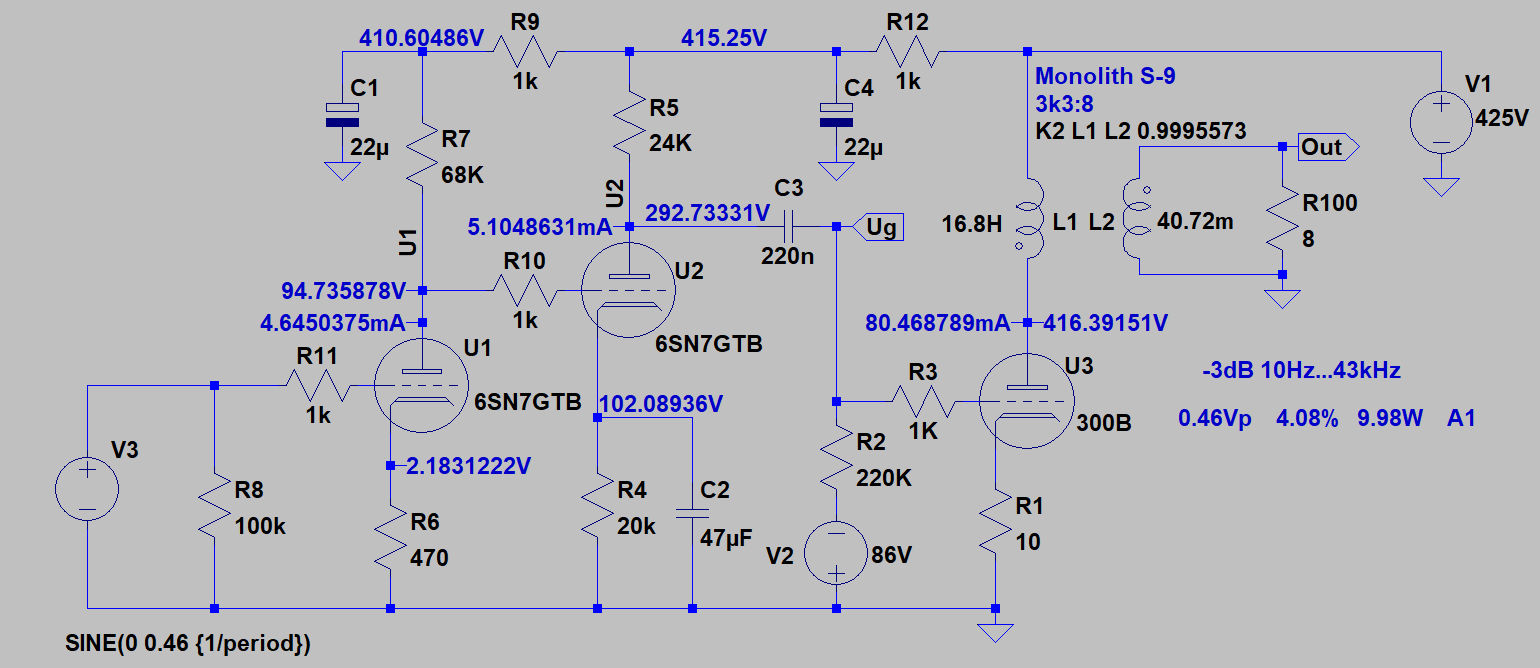

6J5 to 6AH4 will give you 120-160x amplification, which is too much. Same with the 6EM7.
30-60x is desirable, depending on how much swing you need for the given circuit. Even needing +/-100V peak, I would want more than 60x amplification factor.

6J5 without cathode resistor bypass capacitor and resistively loaded 6AH4 will give gain no more than some 70...perfect!
6EM7 with current source anode load for first triode and current sink cathode load for second triode as cathode follower...gain of some 50 and perfect for fixed bias A2.

I'd just put a high GM triode in front of the 300B and call it done.
In attach a simply but interesting circuit I test in the past.
In fig.1 the frequency response of the input circuit.
20 vout - 450 mV in, gain is 44.
In fig.11 the response at 8 watt out.
