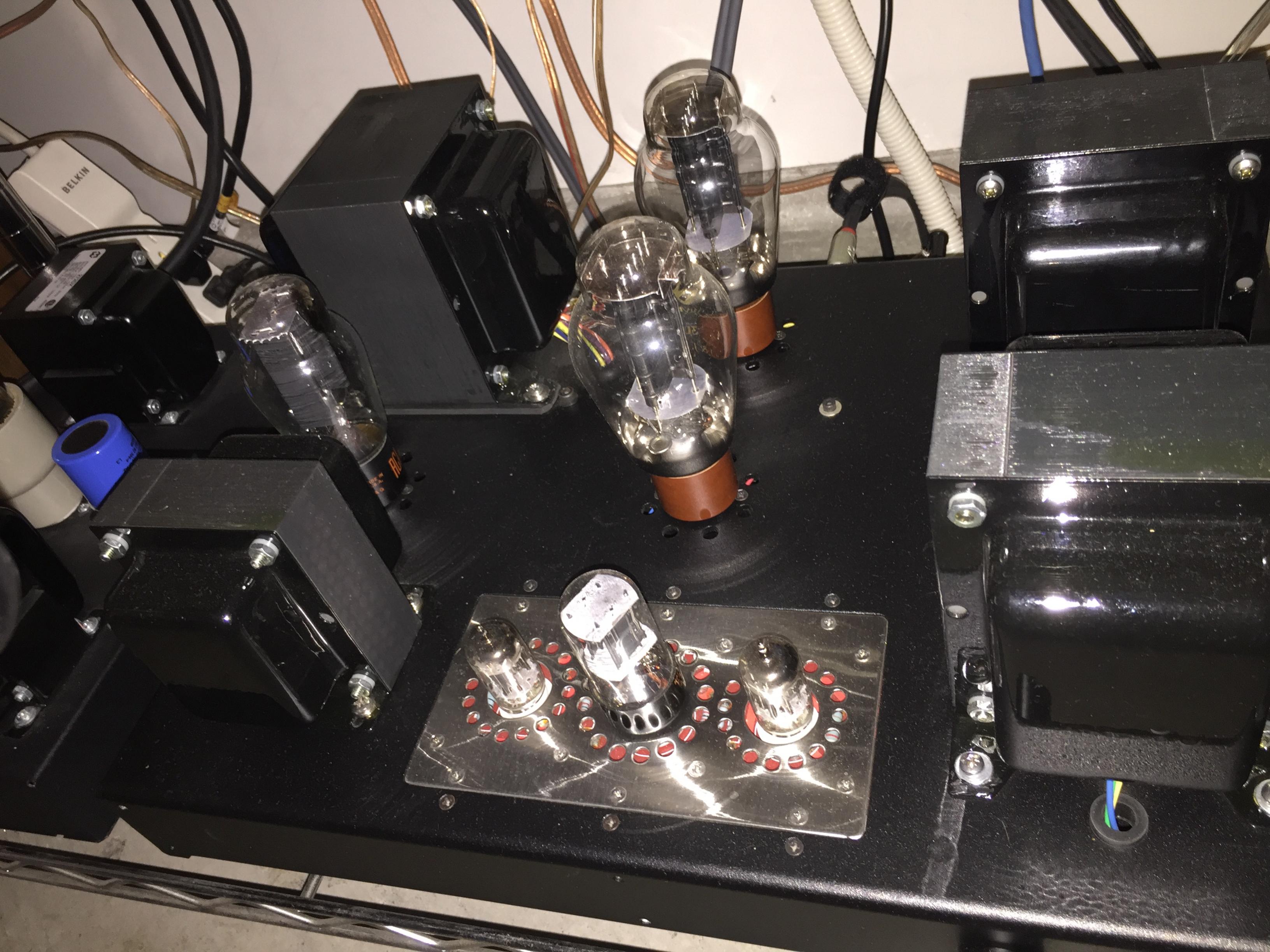

I built a AN 300B Kit 1 a few years ago. It's used to bi-amp the top end of a pair of JBL speakers. It sounds great to me. I sold all my other speakers and settled on these for my main system, only because they sound great at the volume and music genre in the room I use them in.
As far as your design- go for it. Approved by one mechanical engineer to another.
