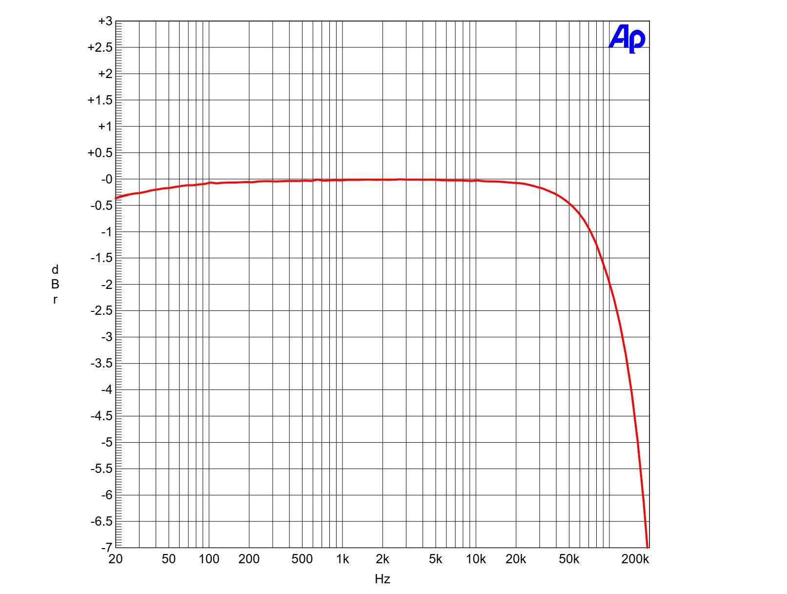

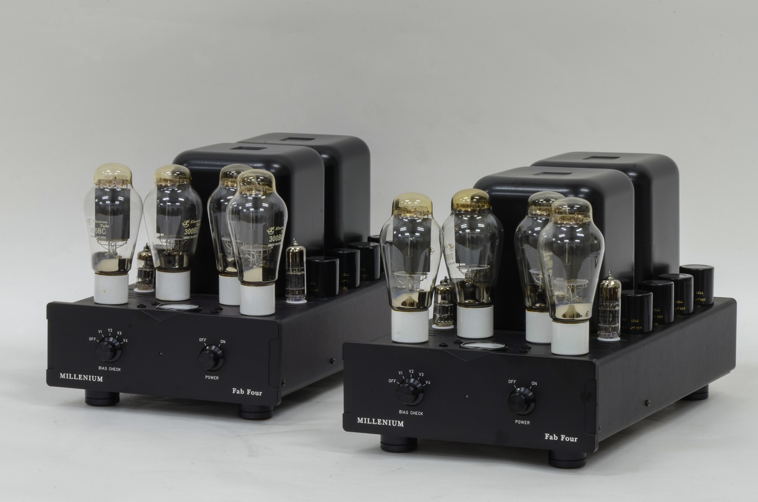

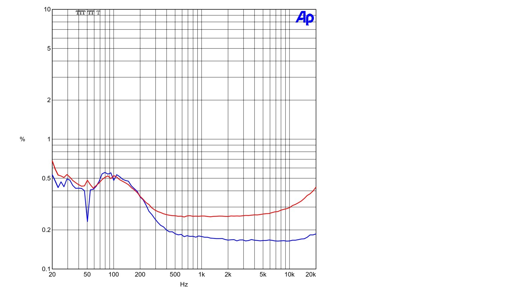

An old stuff
p-p, around 20 watt but a strong power supply and good OT
The graph is 1 watt , no FB
The THD_vs_Freq at 1 watt and 10 watt ( red line), with around 6 dB of FB
The most important thing is the quality of OT and not the positive grid
Walter

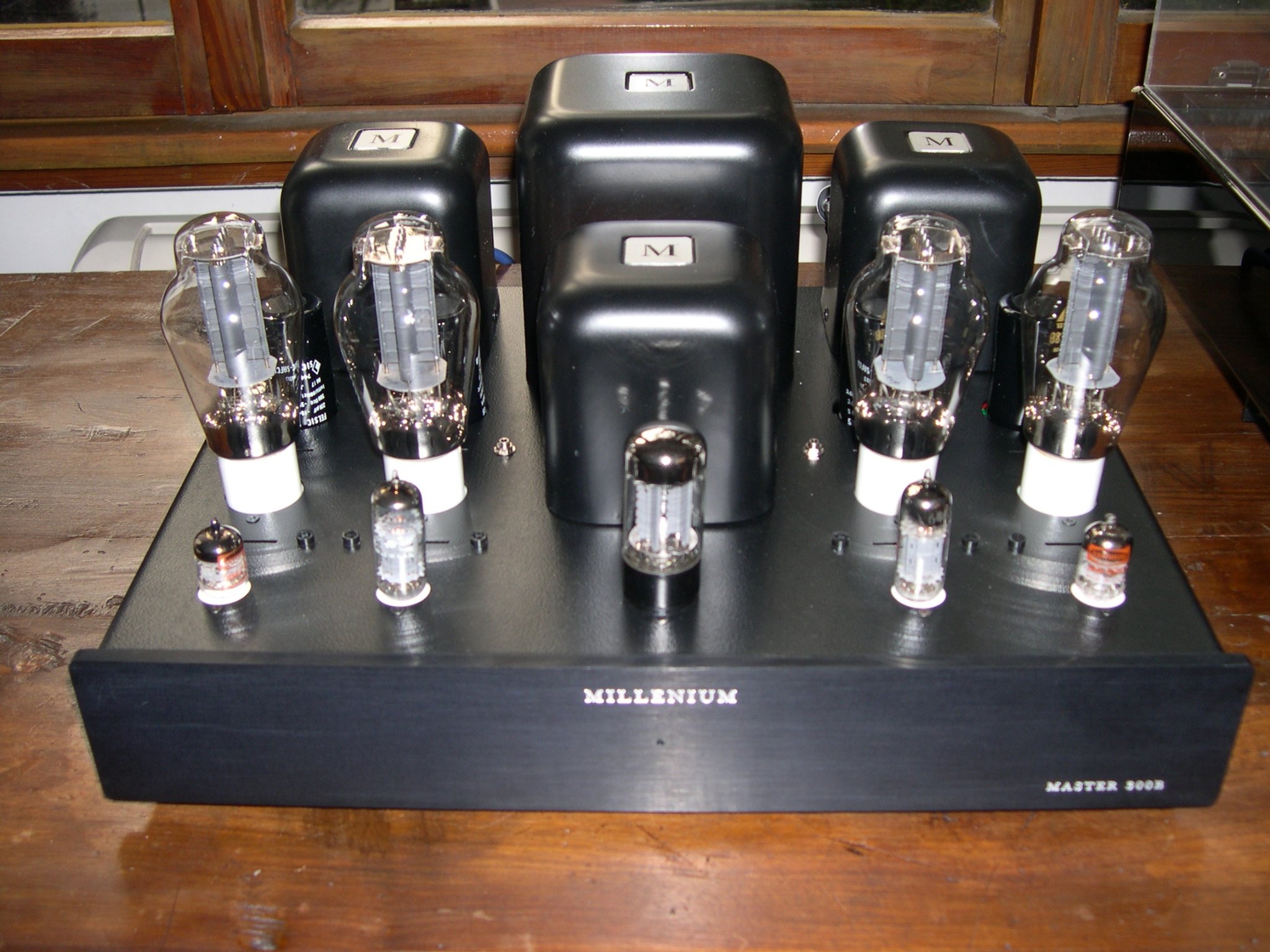

Hi, you can try to drive your 300B PP with cathode follower.
Check this thread:
Nice 300B PP Walter! Yes, might be not easy, but why not to have a try if not experienced yet

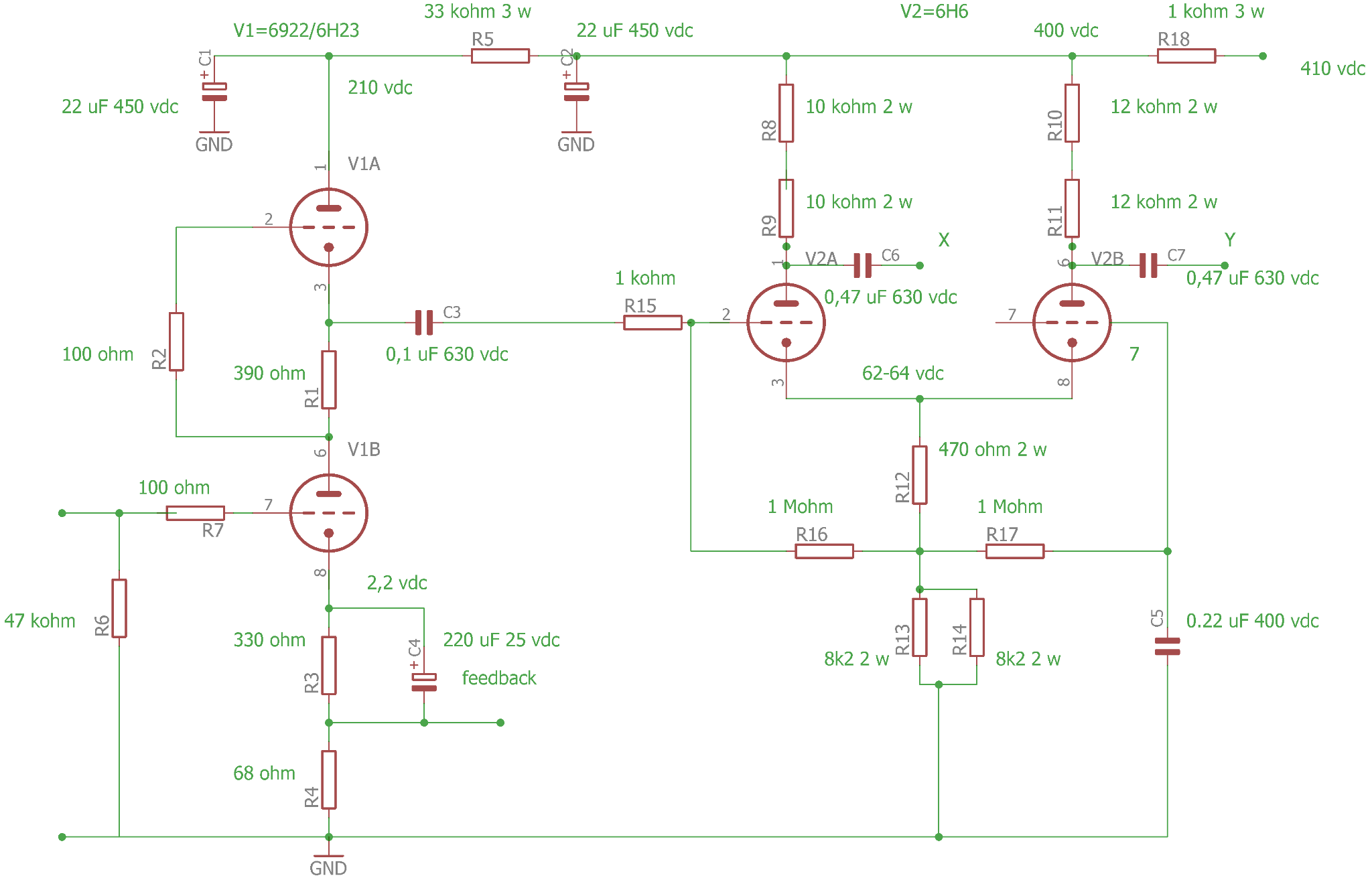

Hi
in my opinion instead to play with A2 condition is much better to work on drive stage that must be linear as the 300B is, but is not simply.
I think that 6H30 soviet is the best candidate to drive the grid of 300B until 0 volt.
It is very linear but is not so simple to set as phase splitter.
Then the input can be a ECC88 that is also linear .
In attach the schematic of the amp I done.
The output stage is fixed bias, around 400 Vdc with 50 mA of bias
The OT is double C, ratio 27:1 with only one secondary fixed at 5 ohm
This diagram is also very good for the other amp in the photo; it works great
Walter
