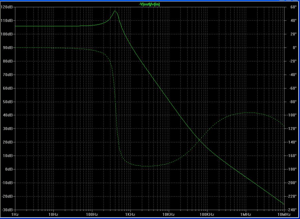

No surprise that it is oscillating – the frequency compensation is waaaayyyyyy off. Firstly, that 330R/15pF (R15/C11) is a BAD idea – it is causing your loop gain roll-off to plateau above unity gain.
With R15 and C11 removed things are much improved, but the unity loop gain frequency is still way too high at almost 2MHz. The problem here is that your emitter degeneration on the LTP is too light.
Delete both R15 and C11 and increase R1 and R2 from 30 ohms to 150 ohms. That should give you a stable amp.
Also, 10 ohms is a little small for the degeneration on the current mirror – 100R would be better.

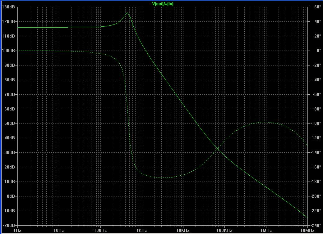

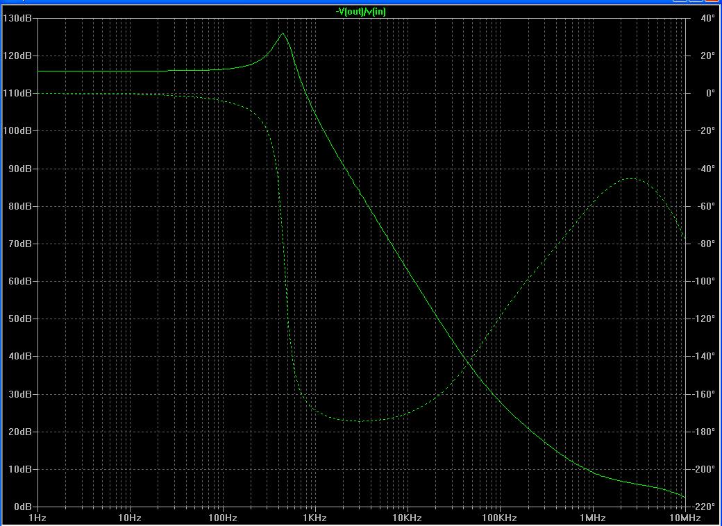

Attached are the loop gain sims for an ideal front-end starting with your circuit values - the first plot. As you can see, the loop gain does not go through unity until after 10MHz! The plateu in the plot above ~1MHz is caused by that R15/C11 combination - this will never be stable.
The second plot is with R15/C11 removed. Now things look good, but the unity loop gain frequency is still way too high for a bipolar output stage, at 2MHz.
The 3rd plot is with both R15/C11 removed and the emitter degeneration increaded to 150 ohms -that would be comfortably stable.

Anyway, the 10MHz oscillation with the fixed loop compensation is definitely parasitic oscillation in the output stage.
