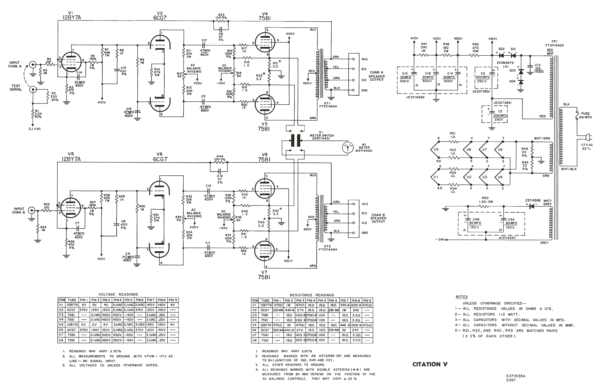

That 87 dB. speaker sensitivity is, unfortunately, a show stopper. Something like 94 dB. sensitive is what the 8 or so WPC you get from SE 300Bs should be mated to.
The bad news may not be (sorry) over. What Sony claims for the SS-CS5 speakers may require derating, depending on what the impedance curve looks like and how the 87 dB. sensitive number was established. For instance, 2.83 V. into 6 Ω is 1.33 W., not 1 W. and the "real" sensitivity is lower than 87 dB. Substantial dips in the impedance curve, particularly the power hungry bass region, lower the impedance from its nominal value. Once again, sensitivity derating is necessary.
The fact that your listening space's volume is small is a plus in the power needed equation. I strongly suggest you wade through this lengthy thread, where the OP finally settled on "cloning" the H/K Cit. 5. The "five" is a superior implementation of Mullard style topology that will drive your Sony speakers well. Give the speakers' 53 Hz. LF limit, bandwidth limiting the amp to say above 35 Hz. would make yet more power available for actually filling the listening space. GKF is Canadian and he opted to use Hammond O/P "iron". As you are in the U.S., Edcor's CXPP60-MS-6.6K on the 4 Ω tap is what I'd use. If you are considering different speakers, with better bass extension, you very well could need more capable "iron" to provide the magnetic headroom GNFB demands.

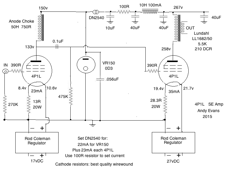

I'm going to give you a different take on this. I'm another musician - play upright bass, mostly jazz but also acoustic music. I've always built amps for listening to music with two priorities - transparency and accurate timbre on acoustic instruments. I've built countless amps in my search for this - started with PP EL84 designs, then a ST70 and some DHT PP amps, then into SE with 300B and 2a3. I thought that was the end of the road, but it wasn't. I started to get better results using 4P1L tubes. Yep - those cheap Russian military tubes are little miracles.
First used them as drivers, and they were great. Then on a whim used a pair in PSE as outputs. Whoa! Great sound and a gain of 10! So I could build 2-stage amps which were 4P1L into 4P1L and that gave me enough volume for a small/medium room with 2v input from a DAC. In fact, with my full-range Alpair 10 speakers I'm now listening with just a single 4P1L in the output. I couldn't be happier - best sound I've ever had. All the transparency and timbre are there.
A 2-stage 4P1L amp is a very simple circuit, but it's quite a complex build since the amp uses filament bias, and the DC filament supplies must be uber-clean. Rod Coleman filement regs are mandatory (see Lyrima website) and you need 4 separate filament supplies, preferably choke input. If you are up to that you'll get something special. All the build instructions are on two DIY Audio threads, one for "4P1L DHT line stage" and the other for "One more 4P1L SE". Here's my latest circuit. Note that my speakers are around 88-89db sensitive, so in your ballpark.
You can use a Hammond 126B just as the plate choke for the first stage - works very well. The LL1663 would be a good OPT. You can get them in the USA from K&K. I use a LL1682 but just because I had a pair. If a single 4P1L isn't enough for you, you can double up and use 2 in the output. That is the equivalent of a 2a3. 4P1L tubes are cheap, and will save you a lot of money and grief over the likes of 300b. I bought 150! Don't need any other DHTs. Have a look at Ale Moglia's site to find out more about using the 4P1L. In an amp you'd use either a plate choke or an interstage e.g. LL1660 in 1:1. I've used both, and I'm pretty happy with a 126B.
