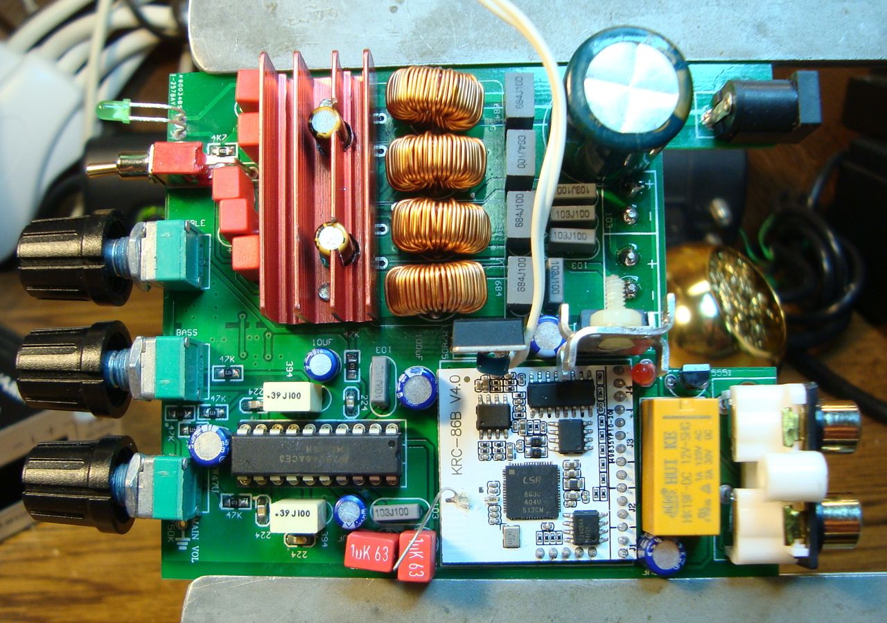

In short: Consider staying away from these TPA3116 LM1036 KRC-86b Bluetooth 4.0 CSR8630 all-in-one type boards unless you really only want an OK amp board w/tone controls. And somewhat noisy, lower-fidelity Bluetooth capabilities.
You may wind up wondering what your time is worth & wishing you bought separate, better implementations of the features:)

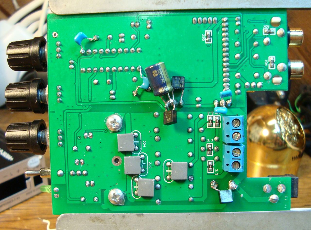

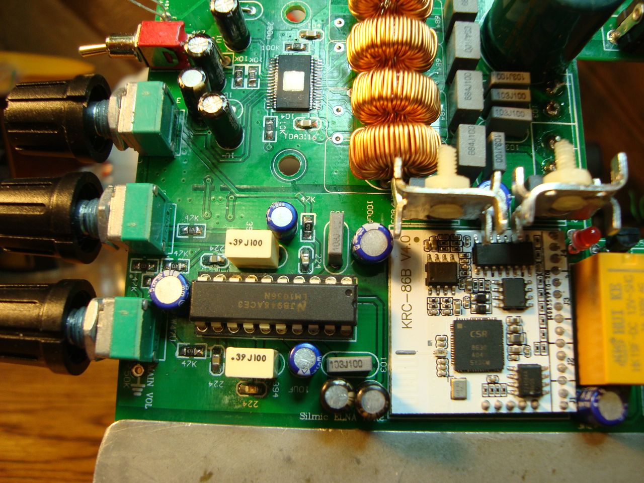

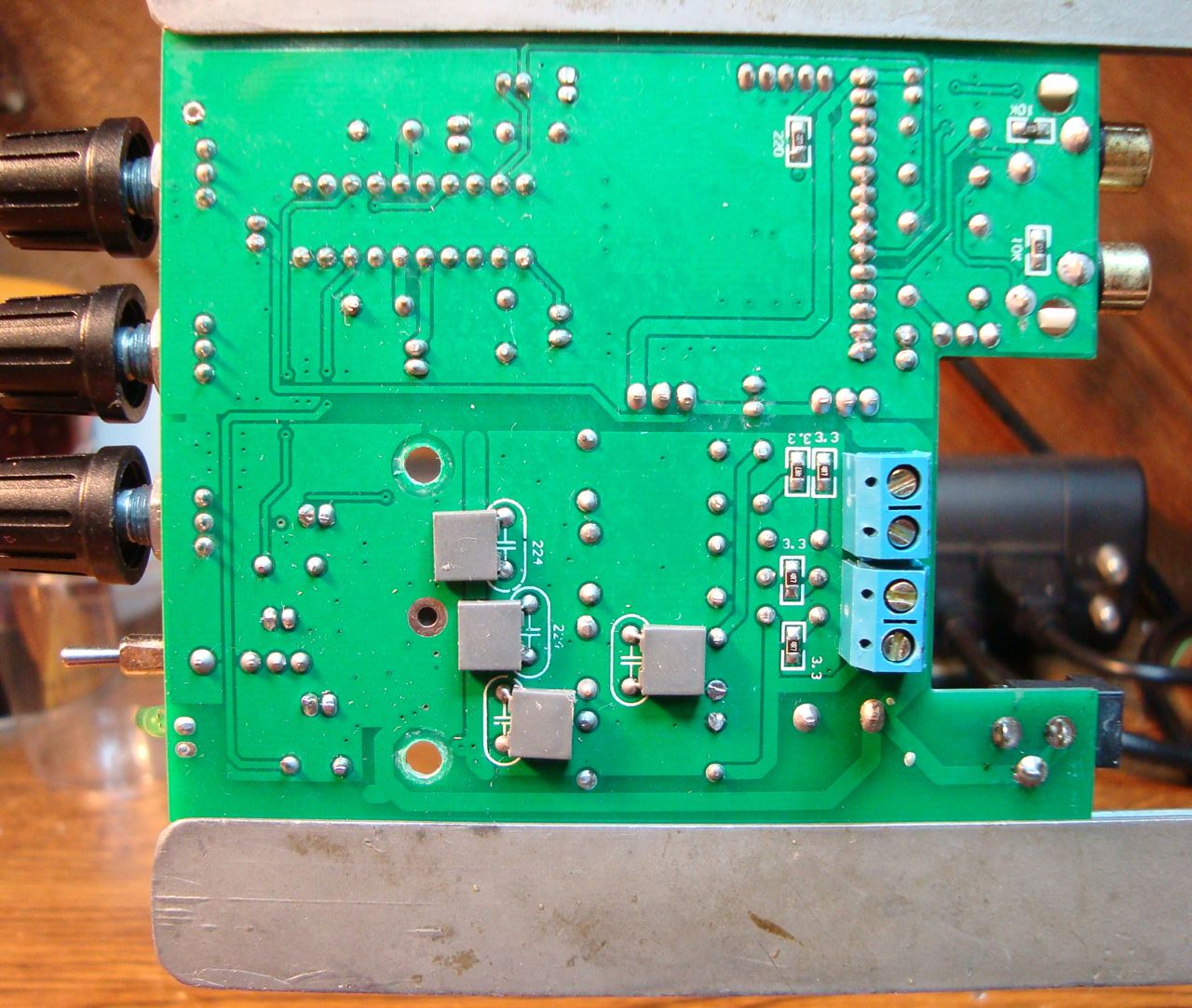

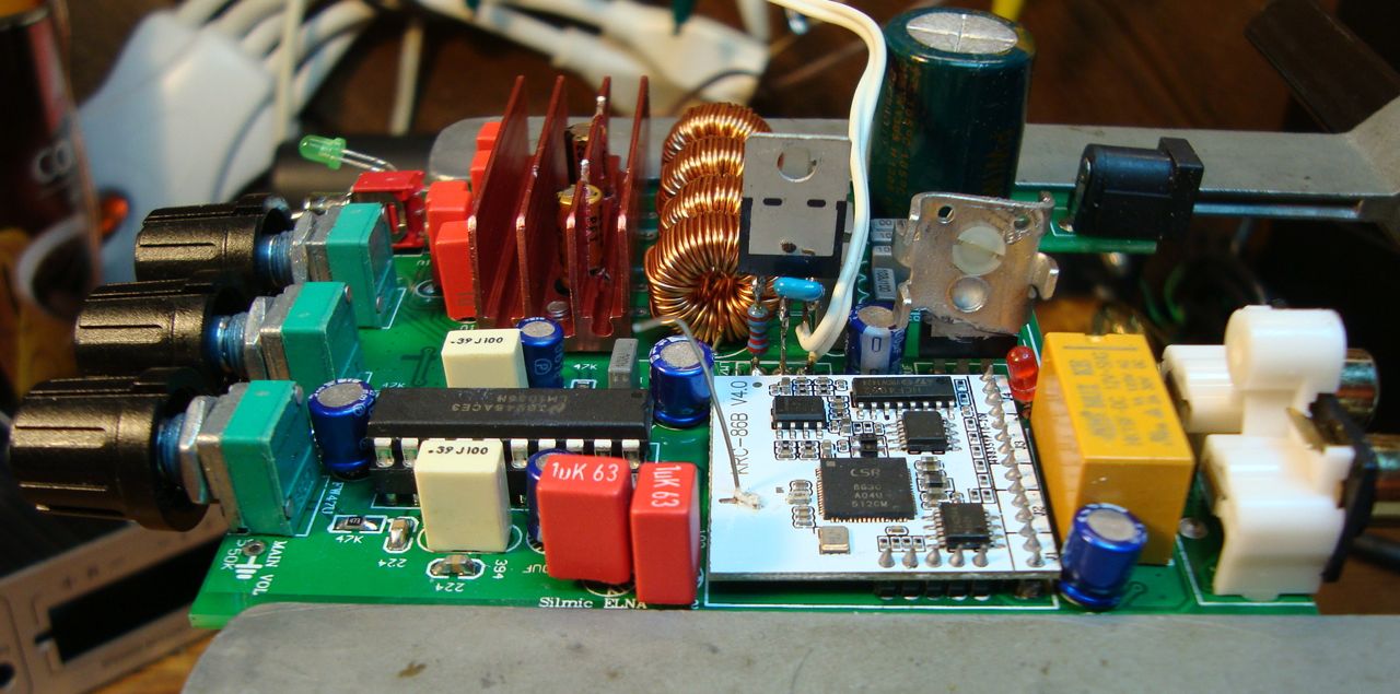

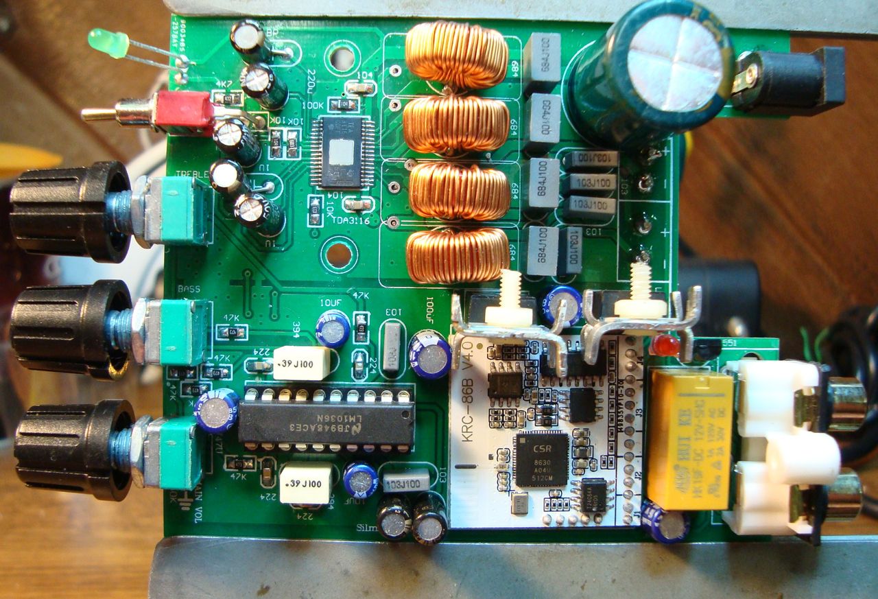

In long: I'd gotten in my head I wanted to DIY a Li-ion Bluetooth "Boombox" with larger bass driver than many/most commercial offerings. Something approaching Marshall's nice units with their single "large" / 5 1/2" (?) bass driver + separate tweets. Since separation didn't matter much here, I picked up a 6 1/2" single point stereo driver. More about that in another thread.
To the point, WRT this/these cheap boards pluses & minuses:
+ they function
- they appear to be designed like this: Start with something like a reference implementation then subtract as many parts as possible such that it still "works". Use cheapest parts available / on hand at the moment.
- switch is a mute switch, it does not power off any of the circuits.
- autoselects Bluetooth input if paired device is in range (I hacked a "fix" for this)
- digital hash / noise in Bluetooth feeds (my changes help some). Much(?) lower fidelity for Bluetooth feed, though some of that is probably inherent in the protocol.
- short Bluetooth range, fixed w/32mm wire antenna trick
- much more
Anyway, having bought it, reviewed the parts & implementation vs spec saw lots of deviations. Absent parts, wrong value/type of part, silly mismatched parts (e.g. interstage coupling: 1uf for Right, 2.2uf for Left), etc. Made a list of minimum changes, see before & after pics.
First 3 photos are before mods, last 3 after mods.

> I like the caps within the heatsink.
Thanks. That was tricky. The local PVCC decoupling electrolytics called for in the "typical application" were absent.
> What problems with "fidelity" occur with this BT-module? Noise/Hiss only?
No. Besides background digital / BT comm noise & elevated hiss found BT frequency response a bit limited compared to same device fed through the RCAs. Playback through BT was less crisp. Will probably use RCAs whenever possible.
BTW think the BT noise problems may be due to proximity of components / ground pollution / no isolation between BT, tone & amp stages.

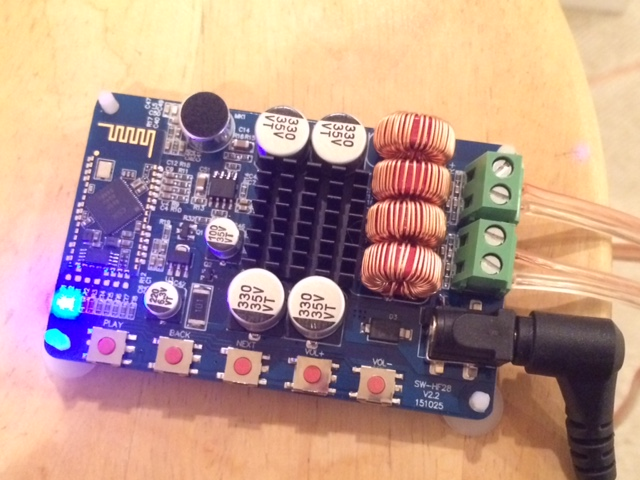

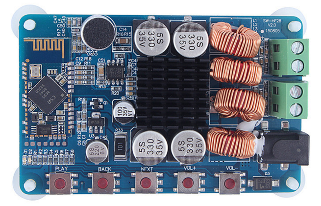

I just ordered one of these Sanwu with BT 4.0 and built in mic and volume/start/stop/next track buttons. I have good experience with Sanwu Blue PBTL 3118 board so expect this one to be pretty decent sounding. Only $13.
Wireless Digital Bluetooth 4.0 TPA3116 50W+50W Audio Receiver Amplifier Board With Mic Free Shipping-in Amplifier from Consumer Electronics on Aliexpress.com | Alibaba Group
526192d1453259617-30-tpa3116-bluetooth-speaker-protection-eq-any-good-sanwu-bt-3116.png
Does not appear to have a line input though, and no speaker protection relay, but my experience with Sanwu boards is they take care of the thump via logic on the amp.

WRT to pop w/pwr on - Resign yourself to powering on & off as two-switch actions, using existing mute switch in conjunction w/power switch. I don't plan to try to solve that, I'll have 3 switches on my build: main power, existing mute switch & BT power on/off (make/break switch for its LM7805 input leg - you could accomplish same in easier ways but I care about draw as this will in a battery powered rig).
WRT BT noise - Convinced noise is ground contamination and/or proximity of BT module to LM1036/tone circuit. None of my mods, including a bent up grounded steel shield, did much if anything to reduce BT noise. Resigning myself to using RCA whenever possible & put up with BT noise when necessary, at least its only noticeable in the quietest music passages.
General sound quality wise, I'd say most improvement of my mods came from replacing the various 1uf/2.2uf electrolytic coupling cans with WIMA MKS02 1uF 50V 2.5mm pitch films (the red-orange boxes). Note the somewhat low PCB quality makes re-work harder than most, take care WRT trace & pad lifting.
Again think going [proven] separates is a better route, incorporating PS isolation & some distance between modules. Or only purchasing stuff used/reviewed/recommended by reliable sources.

This amp just arrived - hooked it up to speakers and 12v smps. Very simple to connect to iPhone (Sanwu Bluetooth is name of device). Sounds excellent - no BT radio noise or buzzing at all. Great workmanship - clean solder joints and nice components. No turn on thump.
Highly recommended. No line in via wires though. Works as speakerphone too.
