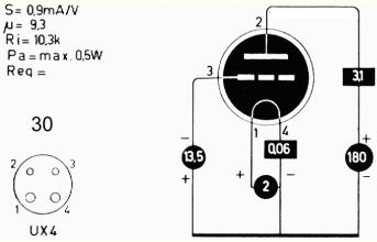

It is a direct heated battery tube with 2Vdc 60mA filament. You can run one from a 2V lead cell for instance. Or build a CCS with high impedance @60mA per valve. Or buy some commercial boards. Standing current is just 3mA so do not expect much drive from this type without a buffer.

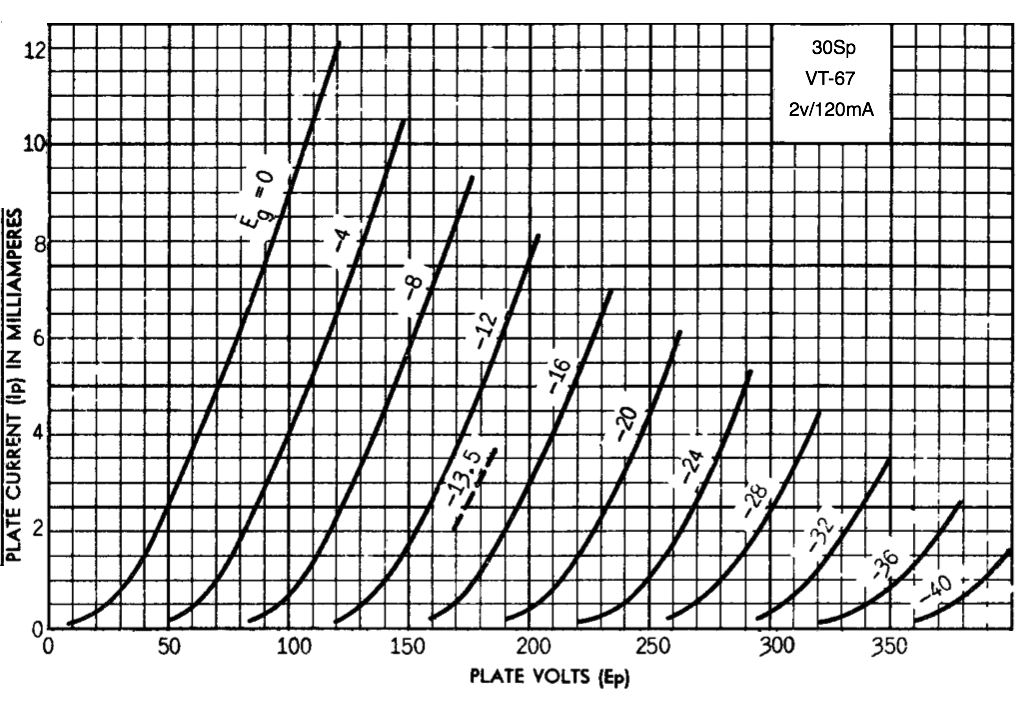

I've used both 30 and 30sp in preamps. Sound is similar - the 30sp maybe a little beefier sounding. It's quite a neutral DHT, something like a 2P29L. Not warm like a 26 and not sparkling like a 01A. I thought the high frequency response was a bit flat sounding, coming from the 01A. But it's an "average to good" DHT.
The big difference is microphonics. The 30 definitely needs some sort of treatment to avoid microphonics, either airborne or chassis induced. The 30sp is much better in this regard and I didn't have much trouble with it.
Digging up my old data, it seems I was using it in filament bias, which would be a good way to do it. I used Rod Coleman filament regs. I also used a plate choke. I believe the data for 30 and 30sp are the same - couldn't find anything on VT-67 in Franks. Curves here.

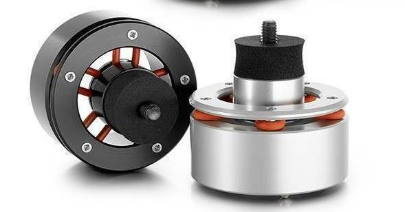

The SE stage + 6SN7 follower is a very good idea. That's pretty straightforward.
As others already suggested, the most important things with battery tube are DC filament supply and isolation from vibrations.
Vibration isolation is less trivial than just damping with rings and solves the problem while damping doesn't....
The simplest isolation down to subsonic range around 5-10 Hz is something like the turntable feet in the picture below. The orange elastic wire is the only way the tube is mechanically connected to the chassis. The tube socket would be in the middle with a something heavy (lead block glued with epoxy for example) attached below to create the right load for the elastic such that the self-resonance is shifted as low as possible. Usually 4-5 Hz is possible without many problems.
Of course this simple system cannot compete with more refined solutions like air-springs and will have some damping (i.e. more than necessary) but the principle stands.
The principle is that true isolation does not allow vibrations to take place by dissipating the energy with imperceptible (moderately damped) oscillation at the self-resonance of the system under consideration (in this case the tube with its load below). At higher frequency it will behave like a 2nd order filter. With the simple system described at 20Hz attenuation can already be in 20 dB range (air-springs can get to 30+ dB) and continue to increase by 12 dB each time frequency doubles. Considering that self resonances of tubes are typically well above 100 Hz this simple system will be quite effective.
By definition damping is NOT isolation because damping happens when vibrations have already taken place and "damaged" the music signal.....
With true isolation tubes like 30 are in another league thanks to their very good linearity.
